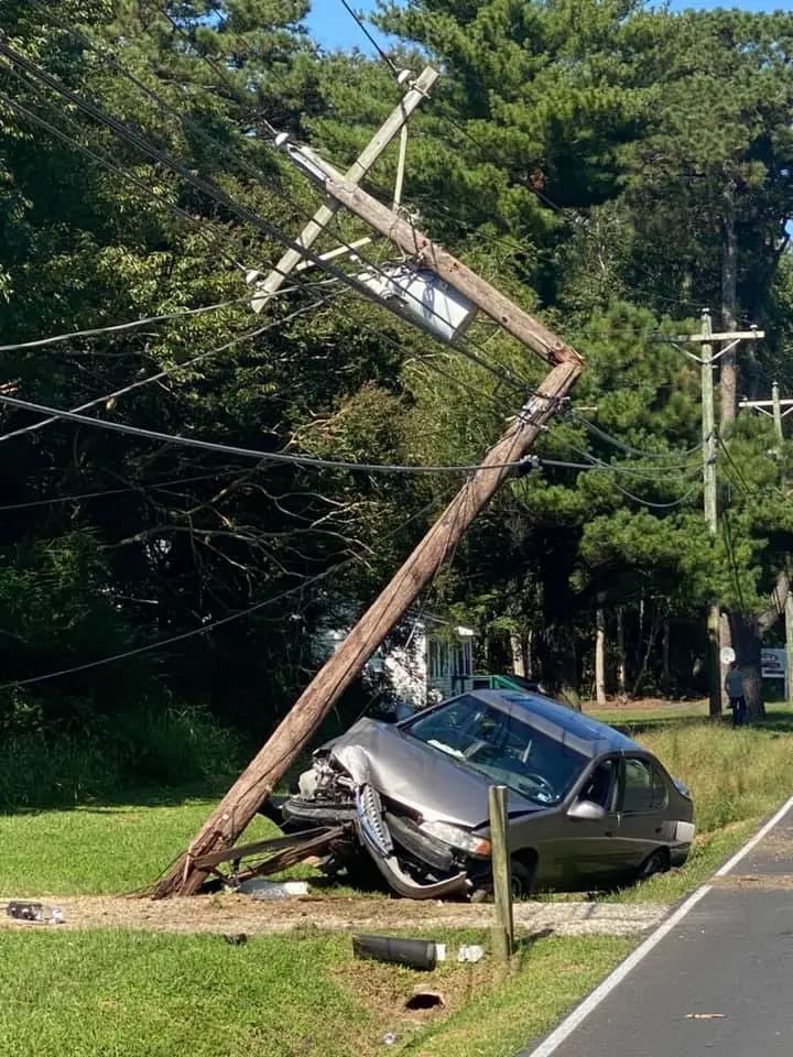

1. Vehicles Hitting Poles
When a vehicle hits a pole, a power failure may occur due to the conductors clashing or shorting to earth. At times, the feeder successfully recloses. Damage to utility poles can disrupt the electrical grid they serve. Outages may occur unexpectedly due to disconnections or short circuits in power lines. The extent of these disruptions is determined by the location of the pole within the network.
The speed and weight of the vehicle, the angle of impact, and the pole’s composition are some of the factors that determine the outcome of a collision. Under tremendous pressure, wooden poles might split or crack, resulting in their accidental breakage upon collision.
Damage from downed lines and other debris can make repairs more difficult and pose a greater threat to public safety if a failure occurs suddenly.
When it comes to impact forces, modern ductile iron poles operate differently. The pole can absorb energy and bend because to the special qualities of ductile iron. Minimizing debris and strain on connecting wires and neighboring structures is achieved through a controlled response from the pole.
There is an immediate threat to public safety from a downed electric pole. There is a significant danger of electrocution when live electrical lines fall onto the road, cars, or neighboring buildings. If a wire touches anything, it can activate it, making anything from fences and guardrails to puddles a possible electrical conductor. Also, dry plants or combustible objects might be ignited by sparks from broken electrical equipment.
There is a secondary collision risk due to the potential scattering of pole and vehicle debris across the road. As roads close to the scene of the accident work to secure the area, traffic congestion is a common consequence.
Emergency medical personnel responding to the site must proceed with utmost caution in order to prevent electrical dangers that could postpone the delivery of life-saving treatment to those who are hurt.

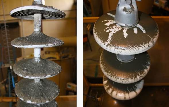

3. Pollution Failures
The pollution from industrial areas and exposed coastal areas may result in flashovers, pole top fires or radio interference. In the matter of fact, pollution is typically generated by accumulated soot or cement dust in industrial regions, and by salt deposited by wind-driven sea spray in coastal zones.
A significant level of pollution on an insulator string weakens the insulation strength of the impacted phase but is not considered a fault until it induces a flashover across the string, eventually leading to excessive current or other obvious anomalies, such as abnormal current in an arc-suppression coil.

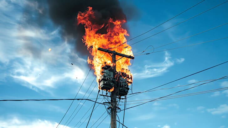

4. Pole Top Fires
Pole top fires normally occur on those structures that have loose connections or are poorly bonded. Pollution, lightning damage and rain also contribute. Fires are more frequent with the first light rains following a long dry summer and also occur with high humidity at the end of summer.
The fires are caused by leakage from, or damage to, the insulator. As a result, the current may track down the insulator to earth, or flow between the conductors. The tracking current through the wooden pole and wooden crossarm will heat the wood and may eventually, set them on fire.

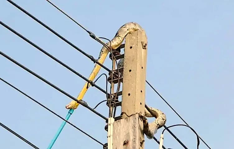

And where there are birds and eggs—there will be snakes. In fact, snakes are the second leading cause of animal-related outages in substations.
