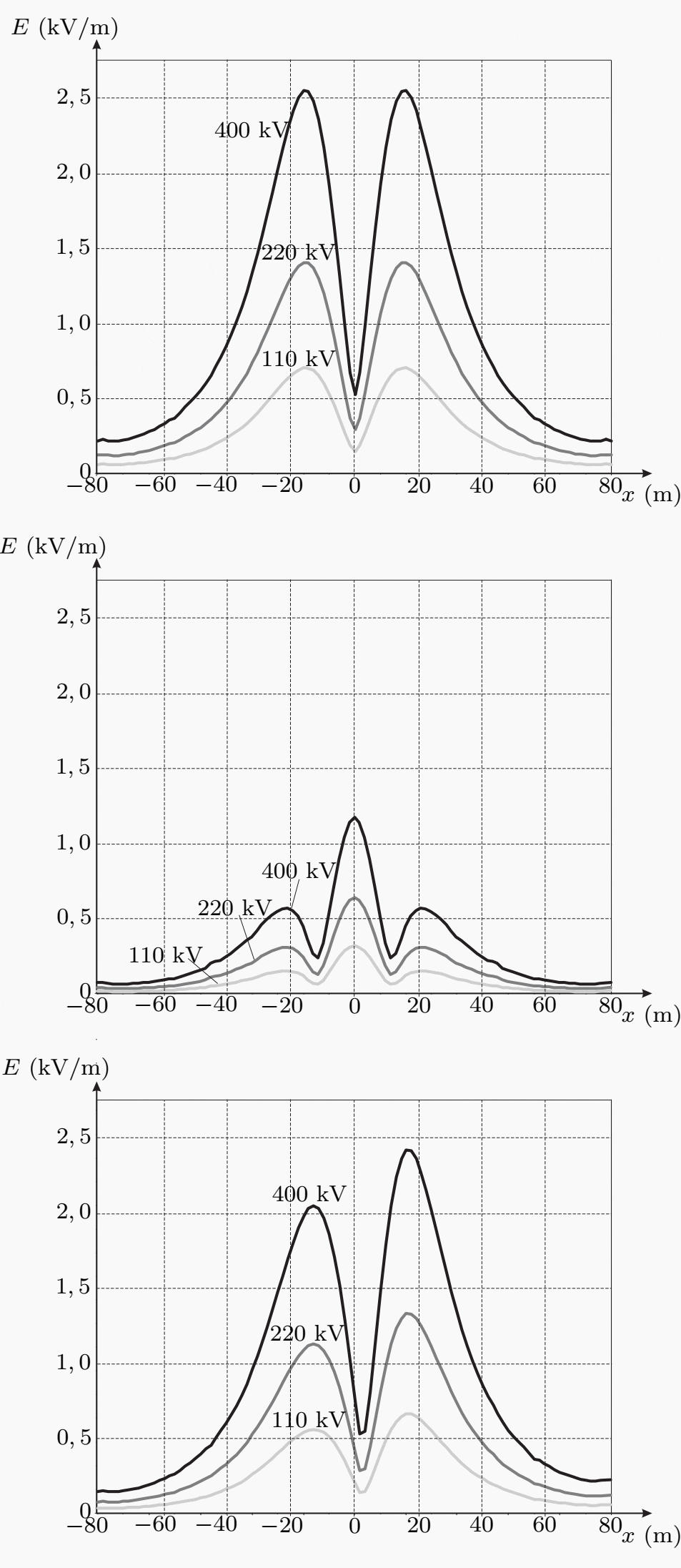

1. Electric Field
The electric field of a high voltage line depends on the voltage, the form of the tower and the configuration of the conductor lines. The analytic calculation of the electric field is very difficult because the earth impedance needs to be incorporated.
Hence, we abandon the derivation and present only the results of a simulation for the configuration given in Figure 1. In Figure 2 the behavior of the voltages of all three phases is shown. Regarding figure 1:
  • uR(t) corresponds to the voltage in the left conductor,
  • uS(t) to the one of the middle conductor and
  • uT(t) to the one in the right conductor.
In the following simulations three time instants t1, t2 and t3 are considered, as indicated in Figure 2.
Phase voltages in all three phases
Figure 2 – Phase voltages in all three phases
The resulting values of the electric fields are strongly dependent on the voltage. The electric field for phase to phase voltages of 110 kV, 220 kV and 400 kV (root mean square values) are considered. The electric field disappears exactly on the ground because the potential is zero there.
Related to the coordinate system in Figure 1, the values of the fields are shown in Figure 3 at a distance of 2 m above the ground, i.e. y = 2 m, up to 80 m in positive and negative x direction.
Only at time instants where the voltage of the middle conductor receives its maximal value or passes through zero, i.e when the voltage values of the left and right conductors are equal, a symmetric pattern is obtained.
At the same time, the field assumes on average the maximal value (t1) or the minimal value (t2) at these time instants. The time instant t3 is an example where the field is not symmetric.
Electric field at time instant t1 (top), t2 (middle) and t3 (bottom) 2 m above earth (conductor 20 m above earth)
Figure 3 – Electric field at time instant t1 (top), t2 (middle) and t3 (bottom) 2 m above earth (conductor 20 m above earth)
As a comparison, the natural static air field obtains a field strength of around 0.1 kV/m. In connection with a thunderstorm, values up to 20 kV/m are possible.
Also in a house we are constantly exposed to electric fields from different appliances. Within a distance of 30 cm field strengths up to 0.5 kV/m can be measured around electric devices.
The human skin serves as a safety shield and is sufficient for not enabling electric fields of transmission lines to enter. In buildings, the electric field coming from outside and varying with 50 Hz is reduced to at least one tenth.
The values of electric fields which are generated by high voltage lines at 2 m above ground (Figure 3) are thus not much stronger than those we are exposed to from other sources.

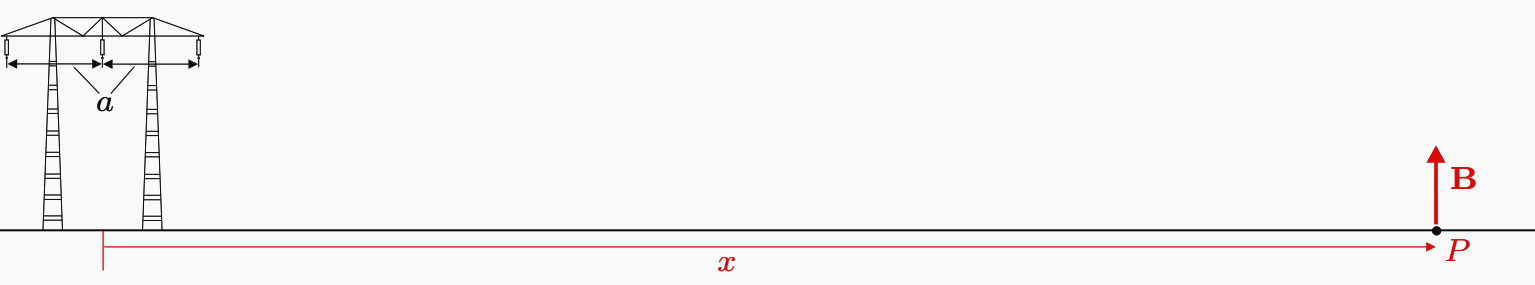

2. Magnetic Field
In contrast with the electric field the magnetic field can be computed analytically quite easily as the earth influences the magnetic field only insignificantly.
Using the law of Biot-Savart, a straight current-carrying conductor creates a magnetic field with the value (formula 1):
Magnetic field by Biot-Savart Law
Thereby R denotes the distance between the point at which the field is computed and the conductor, and the direction of the field is always tangential to the circles around the conductor.
This can now be applied for the calculation of the magnetic field for a three-phase line. For each conductor the value and the direction of the magnetic field is determined. Then, the three field vectors resulting of the three phases are summed up and the overall value of the field is computed.
As the field of a straight conductor only depends on the distance between the conductor and the point at which the field is computed (Formula 1), we can use a two-dimensional model to derive the formulas.
For a single conductor the relations are given in Figure 4.
Magnetic field of a straight line
Figure 4 – Magnetic field of a straight line
The value of the magnetic field at location (xB|h) results with (Formula 1) in:
Thereby we assume that I flows in the positive z direction, i.e. out from the paper. In opposite direction I becomes negative. In order to sum up the magnetic fields of all three phases, B is split into x and y coordinates:

The calculation of the magnetic field at large distances of the conductor can be simplified by some approximations.
As the direction of the magnetic field is always tangential to the circle around the conductor, we can conclude that the overall field is more or less perpendicular (normal) to earth at large distances (Figure 6).
Magnetic field at large distances
Figure 6 – Magnetic field at large distances
We assume that the distance between P and the conductor corresponds to the distance in x direction, for example the distance for the conductor on the left hand side amounts to x + a.
In phasor notation the magnetic field at P results in:
Magnetic field at P
With the approximation
Approximation
for small ε this results in:
approximation for small ε
From the condition that the sum of the currents is equal to zero at each time instant:
Sum of the currents
the simple formula:
Absolute value of magnetic field at large distances
is derived, and therewith also the absolute value of the magnetic field at large distances (Formula 2):
Thereby Iph denotes the phase current in A; with x and a in meter a flux density B in T results. For the calculation of the field directly below an overhead line, (formula 2) cannot be employed, because the assumption that the distance between the conductors is much smaller that the distance to the point of computation does not hold anymore.
Regarding (Formula 2), the field would be infinite at x = 0, which obviously is not correct. However, the formula for the calculation of the magnetic field at large distances is useful and shows the quadratic decrease of the field with increasing distance.
