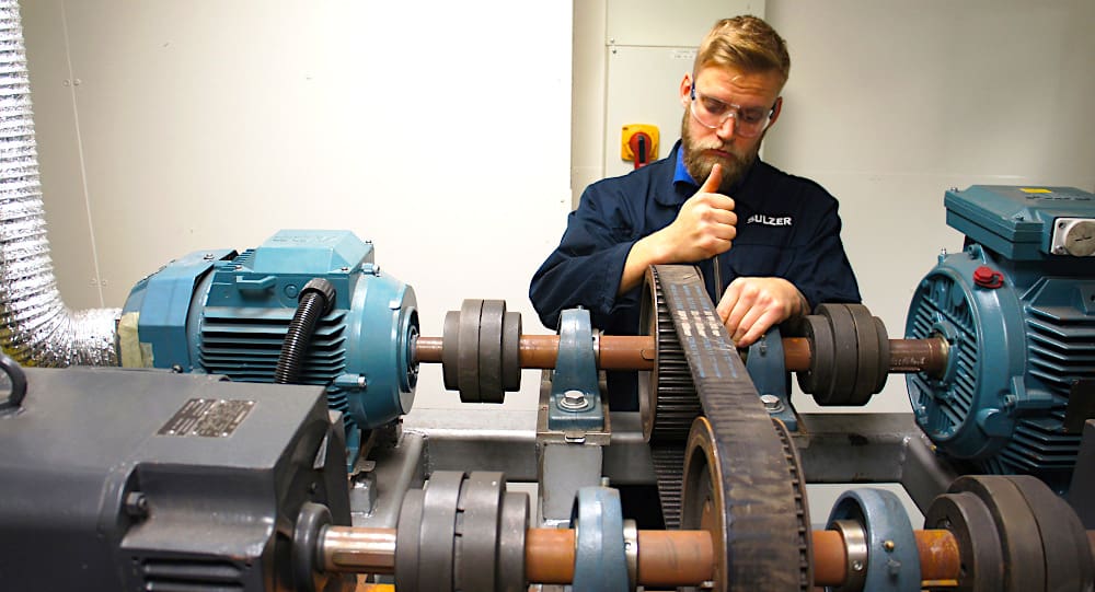

Problem #2 – Creaking and harsh motor noises
For creaking and harsh noises, check for misalignment and belt tension. Proper alignment of the motor and load is critical under real-world operating conditions and temperatures. When the temperature changes, even machines that are perfectly aligned at ambient temperature might become severely misaligned as a result of deformation or other forms of thermal growth.
Once the driven machine and motor have reached their maximum operating temperatures, you should inspect the alignment and make any required adjustments.

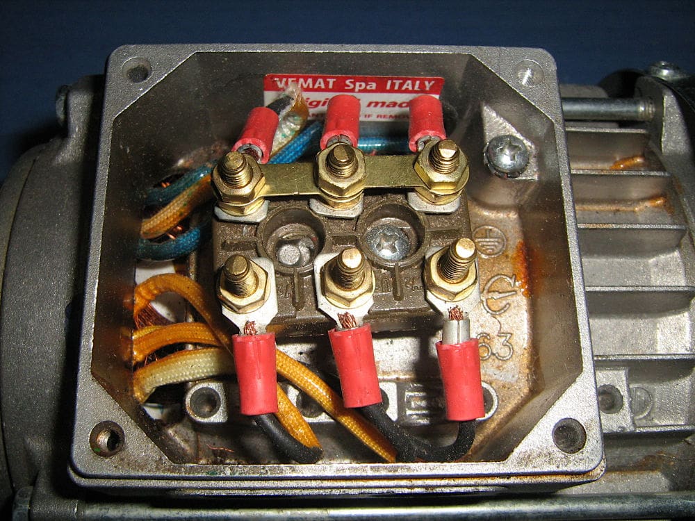

Problem #4 – Motor not taking up load
Motor not taking up load may be due to incorrect stator connections. In general, motors of 3 h.p. and above, except medium voltage motors, are wound for delta connections and all the six terminals are located in the terminal box to facilitate Y/Δ starting.
These terminals are connected in delta through metallic links. See Figure 3.
Figure 3 – Terminals inside a terminal box
If the motor is inadvertently connected in star, each motor phase will receive only 1/√3 times the rated voltage. This will reduce the torque to one third of the rated torque which may not be adequate to pick up the load.
It may even damage the windings if the motor remains energized for a while due to excessive load current (I2R losses).

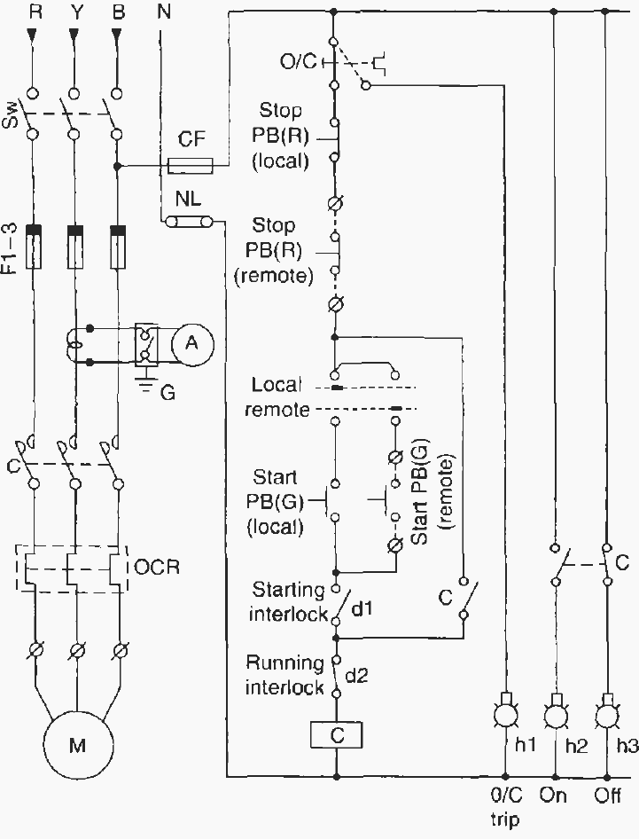

Starter relay selection or relay setting may not be matching the starting requirements. The relay thermal characteristics must match motor characteristics. In heavy drives with prolonged start times the relay may not operate if it is not properly selected.
For heavy loads, with large moments of inertia and requiring a longer starting time, a timer can be introduced into the relay circuit, to bypass this until the motor accelerates to a reasonable speed. Then the relay circuit is reactivated.
The most common practice is to provide a CT-operated thermal overload relay. The CTs have a low saturation point. In the event of a high starting current, they become saturated at two to three times the full load current and bypass the excessive starting kick through the relay and thus avoid a false trip during a prolonged start.

Check the condition of the cable insulation, its termination and jointing. Motor connections should always be made through cable lugs to ensure a proper grip as shown in Figure 6. A poor cable termination will mean arcing and localized heat and may lead to joint failure.
Figure 6 – Motor terminal box connection

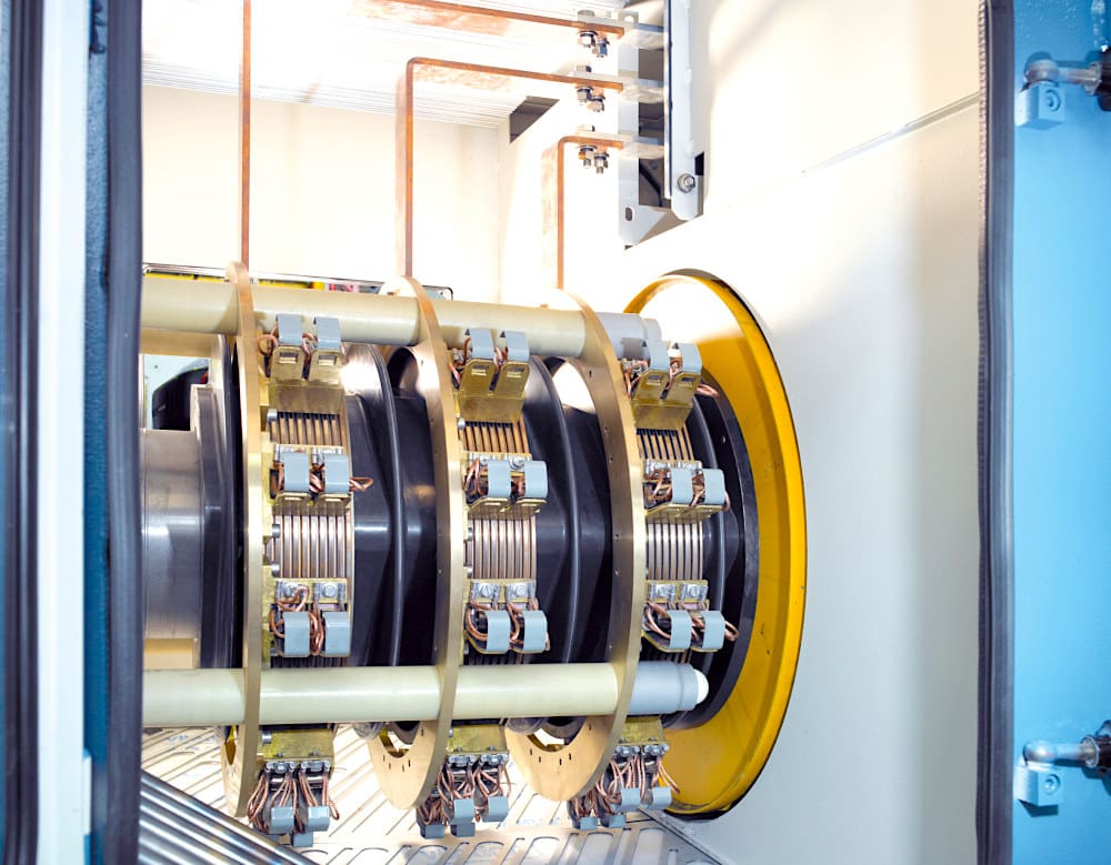

Slip-ring motors need a regular and meticulous check of brushes, brush holder unit and slip-rings for cleanliness, accurate contacts, brush curvature, wear and tear of slip-rings and arcing (Figure 7). The following procedure may be followed:
  1. Spring for pressure to be maintained around with 150-200 g/cm2 for proper to contact of the brushes with the slip-rings.
  2. Cleanliness of slip-rings and the brushes.
  3. Slip-rings, if roughened by arcing, must be cleaned with fine glass paper, having a similar curvature to the rings using a wooden block on which the glass paper can be wrapped. Emery cloth should not be used.
  4. When replacing with the new brushes, the new brushes must be first ground to acquire a curvature similar to that of the rings.
  5. Brush lifting and short-circuiting devices can be employed for motors required to run continuously for a long period to minimize wear and tear of slip-rings and brushes. However, when speed control is required or switching operations are frequent, continuous contact brush gear assembly must be employed.
Figure 7 – Slip-ring assembly with brush lifting and short-circuiting gear
