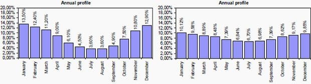

Examples of the heat and electricity demand profiles of a hospital are shown in the figures below.
Figure 3 (left). Annual profile for heat demand, Figure 4 (right). Annual profile for electricity demand

From this we can conclude that the cost savings achieved by cogeneration depends to a large extent on the energy prices and whether good use can be made of the heat produced. The electricity demand for a hospital is so high that in most cases there is never any surplus. But even if there is a surplus it can be sold back to the grid. For this reason it is important for the cogeneration to be operated on the basis of the demand for heat.
