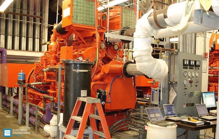

Energy Efficency In Hospitals – The Steam (on photo: San Antonio Community Hospital – Cogeneration plant)

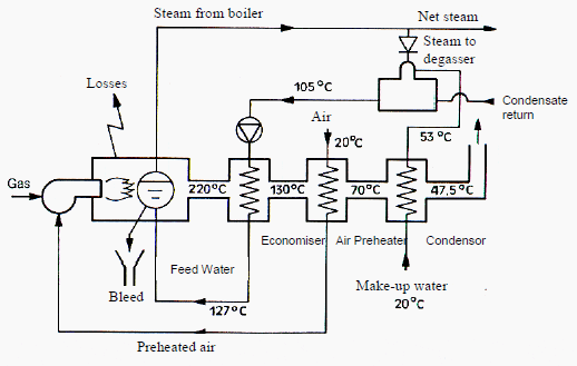

must be kept as low as possible. This is done by keeping the flue gas temperature as low as possible. Heat recovery from flue gases can be done in various ways, as shown in Figure 2 below.
Figure 2. Possibilities for recovering heat from a boiler
