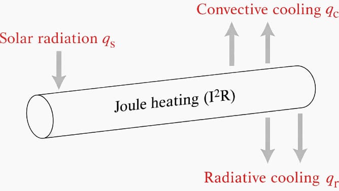

1. Ampacity Calculation (IEEE Std 738)
After determining the maximum operating current from the load flow study, the next step is to verify that the selected conductor can safely carry this current under the actual environmental conditions of the installation site. This verification is performed through an ampacity calculation, which determines the maximum continuous current that a bare overhead conductor can carry without exceeding its allowable operating temperature.
Unlike cable systems installed underground, the thermal behavior of bare conductors installed in air is strongly influenced by environmental parameters. Therefore, the current-carrying capacity of an overhead conductor cannot be considered a fixed value from a manufacturer’s catalogue.
Instead, it must be calculated by considering the thermal balance of the conductor under the specific site conditions.
The most widely used methodology for this purpose is defined in IEEE Std 738 – “Standard for Calculating the Current–Temperature Relationship of Bare Overhead Conductors.” According to this standard, the conductor temperature is determined by balancing the heat gains and heat losses acting on the conductor.
The main sources of heat input are:
  • Joule heating (I²R losses) caused by the electrical current flowing through the conductor
  • Solar heating, which depends on the solar radiation intensity and the conductor’s absorptivity
  • Heat is dissipated through two primary mechanisms:
  • Convective cooling, mainly influenced by wind speed and air properties
  • Radiative cooling, which depends on the conductor temperature and surface emissivity
Figure 1 depicts the balance between Joule heating, solar heating, and cooling by convection and radiation
Figure 1 – Thermal balance of a bare overhead conductor (IEEE Std 738)
Thermal balance of a bare overhead conductor according to IEEE Std 738 showing the balance between Joule heating, solar heating, and cooling by convection and radiation
Figure 1 – Thermal balance of a bare overhead conductor according to IEEE Std 738
Environmental parameters such as ambient temperature, wind speed, solar flux, altitude, and conductor surface characteristics significantly affect this thermal balance.
As a result, the calculated ampacity can vary considerably depending on the geographic location and climatic conditions of the substation.
By solving the thermal equilibrium defined in IEEE Std 738, the engineer can determine the maximum allowable current that keeps the conductor temperature within the specified limit, typically between 75°C and 90°C for aluminium conductors depending on the conductor type and design criteria.
The selected conductor must therefore provide sufficient ampacity under the worst expected environmental conditions, ensuring that the maximum current determined from the load flow study can be carried safely during continuous operation.
