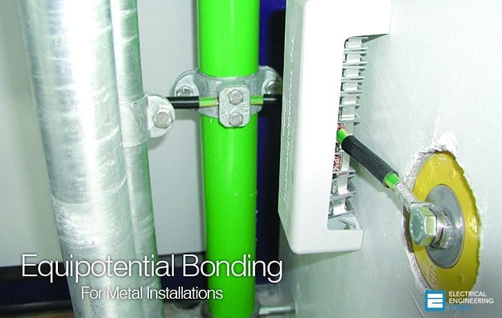

Integrating pipes into the equipotential bonding In order to integrate pipes into the equipotential bonding, earthing pipe clamps corresponding to the diameters of the pipes are used (Figure 2, left and middle picture).
Pipe earthing clamps made of stainless steel, which can be universally adapted to the diameter of the pipe, offer enormous advantages for mounting (Figure 2, right picture). These pipe earthing clamps can be used to clamp pipes that are made of different materials (e.g. steel, copper and stainless steel).
These components allow also a straight-through connection. Figure 3 shows equipotential bonding of heating pipes with straight-through connections.
Equipotential bonding of heating pipes
Figure 3 – Equipotential bonding of heating pipes
