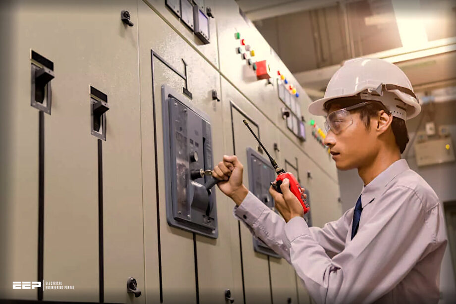

1.2 Stop Work Authority
Every person stepping into a substation, regardless of their age, rank, or experience level, possesses “Stop Work Authority”. If you see something that looks unsafe, if a procedure does not match the reality on the ground, or if you simply feel overwhelmed and confused about your surroundings, it is your professional duty to stop the job.
Never let the pressure of a deadline or the intimidation of senior technicians force you into a situation you do not understand.
Figure 2 – Working under pressure can be deadly
Substation engineer performing an operation of racking in circuit breaker
Figure 2 – Substation engineer performing an operation of racking in circuit breaker

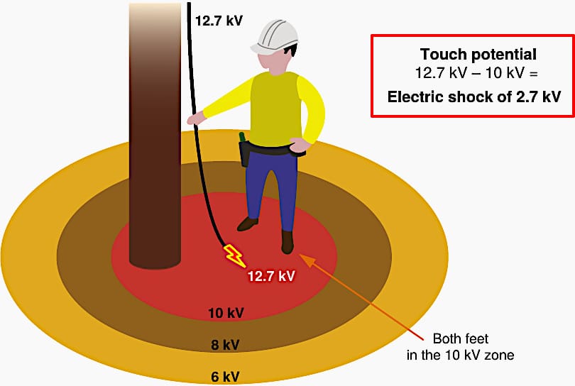

Touch Potential
This occurs if you are standing on the ground and touching a conductive object (like a fence, a transformer casing, or a switch handle) that becomes energized during a fault. Your feet are at ground potential, but your hand is at fault potential.
The current will flow through your heart.
Figure 4 – Touch potential
Touch potential

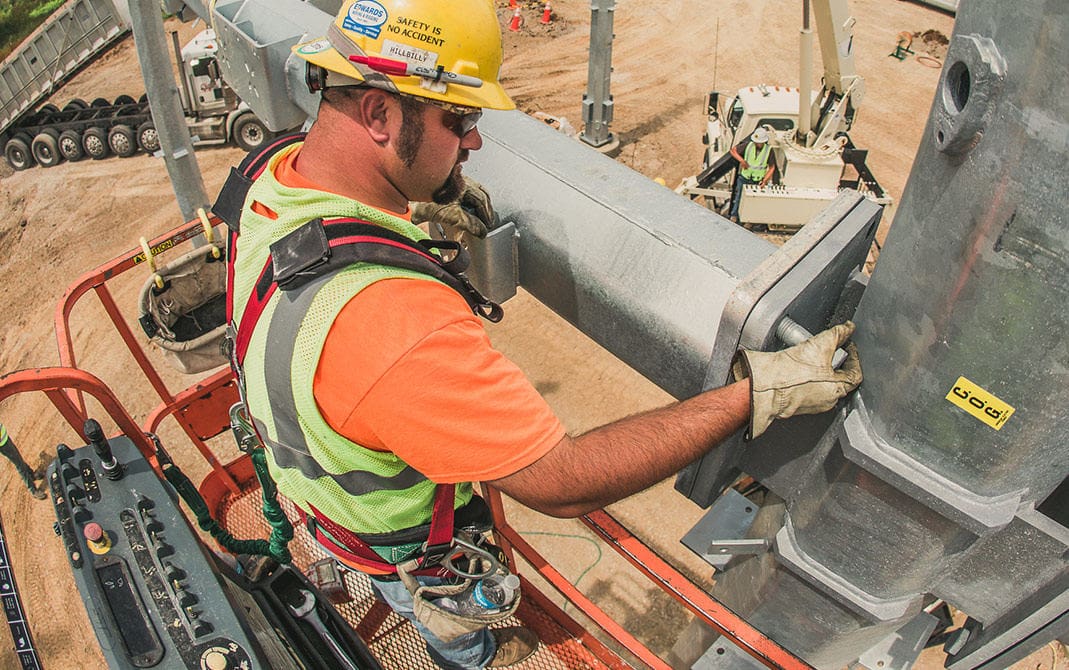

How to Protect Yourself?
Substations are built with buried ground grids designed to equalize this potential, but in an unknown substation, you cannot guarantee the integrity of that grid. Never lean on equipment. Keep your hands in your pockets when walking around observing.
If you suspect a fault is occurring, shuffle your feet (keeping them constantly touching each other) to minimize step potential.
Figure 5 – Earthed and secured switchyard worker

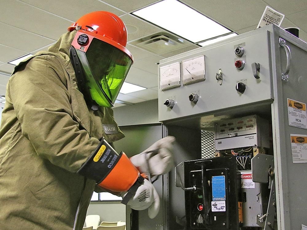

Maintain your distance from equipment operating under load, especially during switching operations. Wear the appropriate Personal Protective Equipment (PPE).
Figure 6 – Racking medium voltage circuit breaker by maintenance engineer wearing fire-resistant arc-rated PPE

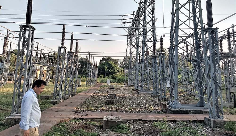

Before entering an unknown substation, you must know the highest voltage present in that yard and the corresponding MAD. If the yard is 230kV, your absolute boundary of safety is significantly larger than in a 13kV distribution yard.
Rule of thumb: If you do not explicitly know the voltage of a conductor, assume it is the highest voltage in the yard and keep well away.
Figure 7 – Unsafe approach without protective gears in switchyard of 132 kV power substation

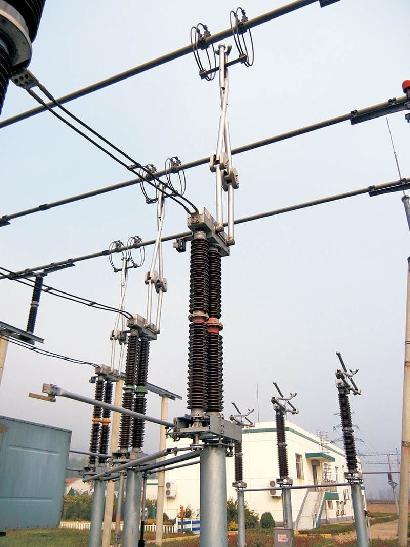

5.1 Look Up, Look Down, Look Around
Look Up
Overhead busbars, incoming transmission lines, and slack spans can sag on hot days or under heavy loads. A distance that looked safe on a drawing might be compromised in reality.
Be aware of your vertical clearances, especially if you are carrying equipment.
Figure 8 – Single-post vertically retractable UHV diconnector type
