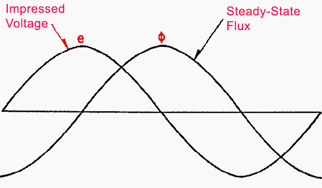

From Equation (3) it can be seen that the normal steady-state flux is a sine wave and lags the sine wave supply voltage by 90 degrees. The supply voltage and the normal flux are plotted in Figure 1 as a function of time.
Impressed voltage and steady-state flux
Figure 1 – Impressed voltage and steady-state flux

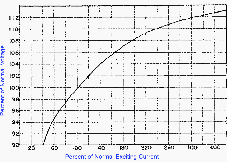

In Figure 4 the exciting current of a typical transformer is given as a function of the voltage applied to its terminals. The exciting current increases far more rapidly than the terminal voltage.
For example. 108-percent terminal voltage results in 200-percent exciting current.
Exciting current vs. terminal voltage.
Figure 4 – Exciting current vs. terminal voltage. The above curve applies for one particular design of transformer; the shape of the curve may vary considerably depending upon the grade of steel and the transformer design.

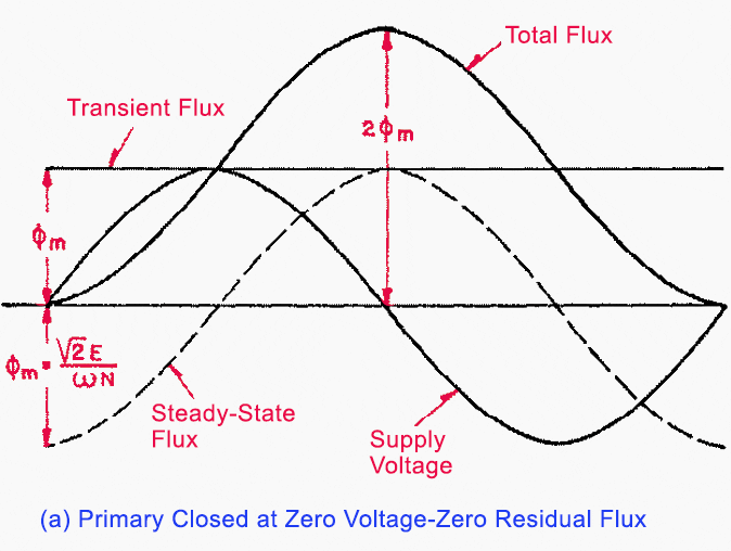

In the above equation the angle λ depends upon the instantaneous value of the supply voltage at the instant the transformer is energized. If the transformer is energized at zero voltage, λ is equal to zero, whereas if the trans-former is energized where the supply voltage is at a positive maximum value, λ is equal to 90 degrees.
Assume that a transformer having zero residual flux is energized when the supply voltage is at a positive maximum. For these conditions Φ0 and cos λ are both equal to zero so Φt0 also equal to zero. The transformer flux therefore starts out under normal conditions and there would be no transient.
However, if a transformer having zero residual is energized at zero supply voltage the following conditions exist:
λ = 0
− Φm cos λ = − Φm
Φ0 = 0
Φt0 = Φm
Substituting in Equation (4): Φ = − Φm cos (ωt) + Φm (Equation 5)
The flux wave represented by Equation (5) is plotted in Figure 5(a). The total flux wave consists of a sinusoidal flux wave plus a DC flux wave and reaches a crest equal to twice the normal maximum flux.
Transformer flux during transient condition: Primary Closed at Zero Voltage-Zero Residual Flux
Figure 5(a) – Transformer flux during transient condition: Primary Closed at Zero Voltage-Zero Residual Flux
In this figure the transient flux has been assumed to have no decrement; if loss is considered the transient flux decreases with time and the crest value of the total flux is less than shown.

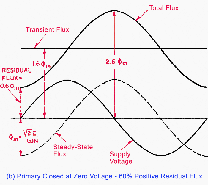

In Figure 5(b) similar waves have been plotted for a transformer having 60 percent positive residual flux and energized at zero supply voltage. Sixty percent residual flux has been assumed for illustration only. Flux waves for any other initial conditions can be calculated in a similar manner using Equation (4).
Transformer flux during transient condition: Primary Closed at Zero Voltage - 60% Positive Residual Flux
Figure 5(b) – Transformer flux during transient condition: Primary Closed at Zero Voltage – 60% Positive Residual Flux

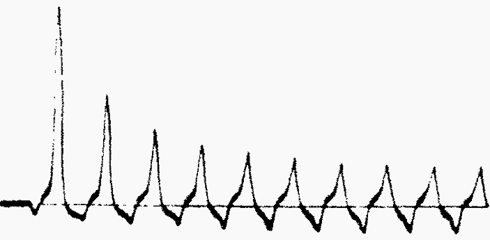

Figure 7 is an oscillogram of a typical exciting-current inrush for a single-phase transformer energized at the zero point on the supply voltage wave. The transient has a rapid decrement during the first few cycles and decays more slowly thereafter. The damping coefficient, R/L for this circuit is not constant because of the variation of the transformer inductance with saturation.
During the first few current peaks, the degree of saturation of the iron is high, making L low. The inductance of the transformer increases as the saturation decreases, and hence the damping factor becomes smaller as the current decays.
Current inrush for a particular transformer energized at zero voltage
Figure 7 – Current inrush for a particular transformer energized at zero voltage
