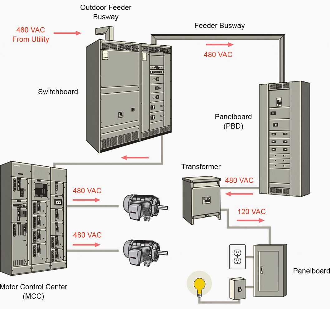

Switchgear belongs to the most upstream portion among all other mentioned LV members like switchboards and MCCs. Primarily, switchgear comprises equipment that contains very high-energy compartments capable of isolating the downstream faulty portion completely, keeping the rest of the distribution system intact and running. Switchgear act as the last line of defense and hence are more robust to withhold fault for a relatively long period.
In most cases, incomers and main outgoing feeders in LV switchgear are equipped with ACBs while the downstream switchboards have MCCBs and MCBs for protection.
Figure 3 – LV distribution principle
