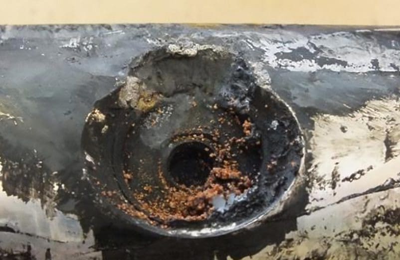

In 2004, the substation experienced a number of the earliest known failures in the City of Cape Town. Chlorine was strongly odorated when staff entered the substation for switching operations. Upon further inspection, they discovered that the breaker had severe discharge degradation on the bushing insulation and cluster contacts. At the substations, there was also severe corrosion, tracking, and cluster degradation (Figures 1 and 2).

Figure 3 – Severe corrosion degradation of circuit breaker clusters

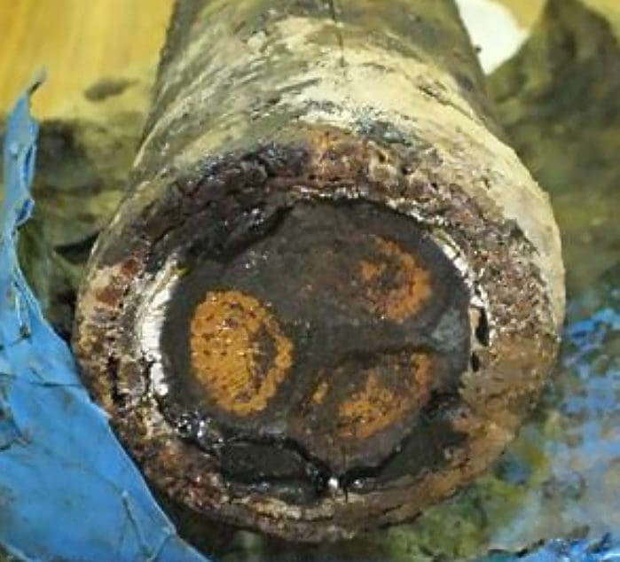

Figure 4 – Severe corrosion degradation of circuit breaker and tracking on the bushings

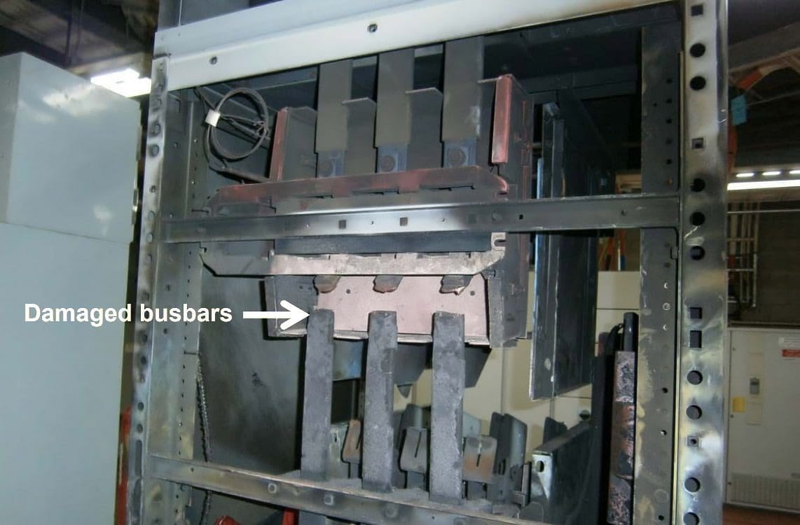

The following failure happened with a feeder breaker, which was taken out for performing CM tests. The breaker was racked in the “test” position and the wires for the timing test were attached to the arms of the breaker. When inserted in the “test” position, the breaker flashed over. It was discovered that the mechanical interlock’s failure was what led to flashover.
The test equipment’s metallic clamp came within arcing range of the live busbar when it was connected to the breaker, which led to the flashover.
