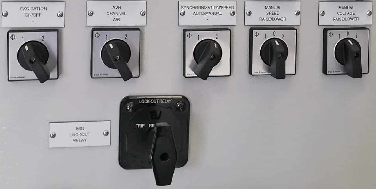

Typical front commands of synchronization panel
Figure 2 – Typical front commands of synchronization panel
Since usually, the upstream VT is part of an existing MV equipment, unless the plant is totally a greenfield installation, accuracy versus the device downstream the (possibly new) MV breaker may differ significantly. The secondary value may differ, e.g. in Europe, the industry-standard moved from 100V line to line to 110V line to line during last year and upstream voltage may be affected by a tap changer position of an upstream transformer, possibly in a part of the plant that is not accessible for a CHP or other continuous cycle production plant.
Although standard pre-commissioning checks, in the particular primary injection of VT and reading of the measured voltages on the control panel, will help to prevent these errors, a very dangerous (as we will see also for the phasor angle displacement) is a potential double mistake that will make the system look like (not only to the operator but also to digital synchro check devices) ready to synchronize.
What will happen e.g. if the VT upstream is marked on the schematics as brand new 110V secondary, while actually is still the old 100V device and at the same time the upstream transformer tap changer is not in null position but it is raising the busbar voltage of exactly +10% (e.g. due to plant need, e.g. some operator may have acted on the tap to compensate a reactive power compensator bank temporary offline)?
In this scenario, you may have perfectly adjusted the automatic synchronizer and synchro check, but there is no possibility to avoid a breaker closure that will trigger a massive reactive power flow from the grid since the actual voltage difference is way above the permitted delta.

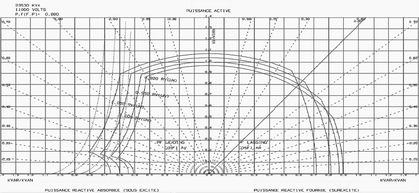

Typical generator capability (P-Q) curve, x-axis differentiates under and overexcited operation
Figure 3 – Typical generator capability (P-Q) curve, x-axis differentiates under and overexcited operation (click to expand)
In this scenario either the AVR increases the field (excitation) current, which is unlikely since due to the above double mistake the AVR is not aware to be in under excited state… and to increase field current will be against the overexcitation limiter logics, or a trip will happen.
Since you are affecting the reactive power flow from the grid this trip may occur at grid breaker level, that is what you do not what to experience in a CHP installation since a full outage will take hours to recover, apart from the mechanical stresses on the machines (especially a brand new prime mover like a gas turbine) due to a sudden trip.
