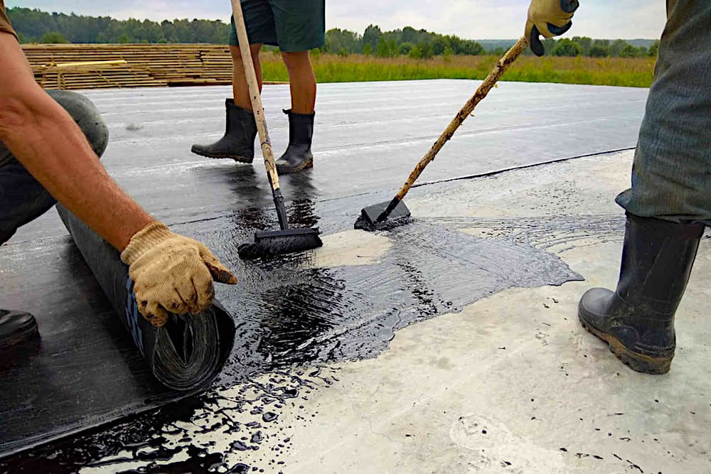

1.2 Water-Insulating Layers Under Foundations (Unintended Electrical Insulation)
Modern substations frequently include civil requirements for water resistance:
  • Bituminous membranes
  • PVC/HDPE water barriers
  • Waterproof concrete coatings
  • Chemical sealing layers
These materials are excellent for waterproofing—but they act as electrical insulators.
Observed construction practices
  • Entire building foundations are covered with waterproof membranes.
  • Vertical foundation walls are coated with bitumen or plastic layers.
  • Soil-improvement gravel pads under foundations are several tens of cm thick.
  • Buildings sit on high-resistivity layers not modeled in the grounding study.
Why this is a problem?
Grounding studies assume that building foundations, rebar cages, and concrete structures are electrically bonded to soil. Concrete has good conductivity due to moisture and ionic content.
When you add an insulating layer between building and soil, this is what actually “happens”:
  • The concrete loses its natural conductive path.
  • The building “floats” electrically.
  • Step and touch voltages around building edges increase.
  • Fault current distribution becomes uneven.
  • Grounding resistance increases.
Typical consequences
  • Dangerous gradients around the building perimeter
  • Uncontrolled potential rise inside control rooms
  • GIS or control building grounding not behaving as modeled
  • Need for retrofitted external ground rings or copper plates
In worst cases, the grounding design becomes invalid, even if the grounding mat itself is correct.

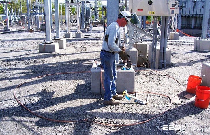

1.3 Incorrect Grounding Mat Layout & Enlarged Openings
Ground grids are designed with specific conductor spacing—often 6 m × 6 m or similar—to control voltage gradients across the substation. Every conductor, bond, and mesh opening affects the electric field distribution.
Common deviations
  • Mesh spacing becomes larger due to construction shortcuts.
  • Some grid connections are omitted as “unnecessary”.
  • Ground rods are reduced or replaced with shorter ones.
  • Conductors are rerouted around obstacles (cable trenches, ducts, pits).
  • Mesh alignment shifts due to tolerances in excavation.
Why larger openings are dangerous?
Larger mesh openings increase the potential gradient between adjacent points, leading to:
  • Higher step voltages
  • Higher touch voltages, especially near equipment structures
  • Uncontrolled hot spots around transformer foundations, fences, and tower legs
  • Poor equipotential bonding in heavily loaded areas
The grounding design relies on the density of the grid to maintain safe voltage differences. When the spacing is increased even by 0.5–1 m, the model is no longer valid.

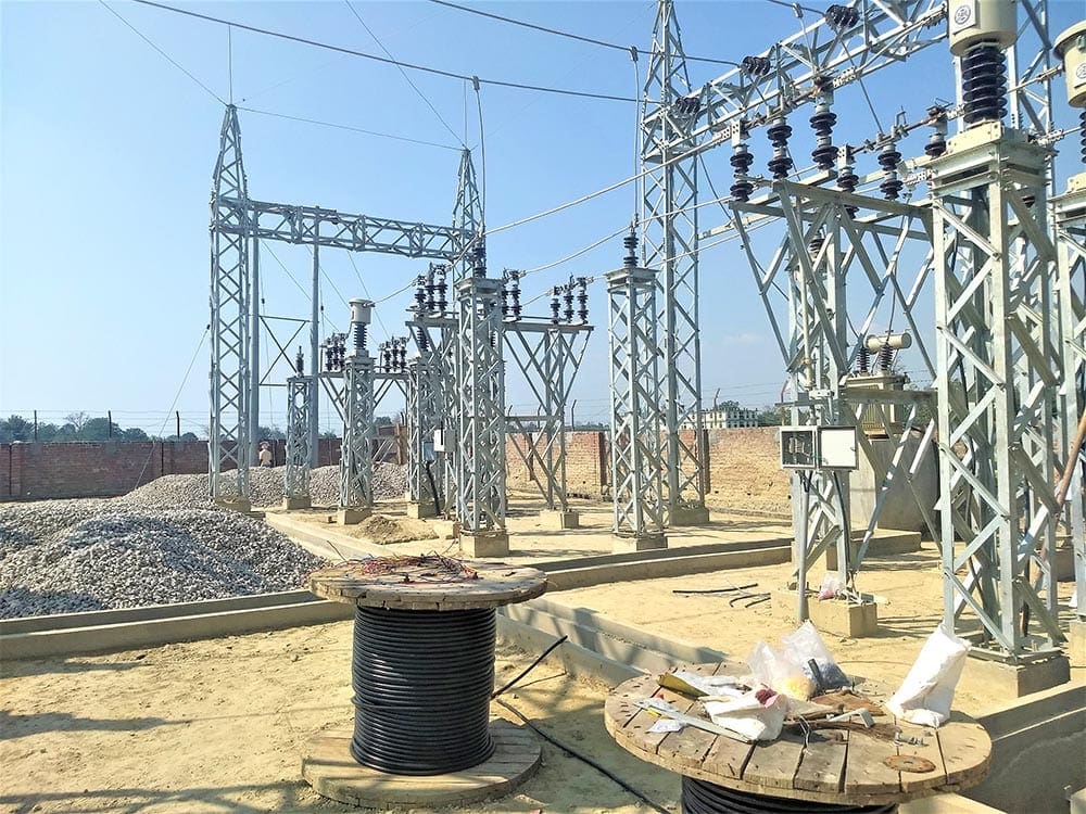

1.4 Soil-Improvement Layers Not Included in the Soil Model
During construction, contractors often add soil-improvement layers to stabilize ground or improve drainage:
  1. Thick gravel layers
  2. Compacted crushed rock
  3. Sand layers for leveling
  4. Imported fill with unknown resistivity
  5. Geotextile layers separating fill from native soil
Why this undermines the grounding study
Grounding studies are built on soil resistivity measurements taken before construction. If the soil profile changes during civil works, the real resistivity distribution is no longer the one modeled.
Typical impacts are:
  • Increased top-layer resistivity → higher touch voltages.
  • Modified depth of the native soil → inaccurate grid resistance calculation.
  • Poor grounding system performance even if grid layout is correct.
Critical problem
Contractors often perform soil-improvement after the grounding study without informing engineers. The first time the problem is discovered is during commissioning tests—when it’s too late.
Ouch!
Figure 4 – Overhauling of gravel surface of switchyard at 33/11 kV Substation
Overhauling of gravel surface of switchyard in 2019 at 33/11 kV Taulihawa Substation, Nepal
Figure 4 – Overhauling of gravel surface of switchyard in 2019 at 33/11 kV Taulihawa Substation, Nepal

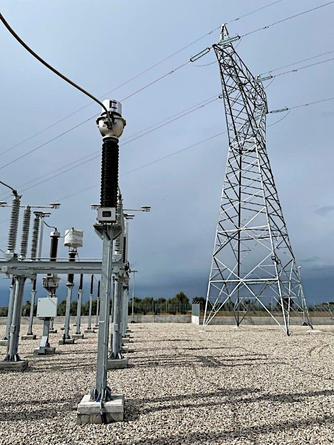

1.5 Poor Soil Resistivity Measurements Due to Fill Layers
In some cases, measurements are taken after soil improvement or on disturbed ground. This produces artificially high or low resistivity values, leading to:
  • Incorrect design of the grid
  • Underestimation of required conductor density
  • Misleading conclusions about necessary ground rods
  • Incorrect modeling of multilayer soil
If gravel is present during measurement, the meter sees the gravel—not the real soil.
What are the On-site consequences?
  • Grid resistance not reaching target
  • Need for unplanned deep earth rods
  • Need for perimeter enhancement (ground rings, backfill materials)
