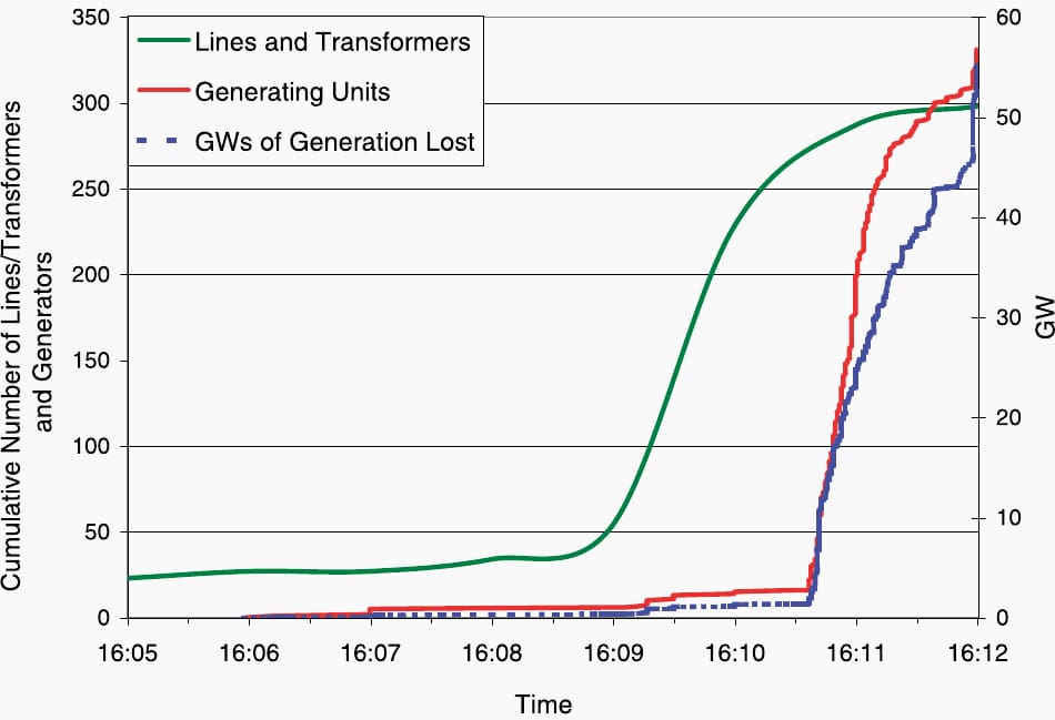

To prevent cascaded line tripping, it is essential to maintain sufficient coordination margins between the operational characteristics of all non-unit protection relays employed in the network, and when feasible, to implement high-speed unit or communication-assisted protection methods.
The reliability, security, and specificity of the protective relays and schemes, including their communication systems when applicable, are crucial in mitigating the risk of cascading line tripping.
Nevertheless, enhancing the performance of traditional equipment protection may not entirely prevent the phenomena that result in cascaded line tripping, and Emergency protection systems (EPSs) may be necessary to mitigate their effects on the power system.
Figure 4 – Rate of line and generator trips during the cascade
