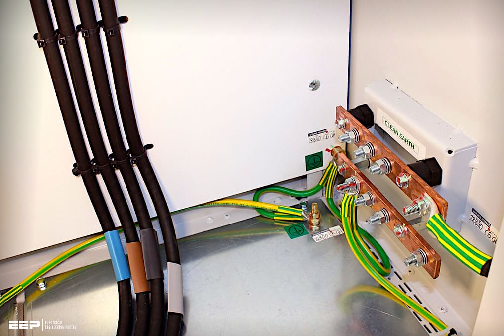

What is a Floating Neutral and how does it affect the power distribution
What is a Floating Neutral and how does it affect the power distribution (photo credit: Mardix Limited via Fickr)
The floating neutral condition can cause voltages to float to a maximum of its Phase volts RMS relative to ground, subjecting to its unbalancing load Condition. Floating Neutral conditions in the power network have different impact depending on the type of Supply, type of installation and Load balancing in the Distribution.
Broken Neutral or Loose Neutral would damage to the connected load or create hazardous Touch Voltage at equipment body.
