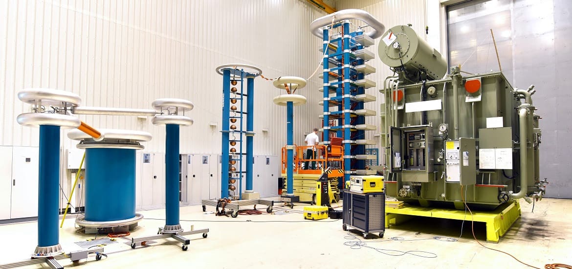

Figure 1 – Procedure for transformer lightning impulse test
Figure 1 – Procedure for transformer lightning impulse test (on photo: 385 MVA; 400kV power transformer)

d) Partial Discharge Test
Partial discharges (PD) are localized insulation breakdowns that can lead to progressive deterioration. IEC 60076-3 specifies PD limits to ensure insulation integrity under operating conditions. The transformer must exhibit minimal PD activity to prevent long-term damage.
Figure 2 – Picture of power transformer during lab testing (click to zoom)

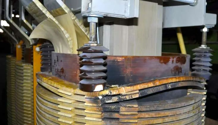

A short circuit occurs when an unintended low-impedance path forms between conductors, causing a sudden surge of fault current. These high-magnitude fault currents can reach values several times the rated current within milliseconds, subjecting the transformer to severe mechanical, electrical, and thermal stresses.
If a transformer lacks adequate short-circuit strength, it may suffer from:
  • Winding displacement or deformation due to high electromagnetic forces.
  • Internal insulation breakdown leading to dielectric failure.
  • Damage to core clamping and structural components, affecting performance and lifespan.
Ensuring short-circuit strength is critical for system reliability, as transformer failures due to insufficient mechanical strength can lead to costly outages and equipment damage.
Figure 3 – Transformer winding damaged by short circuit tension
Figure 3 – Transformer winding damaged by shirt circuit tension

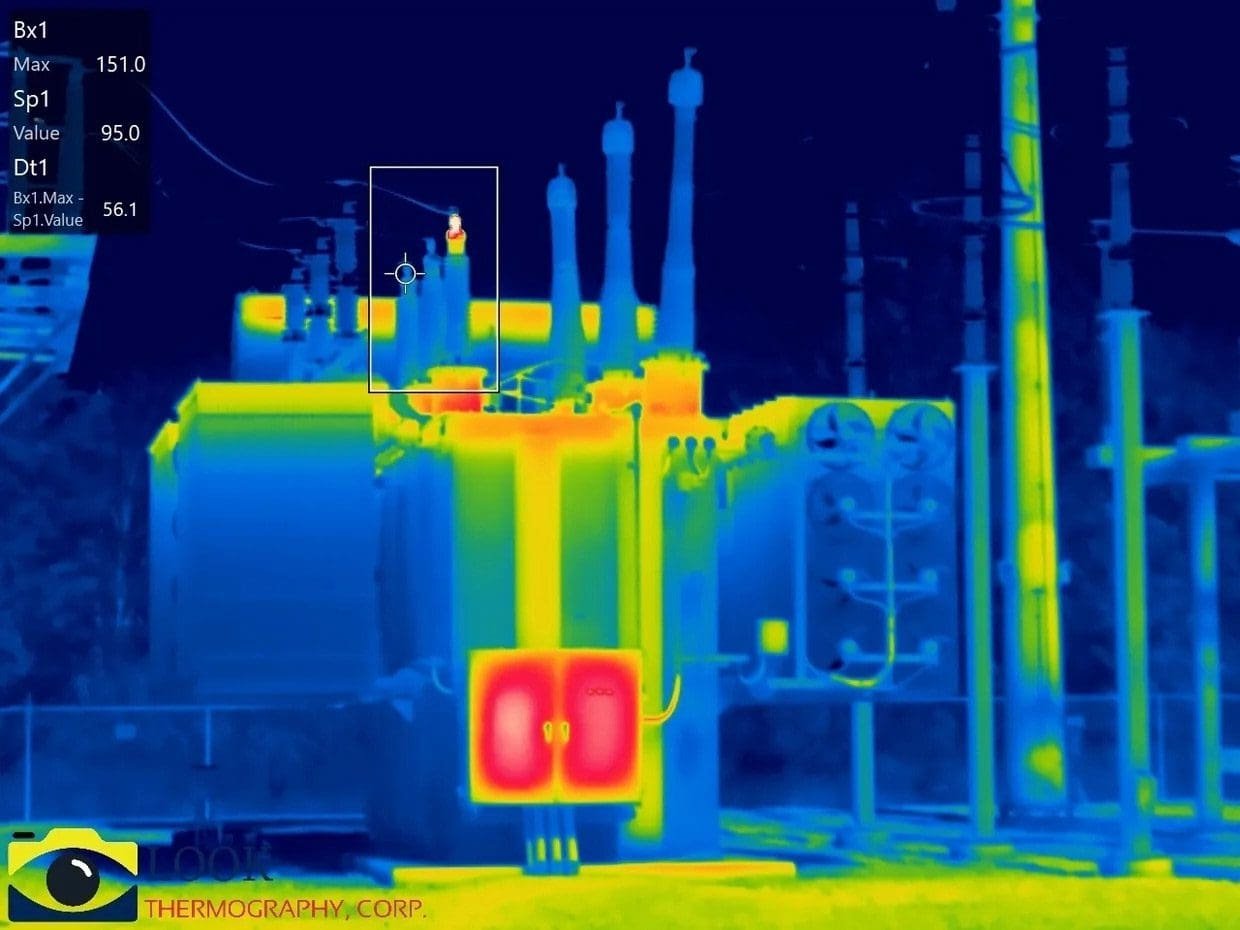

Figure 4 – Thermal infrared inspection of power transformer

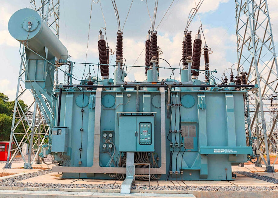

Figure 5 – Left: Damaged Bushing; Right: Faulty OLTC
