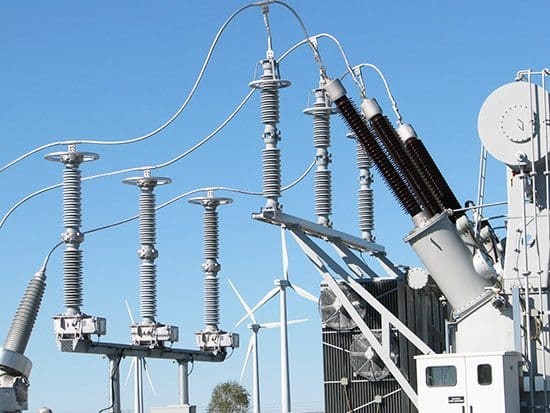

7.2 Lightning Arresters
Conductors as short and straight as practicable to ensure minimum impedance shall directly connect the bases of the lightning arresters to the earth grid. In addition, there shall be as direct a connection as practicable from the earth side of lightning arresters to the frame of the equipment being protected.
Individual ground electrodes should be provided for each lighting arrester for the reason that large grounding system in itself may be relatively of little use for lightning protection. These ground electrodes should be connected to the main earth system.
In the case of lighting arresters mounted near transformers, earthing conductor shall be located clear off the tank and coolers in order to avoid possible oil leakage caused by arcing.
144kV Lightning Arresters with grounded bottom terminals and with insulated leads
Figure 7 – 144kV Lightning Arresters with grounded bottom terminals and with insulated leads (photo credit: arresterworks.com)
