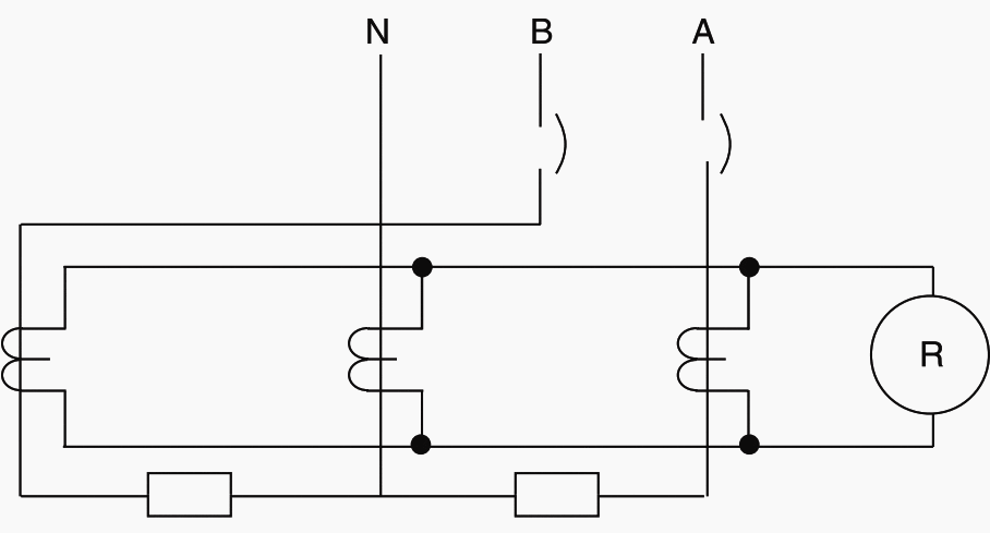

1. Residual connection
A residually connected ground relay is widely used to protect medium-voltage systems. The actual ground current is measured by CTs that are interconnected in such a way that the ground relay responds to a current proportional to the ground-fault current.
This scheme, using individual relays and CTs, is not often applied to low-voltage systems. However, low-voltage systems are available with three CTs built into them and connected residually with the solid-state trip devices to provide ground-fault protection.
The term residual in common usage is normally reserved for three-phase system connections and seldom applied to single-phase or multiple-signal mixing.
The basic residual scheme is shown in Figure 1. Each phase relay is connected in the output circuit of its respective CT, while a ground relay connected in the common or residual circuit measures the ground-fault current.
Residually connected ground relay
Figure 1 – Residually connected ground relay
In three-phase three-wire systems, no current flows in the residual leg under normal conditions because the resultant current of the three CTs is zero.
This situation is true for phase-to-phase short circuits also. When a ground-fault occurs, the short-circuit current, returning through earth, bypasses the phase conductors and their CTs, and the resultant current flows in the residual leg and operates its relay.
On four-wire circuits, a fourth CT should be connected in the neutral circuit as shown in the dashed portion of the current. The neutral conductor carries both 60 Hz single-phase load unbalance current as well as zero-sequence harmonic currents caused by the nonlinear inductance of single-phase loads, such as fluorescent lighting.
Without the neutral-conductor CT, the current in that conductor would appear to the ground relay as ground-fault current, and the ground relay would have to be desensitized sufficiently to prevent opening under unbalanced load conditions.
The selectivity of residually connected relays is determined by the CT ratio and the relay pickup setting. The CT ratio must be high enough for normal load circuits.
Also to be considered are the unbalanced primary currents in each phase, the sum of which may contain sufficient asymmetrical current to cause a trip during a motor start.
For this reason, sensitive ground-fault protection schemes do not use instantaneous trips when a residually connected circuit is involved. If ground-fault protection with greater sensitivity is needed, the core-balance method should be considered (see next paragraphs).

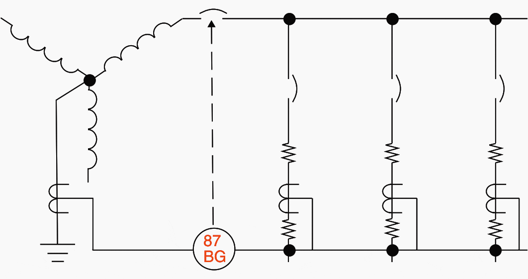

4. Ground differential
A generic term, ground differential is used for a variety of schemes that utilize phasor or algebraic subtraction or addition of signals. The currents may be produced by any of the methods discussed in sections 1 through 3.

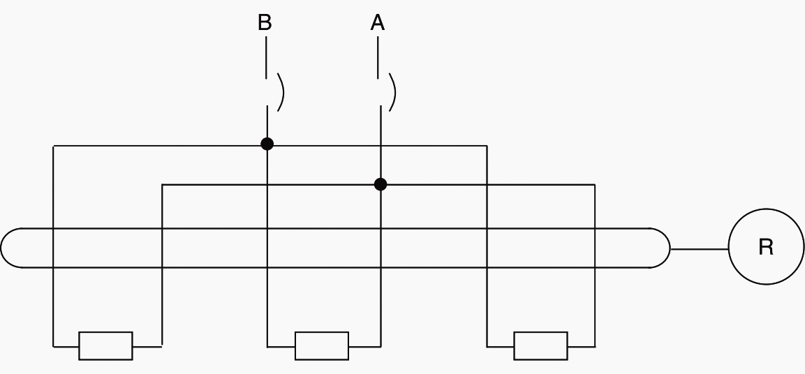

Figure 5, for example, shows a ground differential protection for single-phase center-tapped loads and is similar to the residual method.
Differential protection center-tapped loads
Figure 5 – Differential protection center-tapped loads
One core-balance sensor could detect ground faults in a plurality of loads (see Figure 6). Ground-differential relaying is effective for main bus protection because it has inherent selectivity.
Differential protection multiple loads
Figure 6 – Differential protection multiple loads
With the differential scheme (see Figure 7), core-balance CTs are installed on each of the outgoing feeders and another lower ratio CT is placed in the transformer neutral connection to ground.
This arrangement can be made sensitive to low ground-fault currents without false opening for ground faults beyond the feeder CTs.
All CTs should be carefully matched to prevent improper opening for high-magnitude faults occurring outside the differential zone.
Ground-differential scheme bus and transformer
Figure 7 – Ground-differential scheme bus and transformer
Bus-differential protection protects only the zone between CTs and does not provide backup protection for feeder faults.
