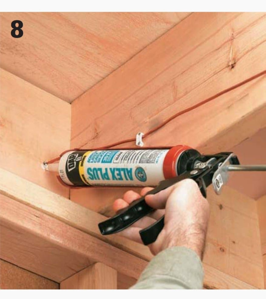

Step #8
Inject caulk into the hole in the rim joist on both the interior and exterior side.
