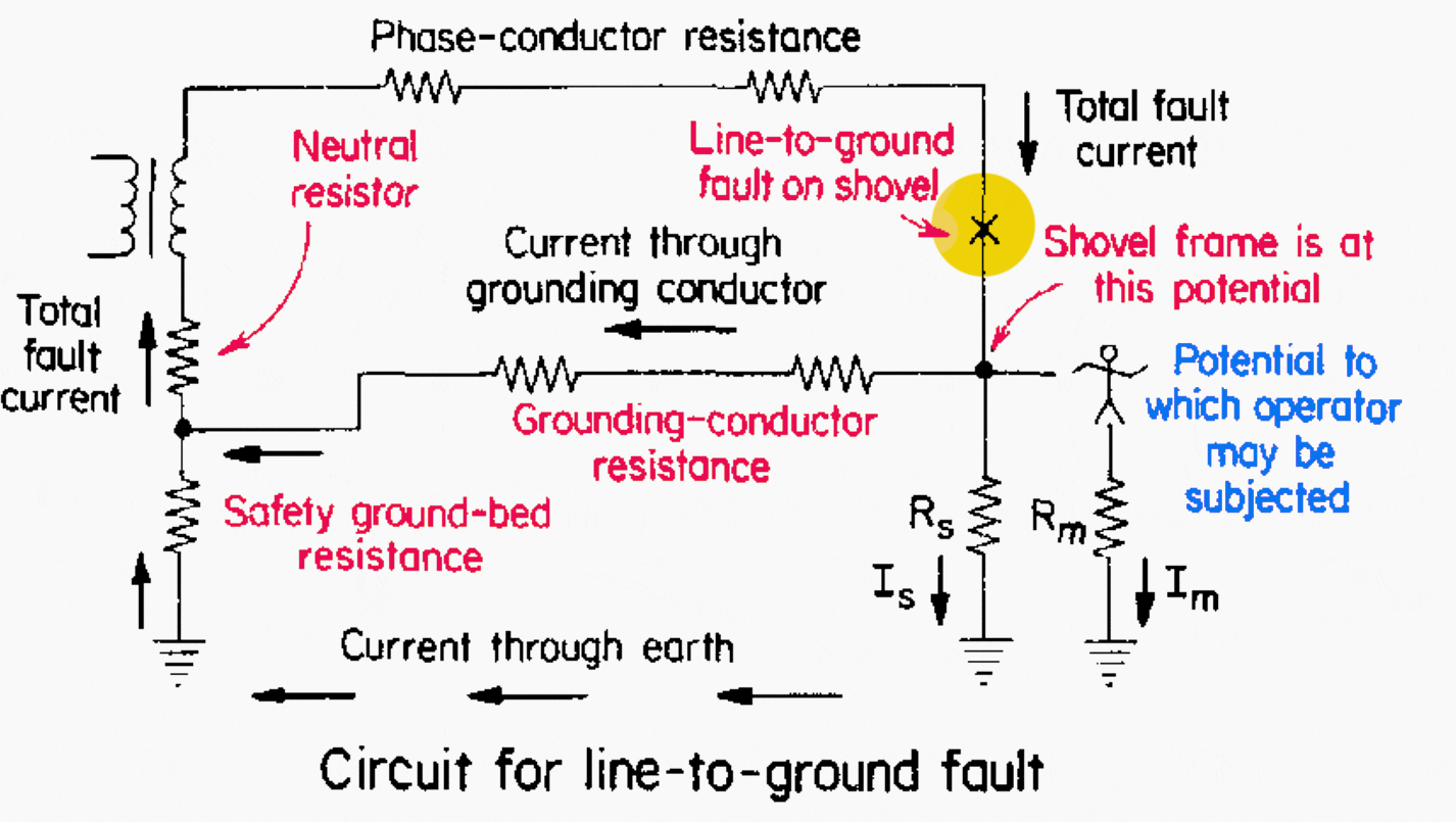

First, the grounding system must limit potential gradients between conducting materials in a given area. During a ground fault, for instance, a phase conductor comes into contact with a machine frame, and current flows through the equipment; subsequently, the potential of the equipment tends to become elevated above ground potential by a n amount equal to the voltage on the conductor.
If a mine person touches the machine, while being simultaneously connected to ground in some manner, the body’s potential can become elevated, possibly to a lethal extent.
The maximum potential to which a person could he exposed when touching a machine frame is equal to the voltage drop along the grounding conductors. Thus, the grounding system must provide a low-resistance path for the fault current to return to the source, and the ground conductors should have low resistance so they can carry the maximum expected fault current without excessive voltage drop.
An example of the exposed potential in a surface mining situation is illustrated in Figures 1 and 2.

Second, the grounding system should limit the energy available at the fault location. Heavy arcing or sparking can ignite nearby combustible material. The air itself can become ionized, making it capable of carrying tremendous amounts of current. A high-energy fault can vaporize breakers, switchgear, and phase conductors, and protective enclosures may be blown apart with explosive force.
Controlling the maximum allowable fault current significantly reduces the danger of fire and holds equipment damage to a minimum.

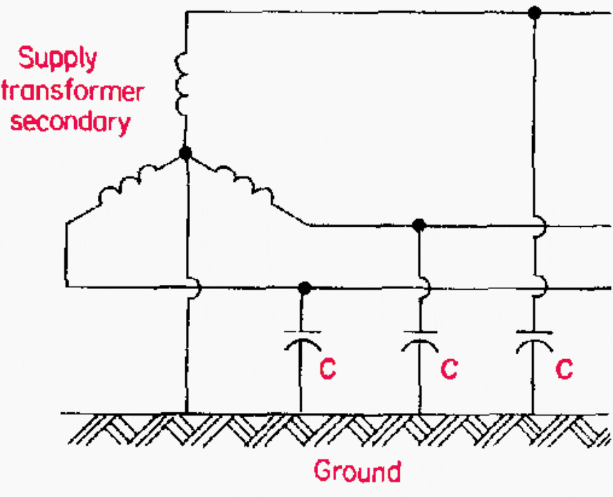

The ungrounded system was probably the first to be used because of its simplicity. Here there are no intentional ground connections in the system whatsoever. However, a perfect ungrounded system cannot exist, since any current-carrying conductor may be coupled to ground through numerous paths, including the distributed capacitance of its wiring, or through motor windings.
This phenomenon is shown in Figure 3.
Figure 3 – Capacitance coupling in ungrounded system
The first line-to-ground fault on such a system will have very little effect because there is no way for the fault current to find a complete circuit back to the source, and its magnitude will be very small or nil. Very low fault current means no flash hazard and no equipment damage.
Circuit operation continues normally with no interruption of power, an important consideration in industries where downtime is critical . The first fault is often hard to locate because its effects are negligible.
Often no repair effort is made until a second fault occurs, with its concomitant hazards of arcing, heavy current flow, and equipment damage. Since

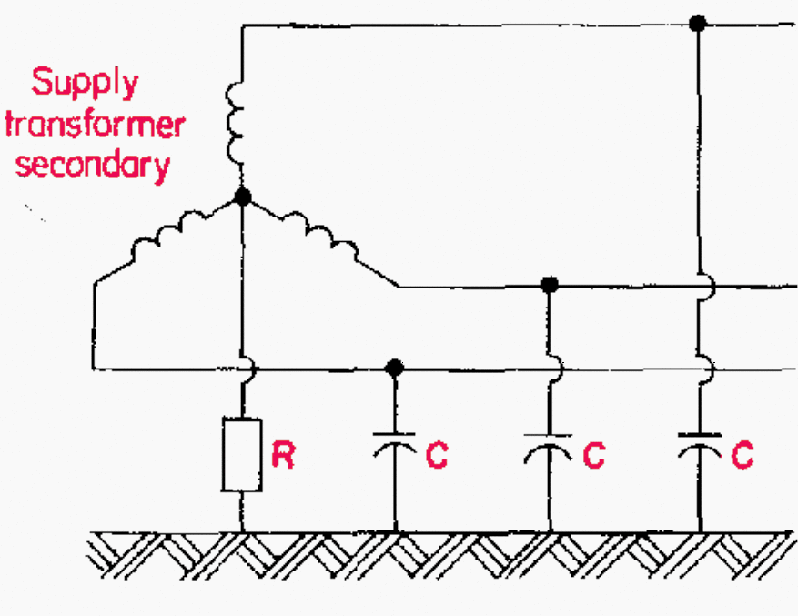

Figure 5 – Resistance-grounded system
2.4 High-Resistance Grounded Neutral
Perhaps the best technique, and that required by law in coal-mining applications on portable or mobile equipment, is the high-resistance grounded system, often referred to as the safety ground system. The neutral grounding resistor is sized according to the system voltage level, in general to limit ground-fault current at 50 A or less.
Where the line-to-neutral potential is 1,000V or less, the grounding resistor must limit fault current to 25 A or less; above 1,000 V, the voltage drop in the grounding circuit external to the resistor must be 100V or less under fault conditions. With this system, sensitive relaying must detect faults on the order of a few amperes to provide fault isolation and facilitate quick location of the trouble spot. The level of fault current is also low enough to practically eliminate arcing and flashover dangers.
The ground connection also serves to limit the amplitude of overvoltages. However, loads cannot be connected line to neutral, as the grounding conductor must not carry any load current.

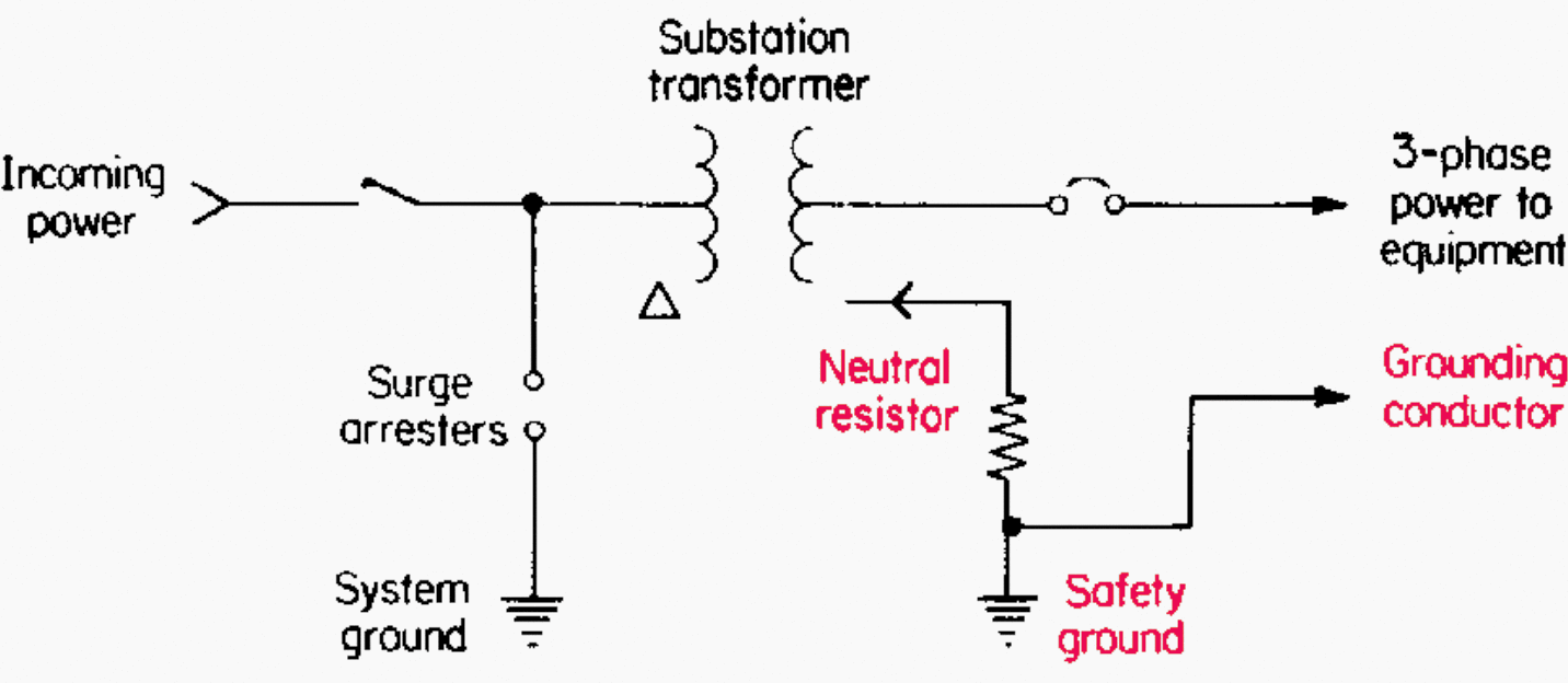

For mine usage, the electrical distribution cables and overhead transmission circuits carry into the mine one or more grounding conductors in addition to the phase conductors. Each piece of AC equipment has its frame solidly connected via these grounding conductors to a safety ground bed commonly located near the main surface substation and consisting of buried horizontal conductors or driven rods, or a combination of both.
The neutral of the substation transformer secondary is also connected to the safety ground bed through the neutral grounding resistor, as shown in Figure 6.
Figure 6 – Simplified single-line diagram of substation
It should be noted that for the sake of simplicity, many important components are missing from this diagram.

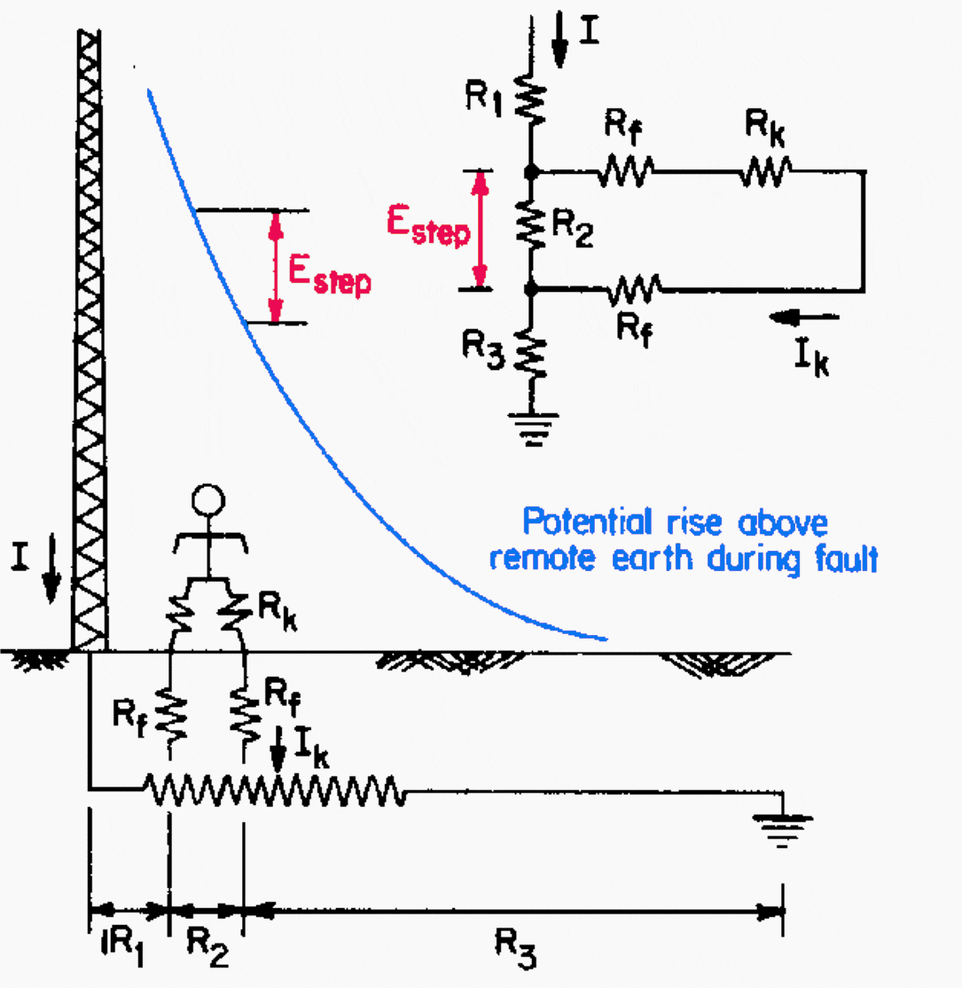

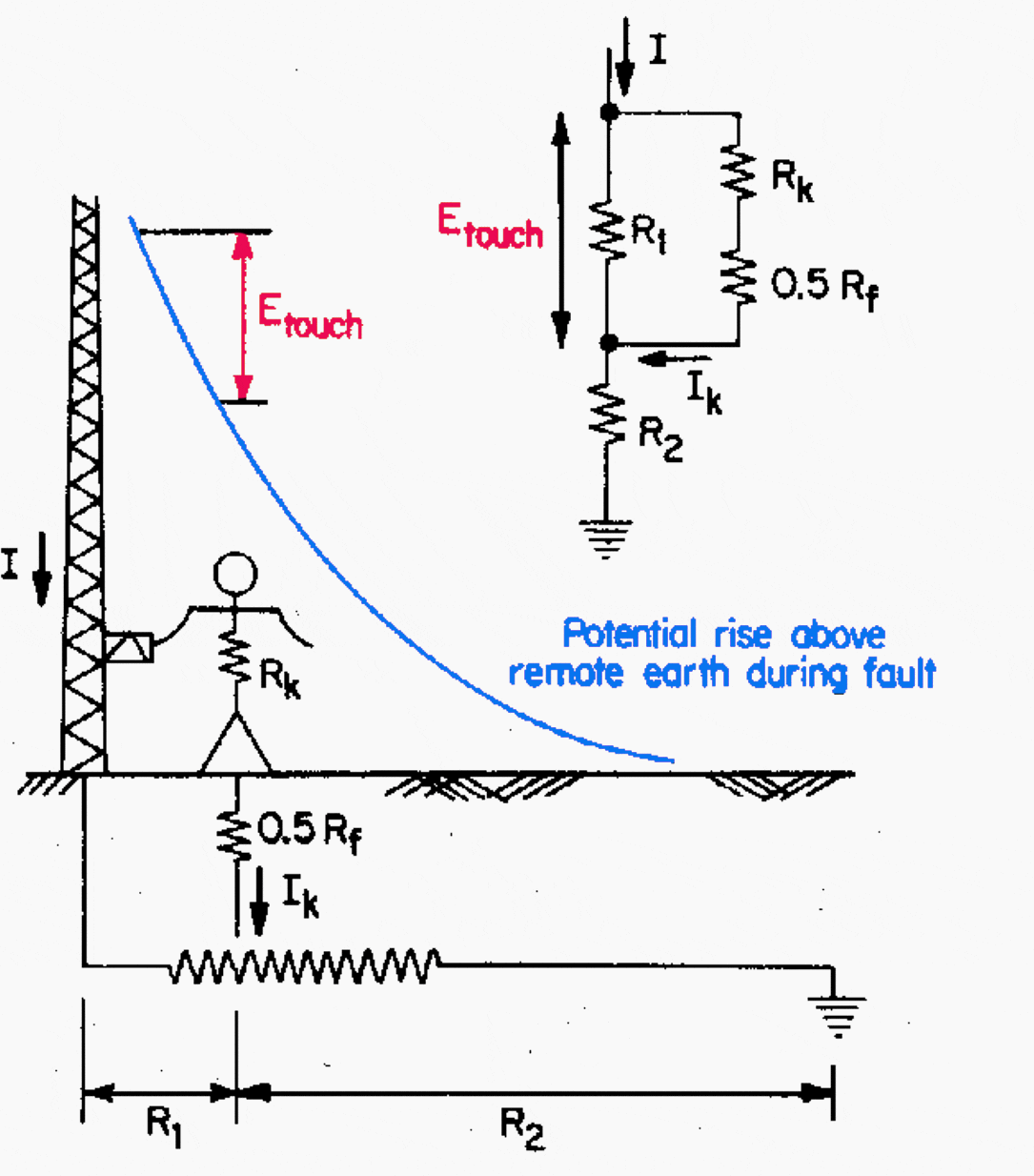

Depending upon the physical extent of the grid, a person walking through the area underlain by the grid could bridge a lethal potential gradient with his or her feet. Metallic objects within the potential gradient field can also be elevated to dangerous potentials and become lethal to the touch.
Typical step and touch potentials are illustrated in Figures 7 and 8.
Figure 7 – Step potentials near grounded structure
These step and touch potential hazards are applicable to both the system and safety ground beds. However, the dangers of a high-resistance safety ground bed are not found close to the bed but at the mining equipment.
Figure 8 – Touch potentials near grounded structure
