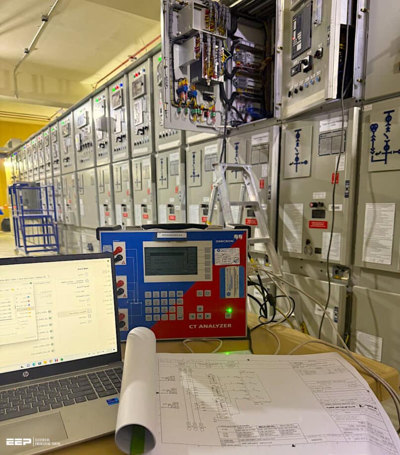

1.1 Secondary Injection to CTs & PTs Circuits
Meggering and high-pot testing of the switchgear are the initial steps. Next, in accordance with the protective relay setting sheets for every circuit breaker, the protective relays are tested by secondary injection (simulation) to trip the breakers caused by overloads or undervoltages.
The circuits of protective current transformers (CTs) and potential transformers (PTs) are supplied to the tester to simulate the operational condition.
A three-phase tester, depicted in Figure 1, conducts the secondary injection.
Figure 1 – Secondary injection test kit
Figure 4 – Secondary injection test kit

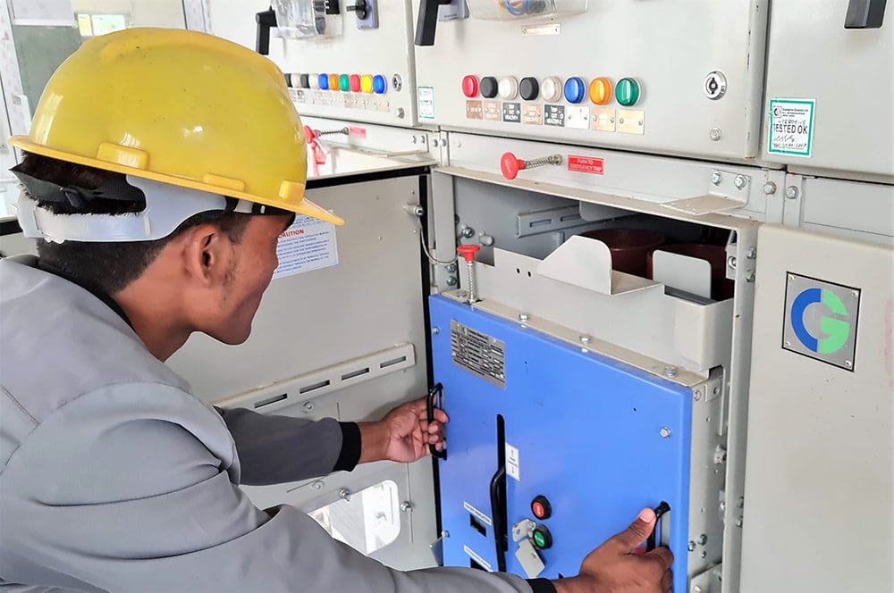

1.2 Circuit Breakers (Drawn-in, Test and Drawn-out Conditions)
Each circuit breaker in the switchgear can be tested for operation in its drawn-in (actually connected), test, and withdrawn (disengaged) positions. The switchgear is de-energized; however, the circuit breakers remain operable due to the electrically powered 125 V DC control circuits, enabling their functionality.
Additionally, an additional control circuit operating at 24 V AC or DC may be utilized for remote operation and communication with the plant control system. In each of the three positions, the switchgear and circuit breaker make their presence known and marked.
In the withdrawn state, one may test the breaker to charge the activating spring and to open or close without impacting the other breakers in the panel. The breaker test position is a half-drawn-out position. This position allows for comprehensive testing of the breaker in all control and interlock aspects, without impacting other components of the switchgear assembly. In the connected position (drawn-in), the breaker can be thoroughly checked if the incoming and tie breakers have been locked and maintained in a withdrawn position.
The test position is extremely helpful during the commissioning (energized) phase of plant testing that occurs prior to precommissioning.
Comparable precommissioning actions are conducted on MCCs for each motor or feeder circuit to facilitate the energization of the assembly and to supply power to motors and feeders for further testing. Each motor is being adjusted to synchronize its rotation with that of the pumps or conveyor movements, etc. The motors are decoupled from the pumps for this task.
Additionally, the motor branch circuit breakers undergo pretesting to determine their minimum instantaneous protection settings appropriate for the motor inrush currents.
Figure 2 – Technician drawing out the VCB trolley for testing
Technician drawing out the VCB trolley for troubleshooting
