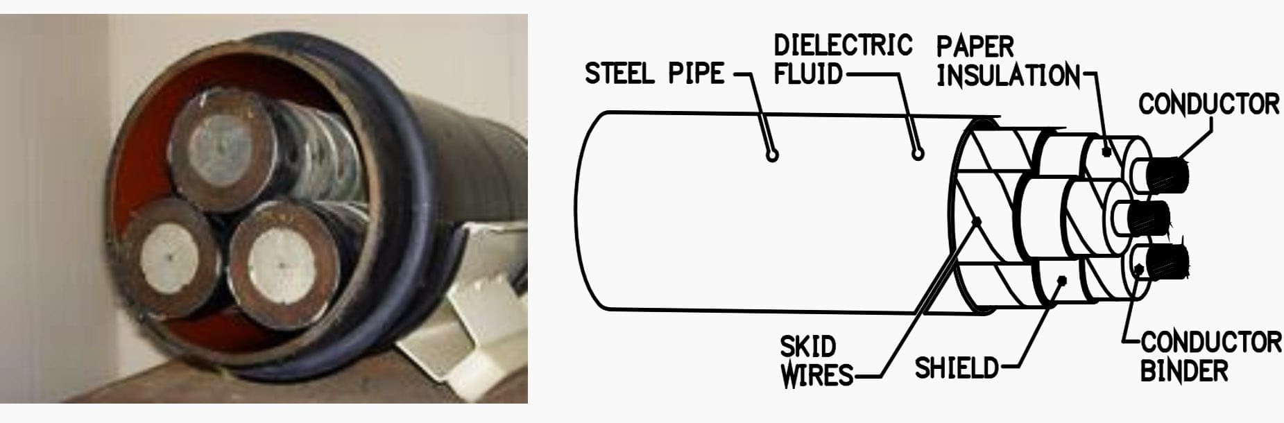

The three insulated conductors are housed in a steel pipe which is filled with liquid and maintained under high pressure, typically 14 bar (See fig. 1). The conductor, both copper and aluminium material is used, can be designed for a maximum cross section area of approximately 1250 mm2.
The insulation material is impregnated paper. The pipe is coated externally to prevent corrosion. The permittivity, dielectric loss angle and thermal resistivity of the dielectric are essentially the same as for SCFF cables.
The cable capacity can be increased by pumping oil through a heat exchanger or a refrigeration unit.
High Pressure Fluid Filled Cable (HPFF)
Figure 1 – High Pressure Fluid Filled Cable (HPFF)
Alternatively, the pipe may be pressurized with nitrogen. This type of construction is called High Pressure Gas-Filled (HPGF) cable. However, this kind of high pressure cables is limited to a maximum voltage level of 138 kV.
The presence of the steel pipe will have an impact on the zero-sequence impedance of the cable. The permeability of the steel will depend on the magnitude of the zero-sequence current and the zero-sequence impedance will vary with the permeability of the steel.
The steel pipe can be driven into saturation which will cause a non-linear relationship between the current in the conductors (including the steel pipe) and the voltage drop along the conductors.

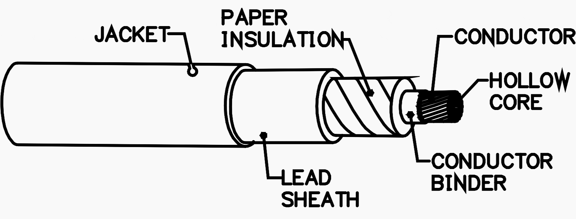

SCFF standard design consist of copper or aluminium conductor, paper insulation and an aluminium or reinforced lead sheath designed to withstand an internal pressure of up to 5.25 bar, with transients up to 8 bar (see fig. 2).
The cable is filled with fluid. Special tank architecture must be provided for fluid expanding due to temperature rises during load or short circuit conditions. To ensure a full impregnation at all time the core of the cable must be hollow.
This allows fluent fluid during temperatures changes while current level variations.
SCFF Cable
Figure 2 – SCFF Cable
The normal size range of the core is from 120 to 2500 mm2 for single core cable, and from 120 to 630 mm2 for 3-core cable. For application with voltage levels higher than 150 kV only single core cables are available.
Paper is lapped outside the conductor. Thicker paper is an advantage for mechanical strength. However, thinner paper gives the best electrical strength. Therefore different paper sizes will be used. Paper with a thickness of 75 µm are used around the core where the electrical stress is highest, paper with a thickness of 125 – 200 µm is used further out from the core to obtain the necessary mechanical strength.
Due to increased dielectric loss with higher voltage levels the maximum current ratio decreases accordingly. Therefore a new insulation material, paper laminated with polypropylene (PPL), has been developed. This material ensures less dielectric loss and is economical for voltages from 275 kV and upward.
Traditionally all SCFF cables were designed with lead sheaths. Today a significant number of these cables are sheathed with aluminium material. This has mainly economic reasons – there is no influence to the cable behaviour.

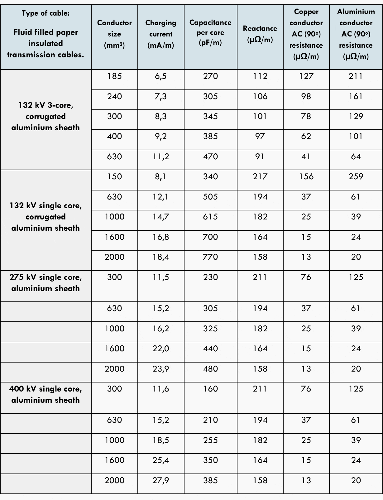

Table 2 – Typical values for cables direct laid with depth 900 mm, flat formation (single core) spacing 230 mm between Centers. Ground temperature 15o° C. Soil thermal resistivity 1.2 k m/w. Conductor operating temperature 90o° C.

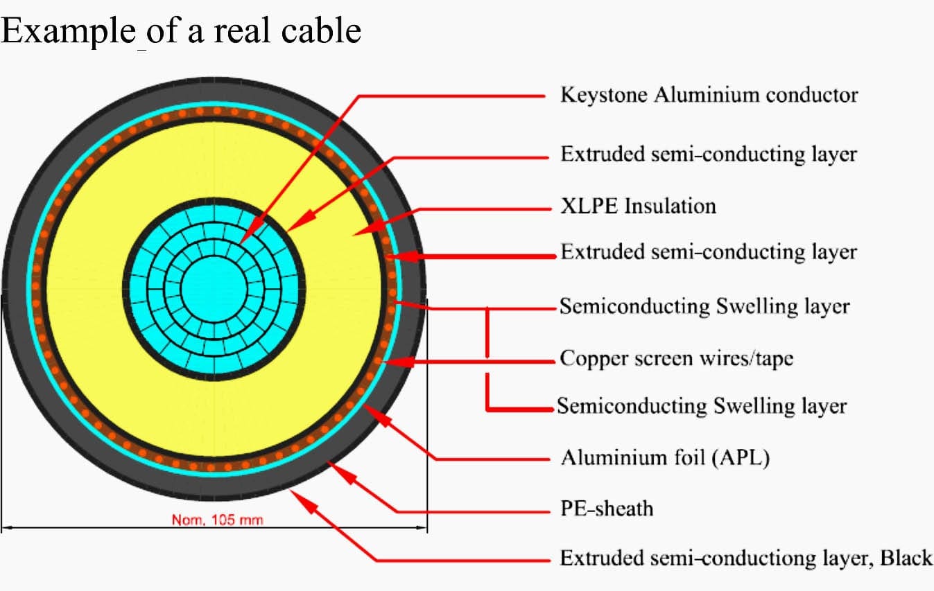

XLPE have an advantage over PE as it can be operated at 90° C compared to 70° C for LDPE (Low density Polyethylene) and 80° C for HDPE (High density Polyethylene). Composition of a typical XLPE cable (see figure 3):
Figure 3 – Composition of a typical XLPE cable
The cable is composed of:
  • Conductor – copper or aluminium.
  • Semi-conductor layer around the conductor to provide an uniform electric field.
  • XLPE insulation.
  • Metallic sheath composed of a copper wire screen and an aluminium, copper or lead sheath. The purpose is to protect conductor and insulation against external damage. It acts as an electrical screen and also conducts the fault current to earth in case of an internal fault.
An example is shown in figure 4 below.
