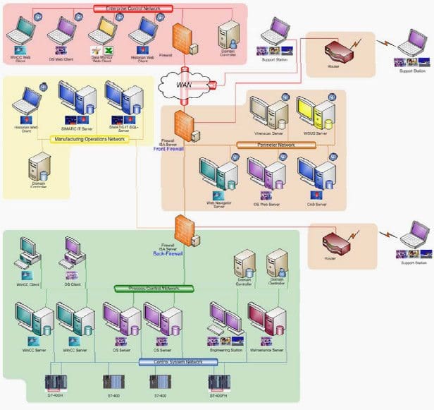

Networks at a High Security Site
According to the Siemens documentation, the high security site is separated into at least four security zones as illustrated in Figure 4:
  • The pink “Enterprise Control Network” zone is the corporate network, which hosts most business users and business accounting and planning systems, such as Enterprise Resource Planning (ERP) systems. The Enterprise Control Network may itself be separated into additional sub-networks, each with their own protections. Such segmentations and protections are typically established and managed by the corporate IT group.
Figure 4: The Hypothetical ICS Network Architecture
  • The yellow “Manufacturing Operations Network” zone hosts the SIMATIC IT servers, which exchange information between the control system, the ERP system, and other important applications on the Enterprise Control Network.
  • The brown “Perimeter Network” zone hosts servers that manage equipment in the control system, and servers that provide information to end users on the Enterprise Control Network. This is a common location for servers responsible for providing software patches and updates, including Windows security updates and anti-virus updates. Many of the servers within this zone provide information to end users via web servers and web services. People sometimes refer to this zone as a “demilitarized zone” or DMZ.
  • The green security zone hosts two networks: the green “Process Control Network” and the blue “Control System Network.” The Process Control Network hosts the 24×7 plant operators on their Human Machine Interface (HMI) workstations, and is also connected to the WinCC/PCS 7 control system servers. The Control System Network is connected to a number of Programmable Logic Controllers (PLCs) and is also connected to the WinCC/PCS 7 control system servers.
In a large facility, there are frequently multiple “green” zones, one for each control center or operating area. For example, a large chemical plant may have as many as twenty or thirty operating areas, each with their own SIMATIC PCS 7 system, and each controlling a large portion of the facility with both input and output storage facilities to help decouple operational disturbances between areas. These areas are able to operate independently of other portions of the large facility for some period of time. The facility may have many control rooms and corresponding server rooms, each hosting one or more control centers or operating areas.
The corporate wide area network (WAN) connects sites to one another, and connects different kinds of security zones within sites. Corporate IT manages the various enterprise networks and the corporate firewalls which protect enterprise network segments.
Note that while the Process Control Network and the Control System Network are different networks, they are both in the same security zone. WinCC and PCS 7 control system servers have at least two network interfaces, one for each kind of network. The two networks are separated for performance and technological reasons, not security reasons.
In other words, the Control System Network is dedicated to traffic specifically related to “automation” and “control” such as traffic to/from process controllers/PLCs and servers, while traffic on the Process Control Network is utilized for “information” and “display” such as that between HMI’s and servers.
