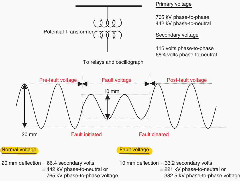

3. Voltage Reduction During Faults
Figure 1 depicts how an oscillogram can be used to determine the normal operating voltage and the voltage reduction during a fault. In this figure there are two cycles of prefault voltage, two-and-a-half cycles of reduced fault voltage and then voltage recovery to normal voltage after the fault is removed.
In the actual oscillogram, the trace would continue to the end of the record, which is normally set for 60 cycles.

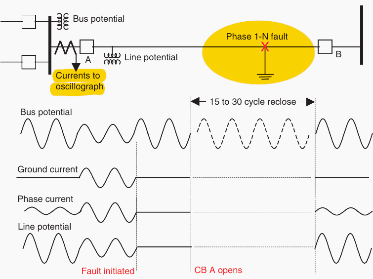

5. Phase-to-ground Fault and Successful High-speed Reclose
Figure 3 depicts a successful high-speed reclose (HSR) of circuit breaker (CB) A following a phase-to-ground fault on line A–B. Note that both bus and line potentials are recorded. This is very useful and common.
Since most faults are line faults, the bus potential would be a continuous trace, although the magnitude would be reduced during the fault. This provides a convenient timing trace. Referring to the figure, note that the line potential trace goes to zero when circuit breaker A opens but the bus potential trace continues and allows us to determine the HSR time.
Before the fault there is no ground current (or a very small amount depending upon the system unbalance), load current and normal line and bus potential. After the fault, the ground current increases and the line and bus potentials decrease. When circuit breaker A opens, all line parameters go to zero while the bus potential returns to normal. When circuit breaker A recloses, if the fault no longer exists, the line current and voltage traces return to their prefault values.
In actual oscillograms, such as those in the literature,2 the information shown during the transition from prefault to fault, during the ‘dead time’ and after the reclose can be very significant.

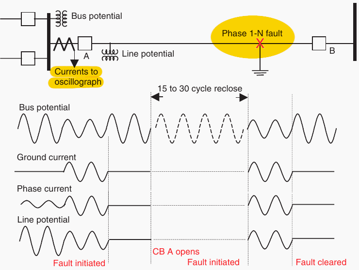

6. Phase-to-ground Fault and Unsuccessful High-speed Reclose
Figure 4 depicts the same situation as Figure 3 except that the fault is not temporary and reappears when the line is re-energized. The reclose is, therefore, unsuccessful and the line trips out again. The traces after the reclose are a repeat of the initial fault.
Figure 4 shows a typical switching transient in the bus potential trace.

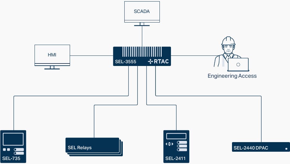

Proactively Monitor Substation Assets
The RTAC logic engine not only executes essential DFR activities but also facilitates advanced monitoring of substation assets, including CTs, PTs, and networks. Custom logic can also be configured to facilitate applications such as monitoring circuit breaker wear.
Measure Energy With Greater Precision
Conventional phasor-based measurements depend on steady-state conditions. SEL’s industry-exclusive energy packet technology accurately measures energy flow under all system conditions, irrespective of frequency, angle, or distortion.
Utilize the RTAC logic engine to process Axion Wave Server samples for the calculation, streaming, and recording of energy packets.

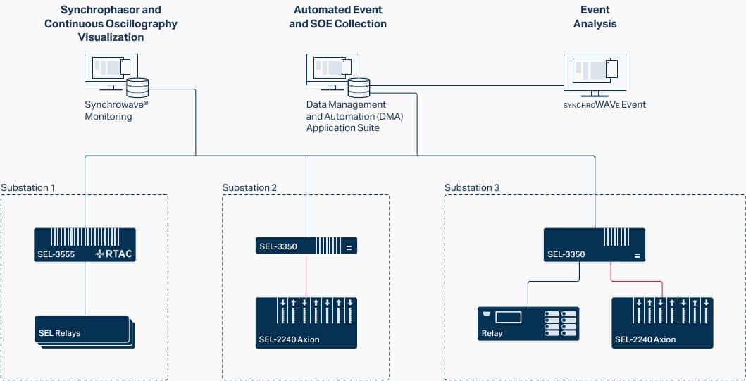

Figure 12 – Integrated DFR solutions
Integrated DFR solutions use the RTAC to collect event reports and SOE data from IEDs and continuously record dynamic disturbance data streamed by IEDs.
Refering to Figure 12, integrated DFR solutions use the RTAC to collect event reports and SOE data from IEDs and continuously record dynamic disturbance data streamed by IEDs. Leverage existing systems with SEL relays and other IEDs to perform dynamic disturbance and fault recording that exceeds standards such as NERC PRC-002.

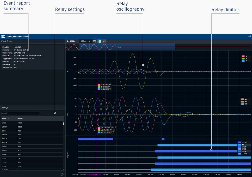

Integrate historical synchrophasor data, continuous waveform streams, and event reports into a single display for a comprehensive disturbance monitoring system. Automatically identify system disturbances and export data in CSV and COMTRADE formats to facilitate compliance with NERC PRC-002-2, PRC-0028-1, and IEEE 2800 standards.

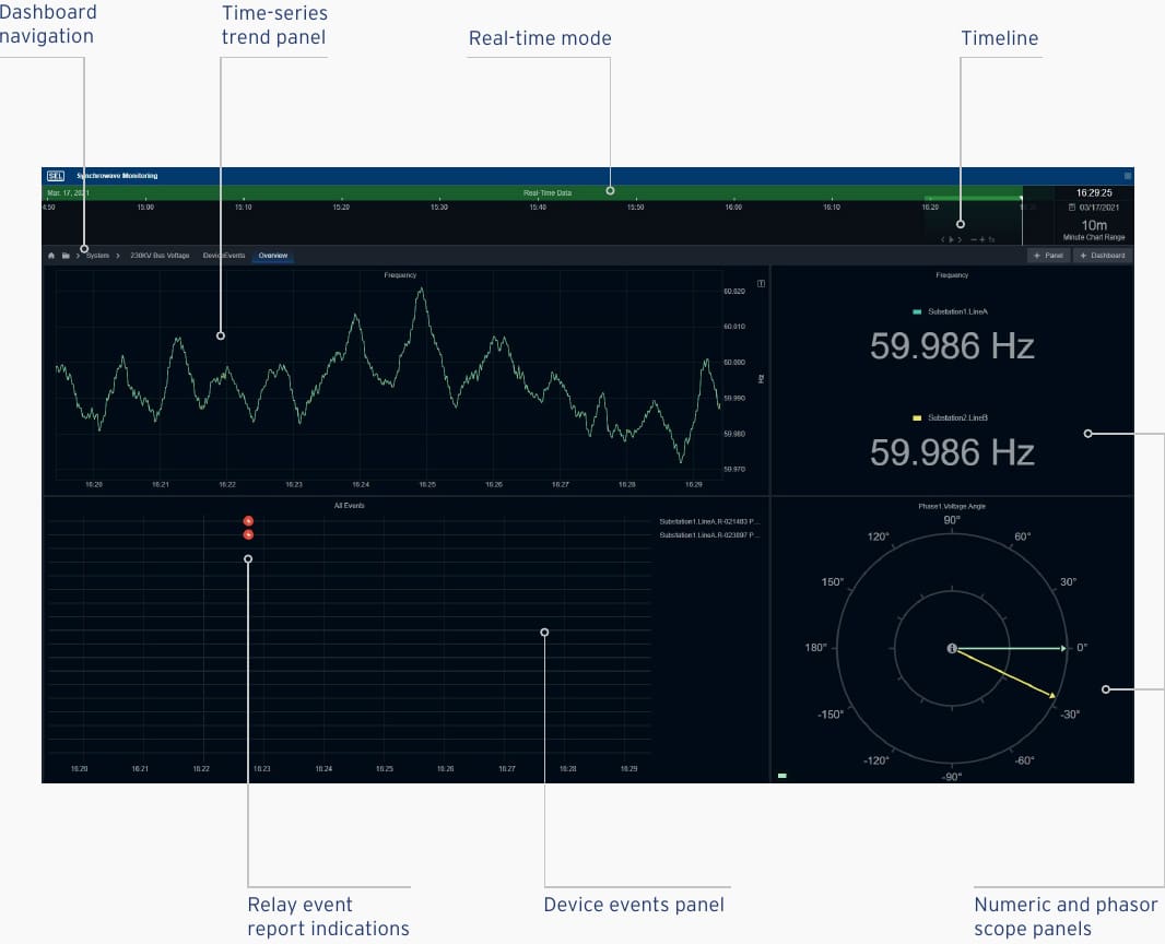

See the Real-Time System State
Improve system visibility by viewing live and time-aligned information from across the entire power system. Acquire further understanding of the power system’s dynamic behavior through waveform fingerprints to facilitate analysis under abnormal conditions.
Figure 13 – User Interface of Synchrowave Monitoring software
