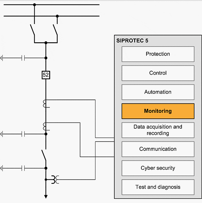

2.4 Self-monitoring and external circuit monitoring
IEDs have card-level diagnostic capabilities for internal problems, with a self-monitoring software, which can detect up to 98% of the problems, such as hardware failure, memory failure, and power supply problems.
Modern IEDs, in addition to the internal monitoring, have capabilities for interface monitoring and external circuit monitoring.
Interface monitoring includes checking the inputs to the IEDs and can be verified by simple methods. For example, the input currents to the relay from the three phases should add up to three times the neutral current if any. If there is any deviation, the analog channel of any of the currents could be faulty. The relay can block the false tripping.
External circuit monitoring will include monitoring of the circuit breaker coil for any interruption in the trip-close path and can also indicate an instrument transformer failure.
Figure 4 – Self-monitoring and external circuit monitoring
Modern protection relays are equipped with many monitoring procedures. These detect faults, internal as well as external, in secondary circuits, store them in logs, and report them. This information is used to record the device fault and helps to determine the cause of the error in order to take appropriate corrective actions.
