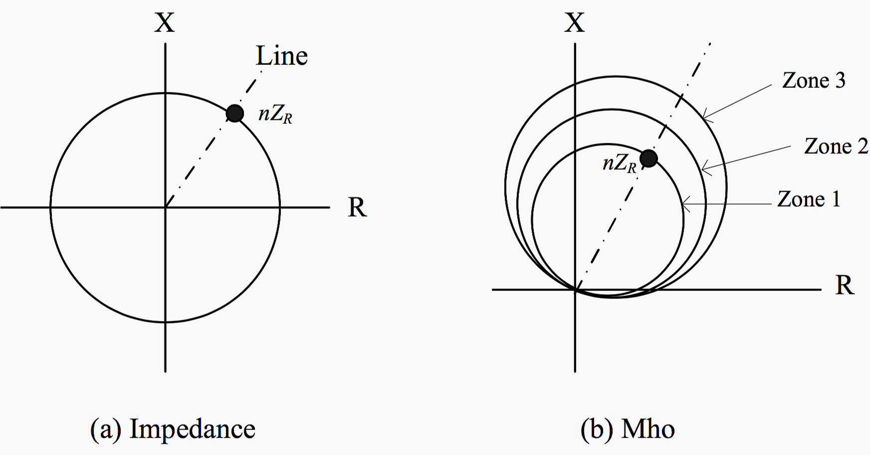

2. Transmission line protection
Transmission lines can be protected by several types of relays, however the most common practice to protect transmission lines is to equip them with distance protective relays. Distance relays are designed to respond change in current, voltage, and the phase angle between the measured current and voltage.
The operation principle relies on the proportionality between the distance to the fault and the impedance seen by the relay. This is done by comparing a relay’s apparent impedance to its pre-defined threshold value.
Distance relays’ characteristics are commonly plotted on the R-X diagram are shown in Figure 2a whereas Figure 2b represents the Mho relay which is inherently directional.
Distance relay characteristics
Figure 2 – Distance relay characteristics
As an illustration in conjunction with the figure, suppose a fault arose, the voltage at relay will be lower or the current will be greater compared to the values for steady state load condition. Thus, distance relays activate when relay’s apparent impedance decreases to any value inside the parametric circle.
For this reason, the impedance of the line after the fault can also be used to find the location of the fault.
Like several engineering constructs, a backup is employed for redundancy. A minimum of two zones are necessary for primary protection of distance relays to address the faults at the far end of the protected line section near the adjacent bus.
Such a criterion provides a safety factor to ensure that any operation against faults beyond the end of a line will not be triggered by measurement errors. Several protection zones can be built by using separate distance measuring units, which provided redundancy since both distance units will operate for faults occurring in Zone 1.
The key difference between the two redundant units is in the time delay. The unit covering Zone 1 would operate instantaneously whereas the unit designated in Zone 2 would have an added time delay between fault signaling and operation. Also, by modifying either the restraint and/or operating quantities, the relay operating circles can be shifted as shown in Figure 2b.
In some applications, a further setting (Zone 3) is included, which is greater than Zone 2 setting. For a fault generated in Zone 1, Zone 3’s operation occurs after a longer time delay than that associated with the Zone 2. Therefore, the delay acts as a temporal tolerance for the protective schemes within the fault zone.
The delayed operation will trigger if the tolerance is exceeded.
Hence, this setting provides a form of back up protection. Figure 3 depicts protection zones of distance relays.
Typically, Zone 1 is set in range of 85% to 95% of the positive-sequence of protected line impedance. Zone 2 is set to approximately 50% into the adjacent line, and 25% into the next two lines for Zone 3 as described in. The operation time for Zone 1 is instantaneous whereas Zone 2, and Zone 3 are labeled T2 and T3, respectively.
Protection zones of distance relays
Figure 3 – Protection zones of distance relays

  4. Manuel Bolotinha
    Sep 05, 2016
    Distance propection only is efficient for long overhead lines.
    The distinction between “short” and “long” overhead lines is based on a comparison between the inductance and the resistance and capacitance of the overhead line.
    When both resistance and capacitance are negligible when compared with the inductance, the over head line is considered “short” (usually l ≤ 80-100 km).
    For short lines differential protection with pilot wires is more efficient.
    By contrast, distance protection with polygonal impedance characteristics are highly flexible in terms of fault impedance coverage for both phase and earth faults.
    For this reason, nowadays most distance relays offer this form of characteristic.
