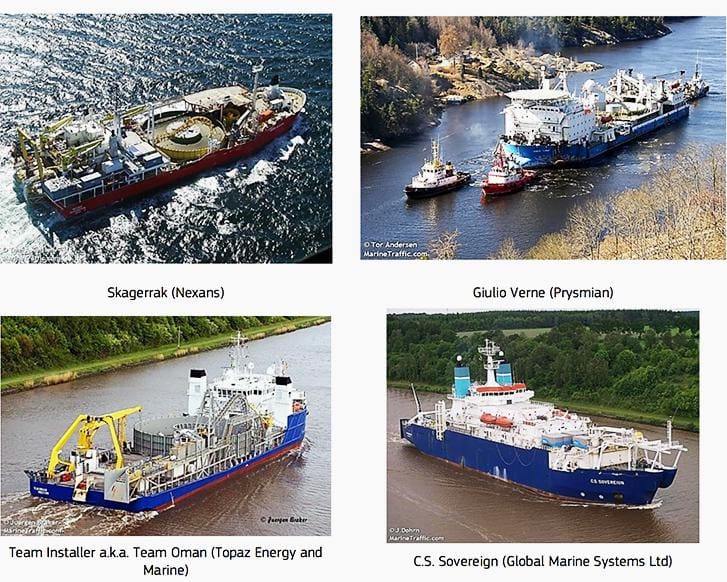

Laying down the transmission cable on the seafloor is done by specialized vessels (Fig. 1). The most active vessels used for such operations are: Skagerrak (owned by Nexans), Giulio Verne (Prysmian), Team Installer (Topaz Energy and Marine) and C.S. Sovereign (Global Marine Systems Ltd). They are all equipped with a turntable for at least 4000 tons of cable and have the appropriate gear to handle it.
Specialized vessels for cable laying at sea; owner mentioned in brackets
Figure 1 – Specialized vessels for cable laying at sea; owner mentioned in brackets

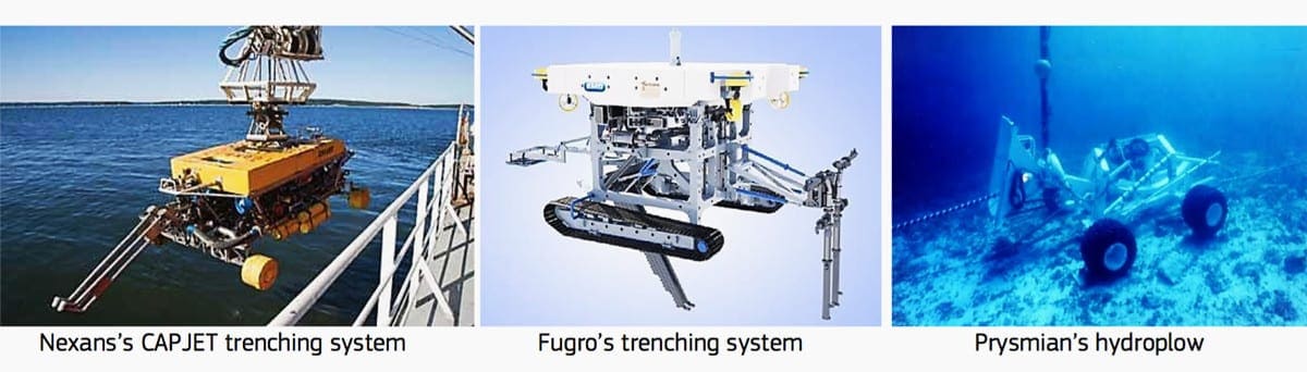

The ROVs dig the trench in which the transmission cable is laid (Fig. 3 and Fig. 4), fix the cable on the right route and cover the cable with sediment. Burying the cable in the seabed is a slowly and costly operation but it is paid back by its reliability and extended lifetime.

Various types of Remotely Operated Vehicles (ROVs)
Figure 4 – Various types of Remotely Operated Vehicles (ROVs)
