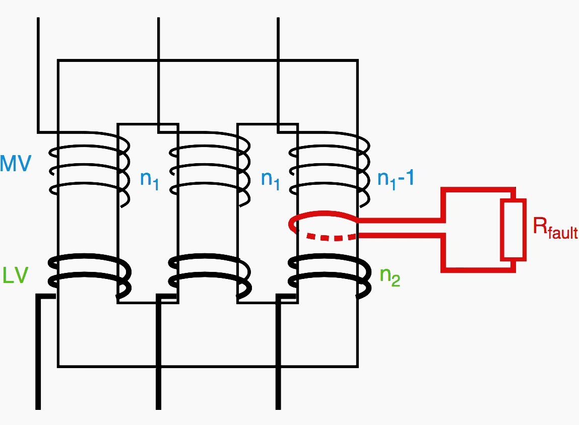

1. Faults between turns
Faults between medium voltage winding turns are the most frequent failure mode as well as being the most difficult to detect.
They result from the localized deterioration of conductor insulation, due to thermal or dielectric stresses. The initial effect is limited to a slight increase in the primary current, due to the modification of the transformation ratio on the one hand and the appearance of a short-circuited turn phenomena on the winding concerned.
This faulty turn behaves as a secondary winding and is the seat of a current limited solely by its own impedance and the resistance at the point of fault (see figure 1).
Functioning of a transformer with a short-circuited turn in the primary
Figure 1 – Functioning of a transformer with a short-circuited turn in the primary
According to the current that passes through this turn, the progression of the fault will be more or less rapid. In the case of high currents, the local temperature rise will lead to the deterioration of the neighboring turns and the fault will quickly spread.
The order of magnitude corresponds to approximately one hundred times the rated current or around 1 kA for the primary winding of a transformer of 400 kVA under 20 kV!
In any case, the presence of local arcing will lead to a gaseous release, whether or not the transformer is of oil filled or dry type. This release can lead to a large increase in pressure, until part of the structure ruptures (tank or solid insulation).
If the fault causes a low primary current, the phenomena can be slow and difficult to detect through monitoring of the supply current. Laboratory tests on oil filled transformers have shown current of between 1 and 6 times the rated current, accompanied by large gaseous release, for faults involving up to 8 % of the primary turns.
This is why monitoring of gaseous emissions or pressure can be used in a complementary manner to protection devices based on current measurement.
