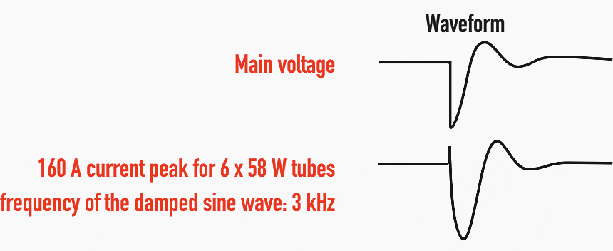

This type of disturbance is often accompanied by an overcurrent on the line concerned and emission of magnetic and electric fields.
160 a current peak for 6 x 58 W tubes frequency of the damped sine wave: 3 kHz
Figure 2 – 160 a current peak for 6 x 58 W tubes frequency of the damped sine wave: 3 kHz

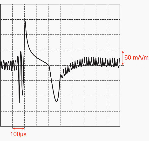

Due to the size of the LF transient current (10 kHz < f < 1 MHz) on closing, the radiated impulsive magnetic field can reach high values that may disturb sensitive products. If the overcurrent involved is high (several kA), the damped oscillatory magnetic field caused by the disturbance can be simulated in order to check the immunity of sensitive products.
A magnetic field is generated when the current is established
Figure 3 – A magnetic field is generated when the current is established

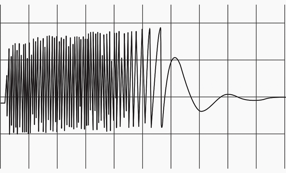

Although closing operations are accompanied by high overcurrents and generally limited overvoltages, opening operations trigger overvoltages than can be very high. They can be accompanied by high frequency electric fields that could cause disturbances.
The phenomenon of resonance plays a major role here. Breaking the current in an electric contact generates damped oscillations at the resonance frequencies of the source and the load. The resonance frequency of the source is very often higher than that of the load.
Transients caused by the load and the source are superimposed, leading to high voltage levels at the terminals of the electric contact. If they exceed the voltage withstand of the contact, an electric arc is created. A voltage collapse is then observed at the terminals, while the current continues to circulate (this is referred to as non-limiting self-extinguishing current). The arc ends when the electrical and thermal stresses on the contact are not sufficient to maintain it.
The voltage transients during the switching phase oscillate at frequencies between 10 kHz and 10 MHz. The peak voltages of these transients range from a few hundred volts to several kilovolts.
The voltage / frequency parameters change inversely during the switching phase on opening: at the start the peak voltages are of small amplitude but have a high frequency, while at the end the amplitude is large but the frequency is lower. The duration of these burst voltage transients ranges from 20 µs to ten or so milliseconds. It depends on the load, the mechanical behaviour of the contact (switching speed) and the environment (temperature and pollution).

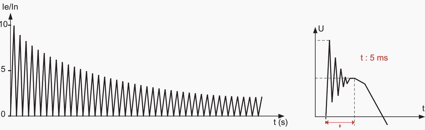

Transient states, which may be the source of overvoltages and overcurrents, can occur when loads are switched on or off. the most common transients concern transformers, motors, capacitors and batteries.
Activating a transformer causes an inrush current
Figure 5 – Activating a transformer causes an inrush current
Activating a transformer causes an inrush current of 10 to 20 In with a damped aperiodic component. this triggers an overvoltage in the secondary by capacitive coupling, and oscillatory effects due to the capacitances and inductances between the turns.
The breaking (or opening) of a transformer creates a transient overvoltage due to the breaking of the current in an inductive circuit. this overvoltage can create arc restrikes in the breaking devices, which must be chosen accordingly.
Overvoltage when breaking a transformer
Figure 6 – Overvoltage when breaking a transformer

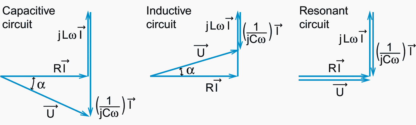

In a capacitance C, the current is in π/2 phase lead in relation to the voltage (lead quadrature) in an inductance L, the current is in π/2 phase lag in relation to the voltage (lag quadrature).
The circuit is capacitive or inductive, depending on the respective values of C and L. The electrical resonance phenomenon (also called anti-resonance in that the voltages are in anti-phase) occurs if the voltage at the terminals of the capacitance and those at the terminals of the inductance compensate one another exactly.
Lω = 1/Cω which can also be written LCω2 = 1.
ω is the resonance angular frequency, which is generally written 0 and the resonance frequency f0 is equal to ω0/2π.
When there is resonance, the impedance of the circuit is practically the same as its resistance R. If the resistance is low (low resistance circuits such as distribution lines), the situation becomes critical.
Capacitive, inductive, and resonant circuit vectors
Figure 8 – Capacitive, inductive, and resonant circuit vectors
The voltage applied at the terminals of the circuit then creates a very high current. this current then imposes voltages UC and UL at the C and C terminals, which may exceed their withstand and cause dielectric breakdown.

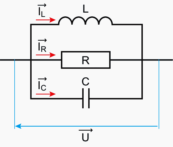

1.3.2 Resonance of a parallel RLC circuit
The same phenomena occur on parallel RLC circuits. But in this case it is not the current which is common to all three elements, but the voltage U.
Figure 9 – Resonance of a parallel RLC circuit
The effects of the resonance differ according to whether it is series or parallel, and depending on whether the source behaves like a voltage source or a current source.
An ideal voltage source maintains a constant voltage at its terminals irrespective of the current drawn. For small or medium sized consumers, the distribution supply network behaves like a voltage source. a high capacitance behaves like a voltage source for a reduced load (high resistance).
On the other hand, a current source draws a constant current irrespective of the voltage at its terminals. for example, an inductance (known as a smoothing inductor) behaves like a current source.
In practice, industrial systems are complex and comprise both parallel and series elements (these are the receivers and also the conductors, the transformer windings, the stray capacitances, the leakage resistances, etc.) which represent both inductances and capacitances.
It is thus always possible that resonance may occur, and adding compensation capacitors may modify or trigger the conditions for their occurrence.

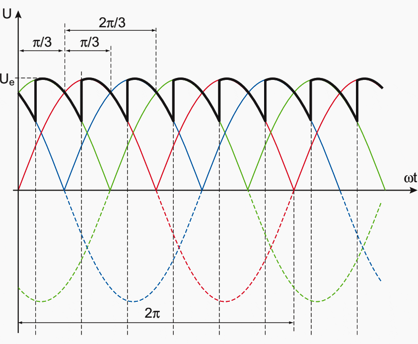

Thyristor bridge rectifier at the input of a conventional AC/DC converter
Figure 10 – Thyristor bridge rectifier at the input of a conventional AC/DC converter
A three-phase sinusoidal voltage is generally rectified using a thyristor bridge. The load current is drawn at the three phases by alternate operation of the thyristors. These are “trigged” in succession by the thyristor that was in control in the preceding time phase sending a pulse to their gate.
The result is periods, which are of course very short (a few hundred µs), in which short-circuits occur between phases.

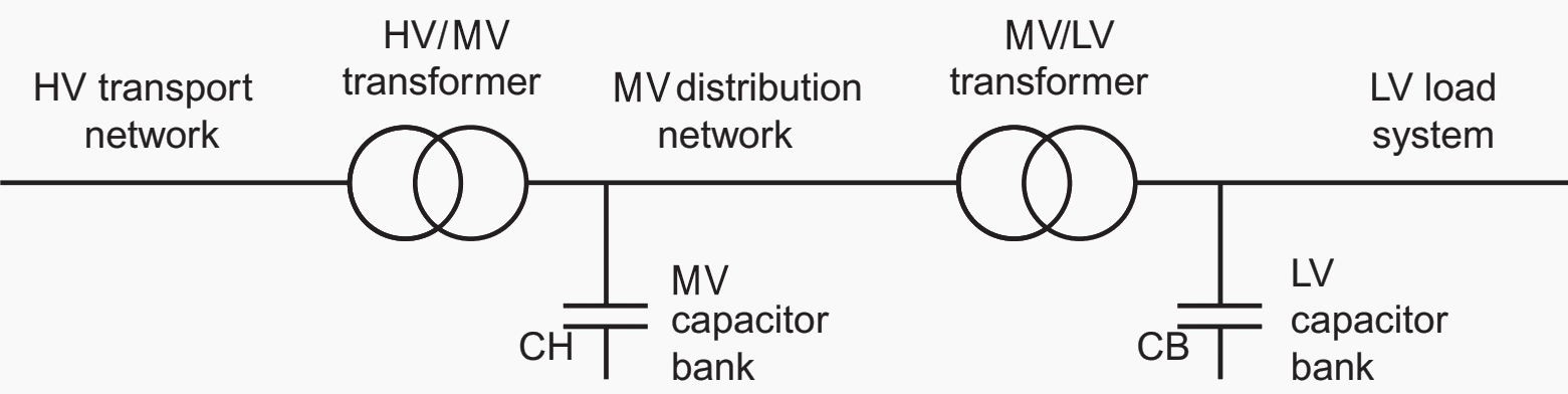

The activation of capacitors placed on the MV system may cause transient overvoltages (several times the value of Un) with sufficient energy to destroy the voltage surge protectors at the supply end of the low voltage installation or even the components of the static converters or reactive energy compensation capacitors.
This phenomenon may be particularly dangerous if, when the MV capacitors are activated, the resonance frequency of the upstream circuit corresponds to the resonance frequency of the LV circuit.
The characteristics of this phenomenon are essentially linked to the inductance L of the MV/LV transformer, the capacitance C of the capacitors and the resistance R of the low voltage network. If the resistance is low (not many resistive receivers), the damping of the transient overvoltages will be reduced, increasing the risk of resonance on the MV and LV circuits at the same frequency.
Switching overvoltages of capacitors
Figure 13 – Switching overvoltages of capacitors
Amplification of the disturbance associated with MV capacitor switching is particularly sensitive if the reactive power used in MV is much higher than that used in low voltage. This risk can be limited by using capacitor banks that are activated gradually (steps) or by activation at zero voltage.
High energy absorption (at least 1 kilojoule) voltage surge protectors can be used to limit transient overvoltages from the MV system, in the same way as tuned filters with low voltage capacitor banks can shift the resonance frequency of the installation.
Overvoltages from the MV system will not be eliminated, but at least they will not be amplified.

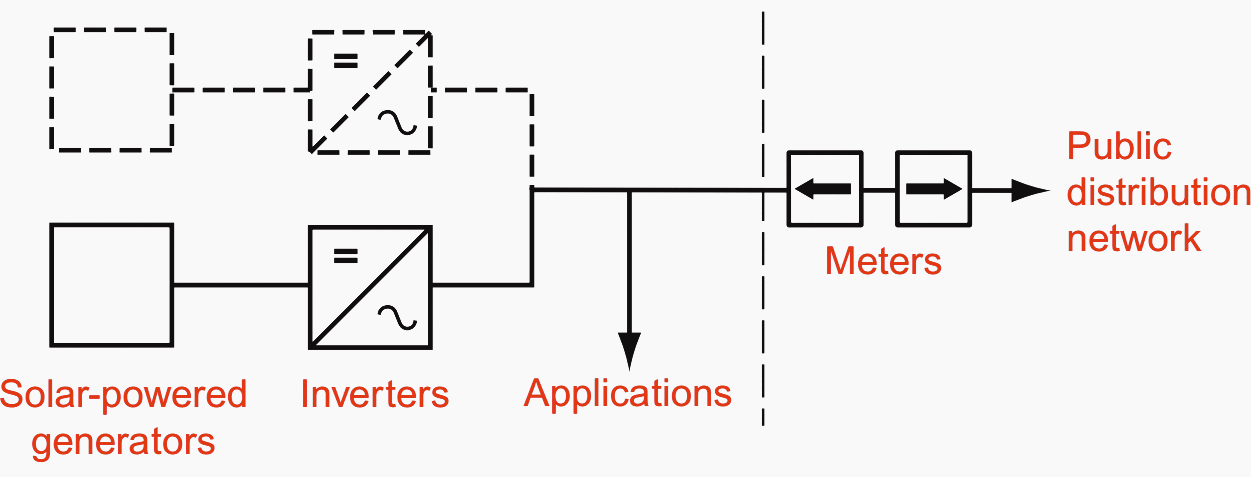

6. Current inversion
Any installation connected directly to a public energy distribution system and that may also be supplied via another source should normally incorporate a device to prevent backfeed of the distribution system.
Increasing numbers of installations are carrying out self-generation based on renewable energies (solar or wind-powered production, small power plants or other sources) and are connected to the supply network to feed energy back into it.
This arrangement must of course form the subject of an agreement, as well as a number of precautions.
Current inversion arrangement
Decoupling protection must disconnect generators if the following occurs:
  • Fault on the supply network
  • Disappearance of the power supply via the supply network
  • Voltage or frequency variations greater than those specified by the distribution company
This decoupling protection must be incorporated in an automatic breaking device that complies with a recognised European standard.
