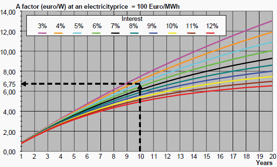

To make the capitalisation more attractive, so that the use of TCO is easier, we propose the use of a graph, shown in Figure 5, which allows determination of factor A.
Factor A expresses the relation between the cost of no load losses and the following:
  • Electricity price
  • Discount rate or company interest rate or average cost of capital
  • Capitalisation period or expected lifetime of the transformer
This example illustrates that for an electricity price of 100€/MWh, an interest rate of 5% and a 10 year capitalisation period, the cost of no load loss will be 6,75 € / Watt.
Factor A is directly proportional to electricity price so the A factor can simply be scaled to account for electricity price changes as long as the interest rate and capitalisation period remain unchanged.

It is important to note that, for small interest rates, a doubling of the capitalisation period will result in almost doubling the cost of losses. On the other hand, applying too high a capital rate, by making, for example, too high a provision for risk, will produce a low value of loss.
Factor B, as explained previously, is simply the product of factor A and the square of the loading factor. (B = A * (Loading)2) The loading factor used here is the expected average load over the life span of the transformer, possibly taking harmonics into account.
