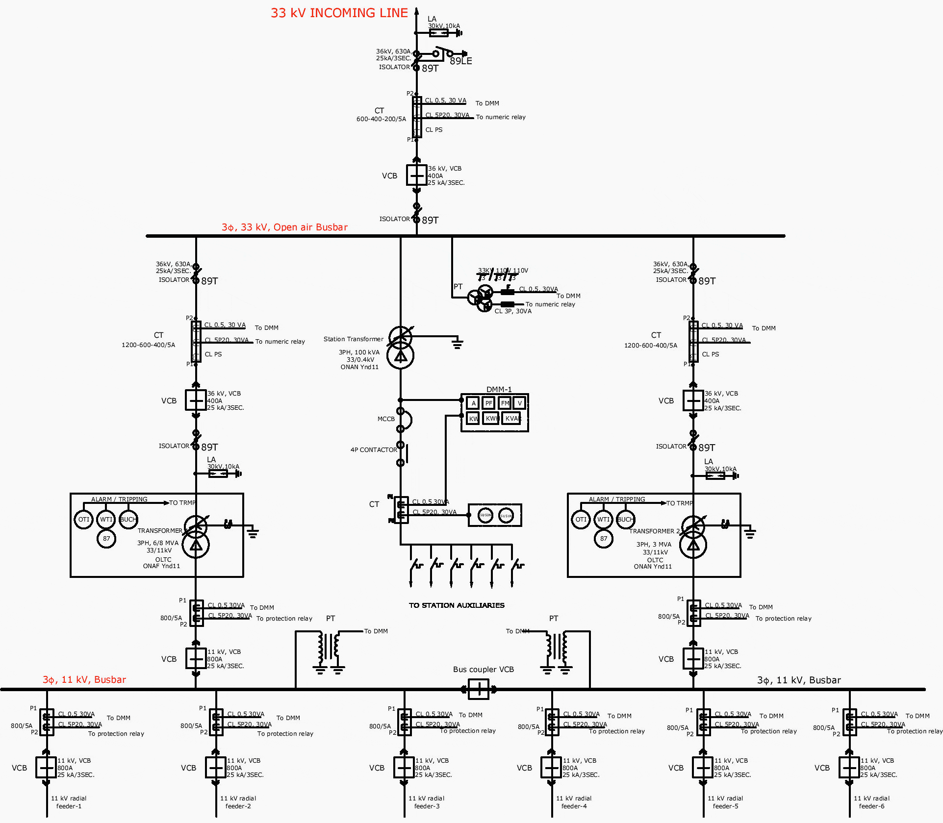

This article uses a 33/11 kV, 11 MVA power distribution substation for a case study. The substation is functional since 2001, and most of the design documents are misplaced already. Some equipment is replaced during multiple periodic and breakdown maintenance.
The single line diagram in Figure 2 provides most of the details required for the ETAP modeling of the substation for load flow and short circuit analysis. The analysis will serve as a reference to cross-check the operating condition for recent loading conditions obtained from the load curve data in the substation logbook.

3.1 Preparatory data for simulation
Figure 3 illustrates an ETAP model of the case substation of this article. A major factor for the accuracy of simulation output is the right selection of parameters and equipment, and the major focus should be to replicate the real-world case as far as possible.
In this case, the Short circuit MVA for the incoming grid is defined based on the capacity and percentage impedance of a power transformer in the source. The impedance of the transmission line from the source to the substation may or may not be included in the simulation.
Normally, to emulate the most pessimistic scenario, the designers and engineers can sometimes opt to neglect the impedance of the live parts like cable, line conductors, etc.
Figure 3 – ETAP simulation conversion of available SLD of the substation (click to zoom)
The sizing and ampacity of the busbar, breakers, switches, etc. are kept identical to the actual case. Likewise, the percentage impedance of power transformer and station transformer in the substation are of prime importance too, which can be obtained from datasheets of respective components.
