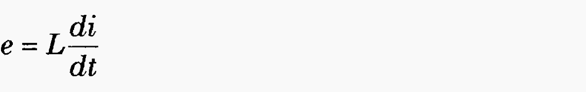

The alternating currents present in a transmission system are accompanied by alternating magnetic fields. The interaction of these magnetic fields between conductors in relative proximity creates a flux linkage. These changing magnetic fields induce voltages in parallel conductors which are equal to the time rate of change of the flux linkages of the line. This voltage is also proportional to the time rate of change of the current flowing in the line.
The constant of proportionality is termed as the inductance.
Inductance formulae

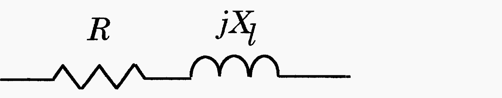

A transmission line with length less than 50 miles (80.5 km) is classified as being a short transmission line.
When power is transmitted along a short transmission line the difference in conditions at the sending and receiving ends is due to the series impedance of the line. The impedance is that of a series connection between a resistive and an inductive element shown in Figure 1, where VS and VR are the sending and receiving line to neutral voltages and IS an IR are the sending and receiving currents.
Short transmission line model
Figure 1 – Short transmission line model

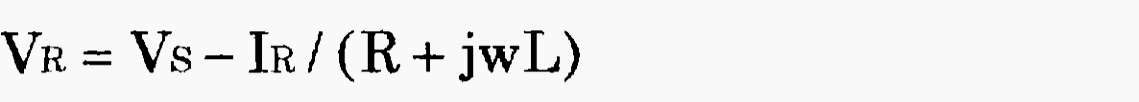

Since there are no shunt components:
Neutral currents formulae
Neutral voltages

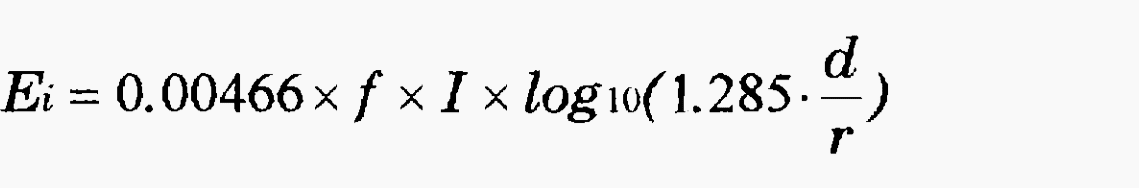

The induced voltage in the line is directly proportional to the current and will depend on the physical dimensions of the conductor. The value of this induced voltage, per mile, for a single conductor is given by:
Induced voltage per mile
where:
  • d is the distance between conductors
  • r is the radius of the conductor
  • I is the rrns amplitude of the current
  • f is the frequency of the current in hertz

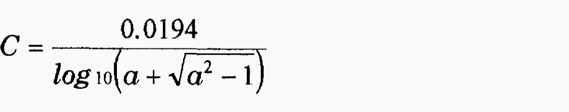

The line capacitance between two parallel cylindrical conductors given in micro Farads (μF), per mile, is:
Line capacitance
where a is the distance between the conductors divided by the diameter of the conductor.

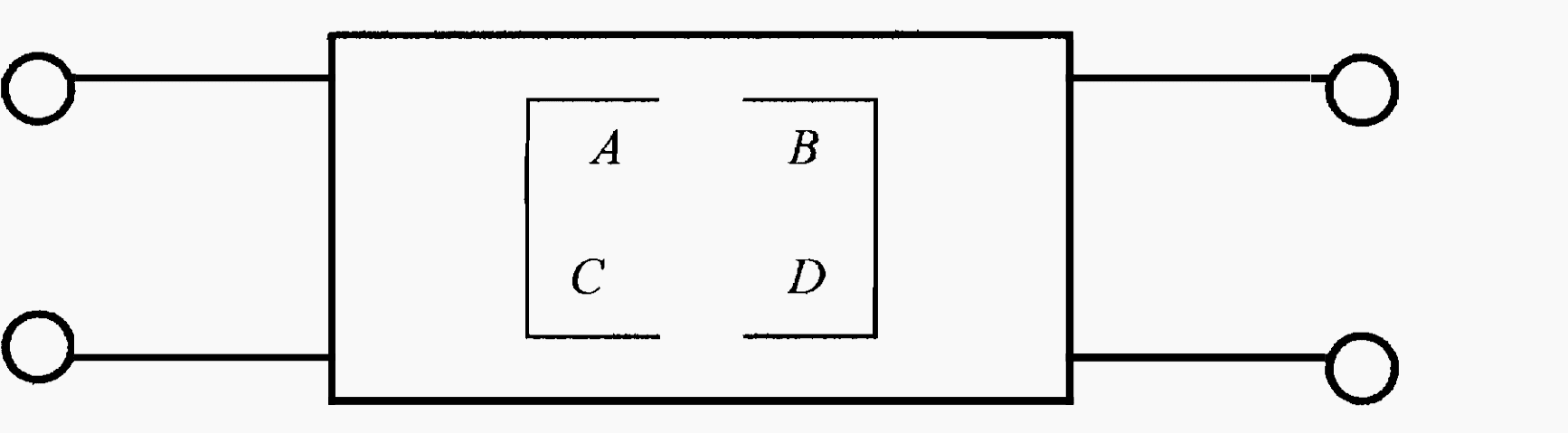

By modeling the line in this manner, the receiving end voltages and currents can be obtained using the lines ABCD parameters from a two port network shown in Figure 3 below.
Medium length transmission line model (nominal R equivalent circuit)
Figure 2 – Medium length transmission line model (nominal R equivalent circuit)
Lines ABCD parameters
Two port network and ABCD parameters
Figure 3 – Two port network and ABCD parameters

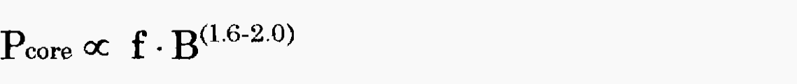

The core loss encountered is a transformer is expressed in terms of hysteresis and eddy currents. These two have a net loss that may be approximated as varying linearly with the frequency f, and having a nonlinear dependence on the flux intensity B of the core material.
Transformer core loss

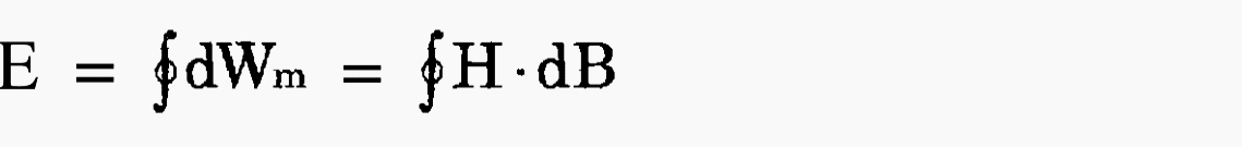

Hysteresis loss results from the unrecoverable energy expended to rotate the polarization of the core’s magnetic material. The energy loss per unit cycle is expressed as the area enclosed by the hysteresis loop.
Energy loss per unit cycle
The total hysteresis loss is the product of this area, the core volume, and the frequency. Eddy current loss is simply expressed as the I2R loss due to the currents induced in the magnetic material.
