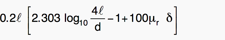

The self-inductance L (μH) of a conductor
The self-inductance L (μH) of a conductor of a length l is:
  • For a cylindrical conductor:
    The self-inductance L (μH) for a cylindrical conductor

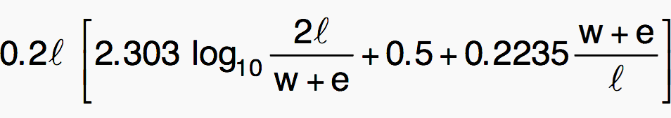

  • For a conductor with rectangular cross-section:
    The self-inductance L (μH) for a conductor with rectangular cross-section
Where l, d(diameter), δ, w (width), e (thickness) are expressed in meters.
