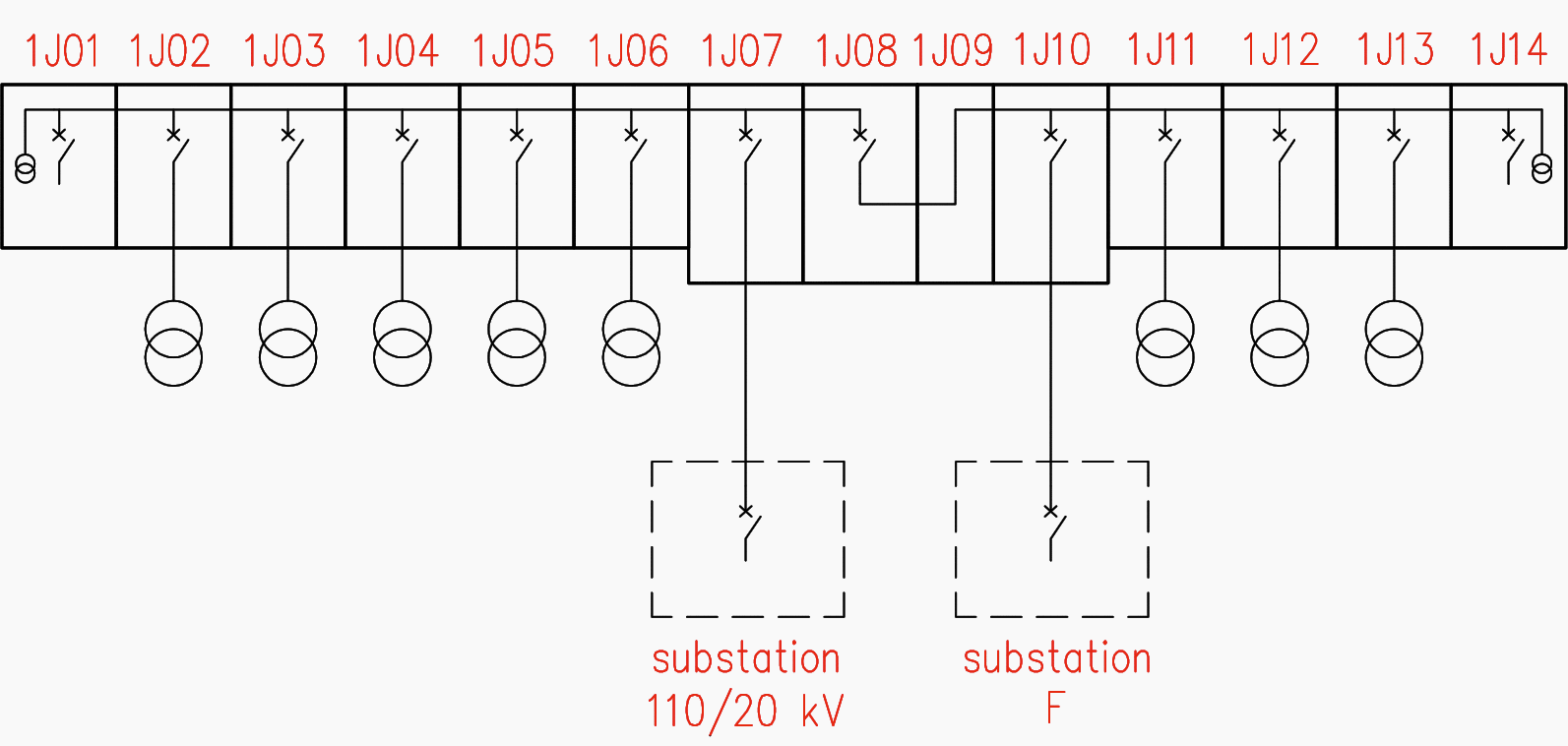

Block diagram of MV switchgear
Figure 1 – Block diagram of MV switchgear
Block diagram of MV switchgear can be seen in Figure 1. It can be supplied from two independent sources (substation 110/20 kV and substation F), that is why two incoming cubicles (1J07 and 1J10) are used. These two incoming cubicles cannot be active (closed) at the same time, i.e. parallel operation of two incoming lines is forbidden.
There are eight transformer cubicles (1J02 – 1J06 and 1J11 – 1J13), bus section cubicle (1J08), bus riser cubicle (1J09) and two spare/measurement cubicles (1J01 and 1J14).
Circuit breaker is used as major switching and protection device inside every cubicle. This is practically mandatory if selectivity and more complex protection functions need to be achieved inside larger MV supply system.
Principle and realization of earth fault protection
Every cubicle which contains the circuit breaker, except the one inside bus section cubicle (1J08), is equipped with protection relay and two types of current transformer: one for overcurrent protection, and other for earth fault protection. Incoming cubicles (1J07 and 1J10) are also equipped with current transformers for measuring. Voltage transformers are placed inside cubicles (1J01) and (1J14), at the end of both busbar sections.
Why there are exactly two voltage transformers for the whole switchgear?
In general, for MV applications, one voltage transformer per each section of mutually connected busbars is used. In our case, the switchgear can be supplied from two separate sources (substation 110/20kV and substation F) with bus section circuit breaker open.
