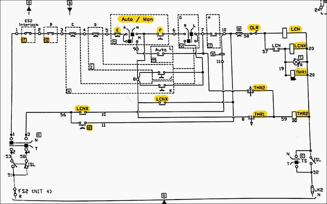

Circuit Diagram
Attached below is the simple DOL starter control circuit diagram of a motor. Let’s dissect the circuit diagram in detail,
Figure 1 – Simple DOL starter control circuit diagram of a motor (click to zoom)
Where:
  • Auto / Man – Auto/Manual Selector Switch
  • E – Stop Control Switch
  • F – Start Control Switch
  • OLR – Overload Relay Contact
  • f and g – Field Stop Interlocks
  • LCN – Main Power Contactor
  • LCNX – Auxiliary Contactor
  • TMR1 – Off-delay timer
  • TMR2 – On-delay timer
  • d – Test pushbutton

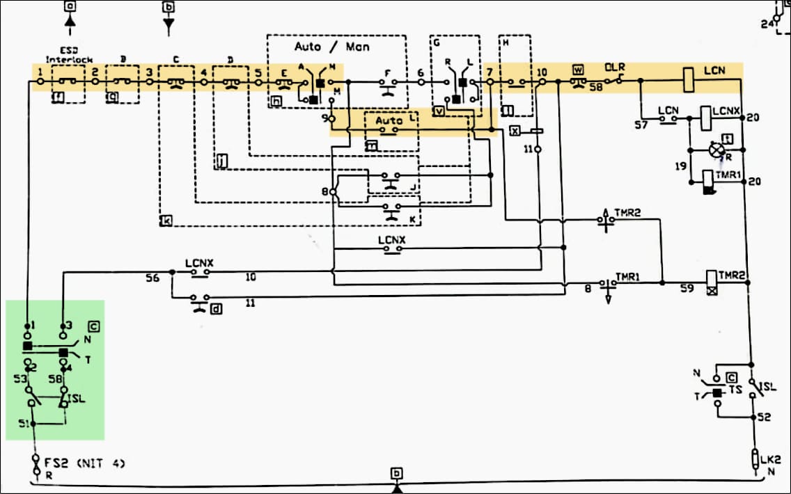

MCC Circuit on Auto-Mode
When the breaker is racked in as highlighted in green, the signal is passed through auto contact L to the main power contactor LCN of the motor. This closes the LCN contact thus energizing the auxiliary contactor LCNX and the motor starts.
The off-delay timer TMR1 is also energized at the same time, however, it doesn’t play any role in auto-mode.
Figure 2 – MCC Circuit on Auto-Mode (click to zoom)
Circuit on Manual-Mode
Now let’s understand the working on manual mode and re-closure relay functionality through the below circuit diagram. When the selection is on manual mode, the only thing stopping the motor from starting is “F” as marked in green, which is the start control station installed locally on the field.
Once the start control station “F” is pressed, the signal is passed and the main power contactor LCN latches, thereby, starting the motor.
