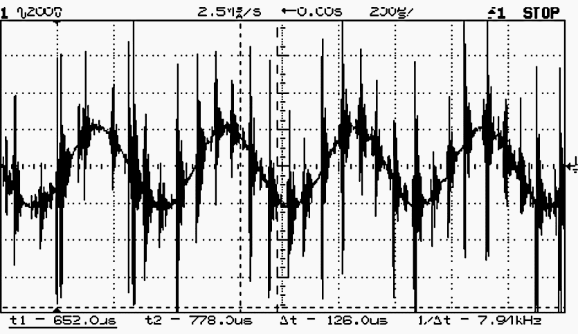

Low power, variable speed drives can create common mode noise on both conventional analog and HART signals, as seen in Figures 1 and 2, which are oscilloscope traces. What seems like noise are big spikes at high frequencies superimposed on otherwise smooth trace lines.
By the way, HART is a bi-directional communication protocol facilitating data access between intelligent field devices and host systems. HART is an shorten for Highway Addressable Remote Transducer.
Figure 1 – Common Mode Noise on an Analog Signal (Display A)

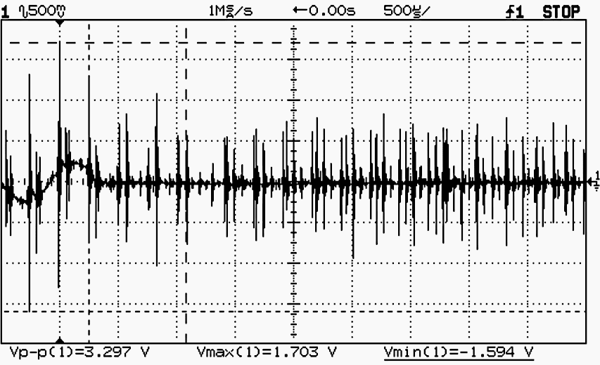

Figure 2 – Common Mode Noise on an Analog Signal (Display B)

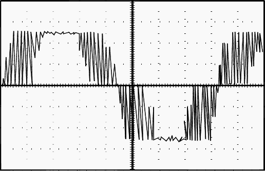

With noise superimposed, Figure 3 shows a typical inverter voltage output. Noise levels at the motor terminals and along the power line are conditional on a number of variables, including the length of the cable.
While each manufacturer’s waveform may look slightly different, all IGBT drives feature rapid rising times and corresponding noise.
Figure 3 – Voltage Output Inverter Signal with Superimposed Noise

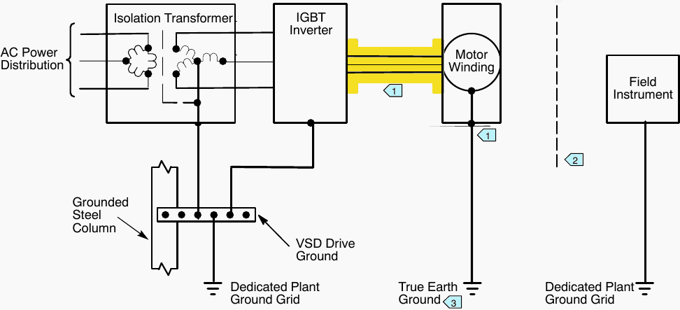

Figure 4 depicts the power and ground cabling for VSD systems, which, when correctly installed, often mitigates electrical noise to sufficiently low levels, hence minimizing motor damage and ensuring unobstructed control system performance.
Figure 4 – Ground Wiring for Adequate Noise Protection with IGBT Inverters
Annotations:
  1. Refer to Figure 5 for details regarding the ground connection.
  2. Maintain a considerable distance between field instrumentation and VSD equipment, utilizing armored power cables, insulated motor stator windings, and appropriate grounding to mitigate the impact of stray high-frequency signals.
  3. The motor frame can be connected to the building’s steel structure if it offers an effective, low-impedance path to a real earth ground, typically a dedicated plant ground grid.
  4. The waveform is characteristic of high-frequency stray signals that may occur on VSD ground wiring and radiate similarly to radio transmissions.

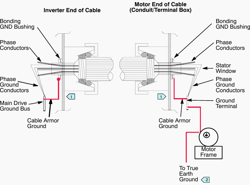

Figure 5 illustrates the specifications for the grounding connections of the motor power cable. The motor frame is connected to a real earth ground. For new constructions, the frame may be connected to a UFER ground or to adequately grounded building steel. For existing structures, the frame may be grounded to the nearest accessible effectively grounded building steel or grid.
Effectively grounded signifies that the building’s steel offers a low impedance pathway to the real earth ground.
Figure 5 – Ground Connections at Motor Power Cable Ends
Annotations:
  1. Cable grounds are terminated at both ends as illustrated.
  2. The motor frame may be connected to building steel if the steel offers an effective, low-impedance route to a real earth ground, often a dedicated plant ground grid.

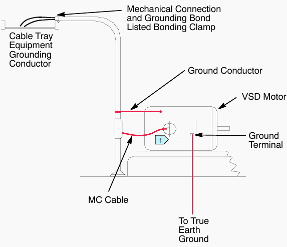

Figure 6 illustrates the dropout pathway from the cable tray to the motor.
Figure 6 – Dropouts from Cable Tray to VSD Motor
Annotations:
