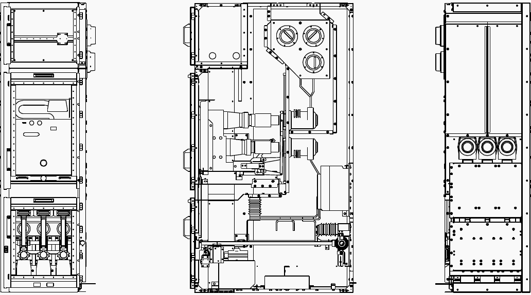

Home / Technical Articles / Mastering Operational Ratings of Medium-Voltage Switchgear
Estimated Study Time: 25 minutes
Medium Voltage Circuit Breakers
When you look at the IEC 62271-100 for MV breaker ratings, you will likely find a bunch of rated-something ratings. It could be hard for young engineers to catch up with all ratings, especially since several ratings are similar in wording but crucially different. This technical article will shed some light on the most important of these ratings of a medium-voltage circuit breaker.
The last two decades have seen tremendous advancements in the technology of medium voltage circuit breakers. Nowadays, the majority of utility systems use a combination of SF6 circuit breakers and vacuum. When it comes to transmission voltages (72.5 kV and higher), the SF6 circuit breaker is now considered cutting edge technology. But because it is a greenhouse gas, many nations have introduced safety measures to keep SF6 gas from getting into the air.
Due to its excellent advantages including long contact life, low operating energy demand, high reliability, and absence of maintenance requirement, vacuum circuit breakers have emerged as the dominating technology in the medium voltage range.
The ratings of circuit breakers, including SF6 and vacuum breakers, are briefly covered in this technical article.

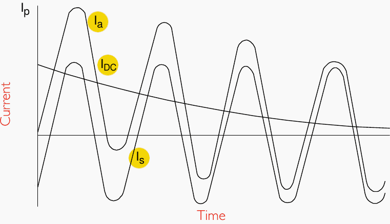

Condition #2: In the closed position, a circuit breaker must sustain a specific fault current level (Ik) for a short time period (tk). A circuit breaker’s short-time withstand fault current rating must exceed the expected rms symmetrical fault current level (Is) at the point of installation.
Condition #3: A circuit breaker must be capable of sustaining electrodynamic and thermal stresses associated with the peak let-through energy of a fault. The circuit breaker’s make rating must exceed the expected peak fault current level (Ip) at the point of installation.
  • Ip = 2.5 × Is (for a 50 Hz supply with a 45 ms DC time constant)
  • Ip = 2.6 × Is (for a 60 Hz supply with a 45 ms DC time constant)
Where:
  • Ip = asymmetrical peak let-through fault current, from the first fault loop (kA)
  • Is = rms symmetrical fault current level, with no DC component (kA)
Figure 1 – MV circuit breaker current-time diagram
Where:
  • Ia – asymmetrical rms current
  • IDC – DC component
  • Is – symmetrical rms component
  • Ip – instantaneous peak current

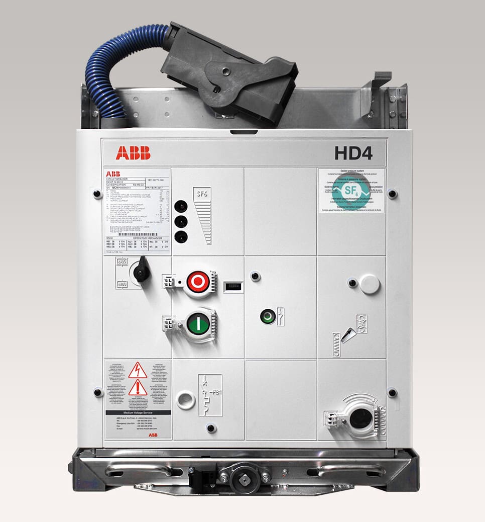

2.2 SF6 gas-insulated circuit breakers
Typical characteristics:
  • Environment: Indoor/outdoor
  • Operating current: ≤ 4000 A
  • Operating voltage: ≤ 52 kV
  • Fault current rating: ≤ 50 kA
  • Contacts: One fixed and one moveable copper/chromium switching contact per pole, with a contact separation distance of 10-15 mm.
  • Arc-extinguishing properties: quick and efficient (Special design techniques use compressed sulphur hexafluoride gas to extinguish the arc)
Figure 3 – Medium-voltage SF6 circuit breaker, type HD4 (ABB)

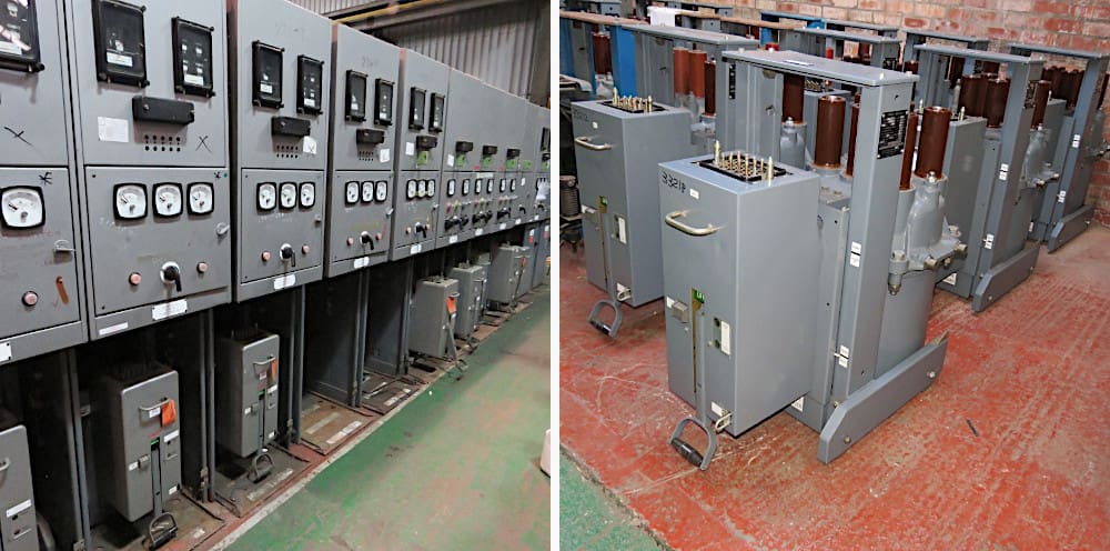

2.3 Oil circuit breakers (Obsolete)
These circuit breakers use an oil blast method to extinguish the arc. When the switching contacts separate, the arc vaporises the oil surrounding it. This produces a gas which inhibits arc ionisation. At the same time, convectional movement of the oil aids in cooling after the arc has been extinguished.
Due to oil fire hazard, these circuit breakers are generally used for outdoor applications only, and are being replaced in indoor applications.
Figure 4 – Old medium-voltage oil circuit switchgear (left) and oil circuit breakers (right)

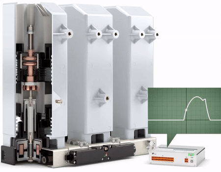

3.1 Magnetic technique
Magnetic technique uses an open and close armature, permanently energized in one of the two states. The energy required to maintain constant magnetic field strength, in either the open or closed state, is stored using capacitance. Energised armatures interact with mechanical linkages to operate the main switching contacts.
This operating technique provides extremely fast operation and is very energy efficient.
All components are mounted on a single axis, with a mono-stable magnetic actuator (one per pole). The actuators power a pulling insulator, which links to the vacuum interrupters at the top of the breaker.
Figure 5 – MV circuit breaker with magnetic operating mechanism (Tavrida)

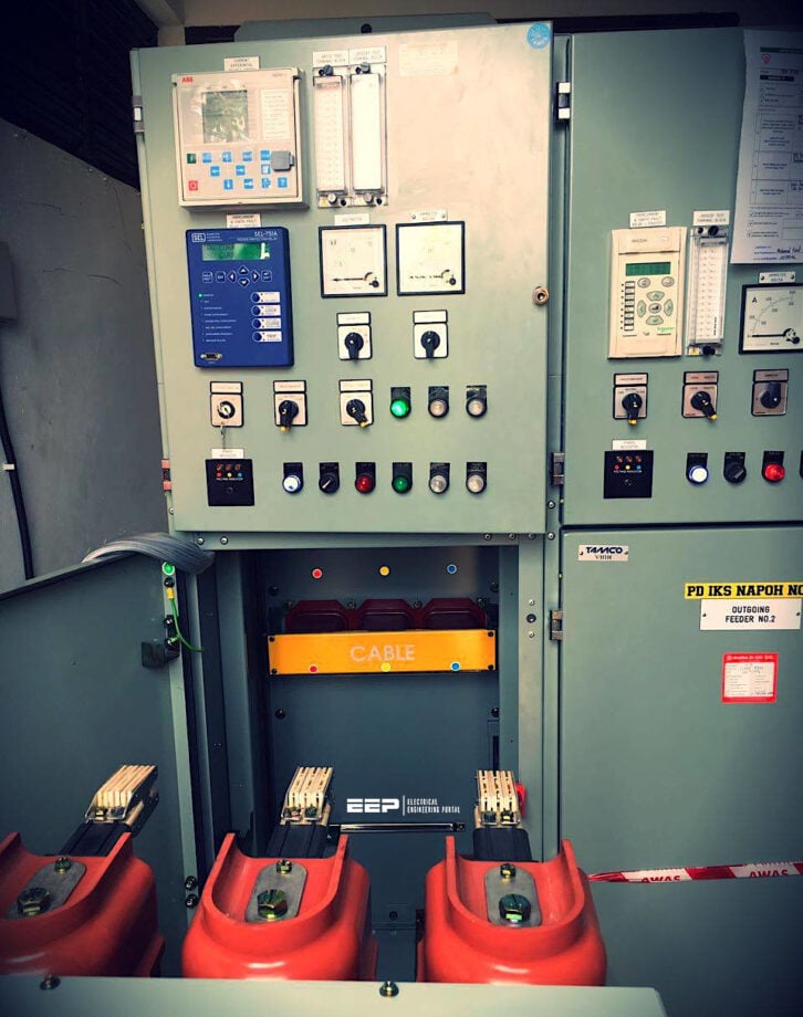

4. Withdrawable circuit breakers
Most indoor switchgear installations use withdrawable circuit breakers. These are also referred to as rack style or draw-out units. The main circuit breaker body is fitted on a trolley arrangement known as a truck, which is moved horizontally by means of a crank handle. By moving the circuit breaker towards the operator, the main contact points separate until a test position is reached.
To reconnect the main contact points, the circuit breaker is moved away from the operator until the service position is reached. The circuit breaker position cannot be changed unless the circuit breaker main poles are electrically open.
The main advantage of a withdrawable circuit breaker compared with fixed type circuit breakers is the ability to safely disconnect and isolate the main circuit for maintenance or circuit breaker replacement.
When a withdrawable circuit breaker is integrated into a metal-enclosed switchgear compartment, electromechanical interlocking is used to ensure safe operation, such as:
  1. The circuit breaker switchgear compartment door cannot be opened unless the circuit breaker is electrically open and physically racked out to the test position.
  2. Isolation barrier shutters are automatically operated, according to the circuit breaker truck position.
  3. when an earth switch is incorporated into a metal-enclosed switchgear panel with a withdrawable circuitbreaker, the earth switch can only be closed if the circuit breaker is electrically open and physically racked-out to the test position’
Figure 7 – MV switchgear cubicle with a withdrawable circuit breaker

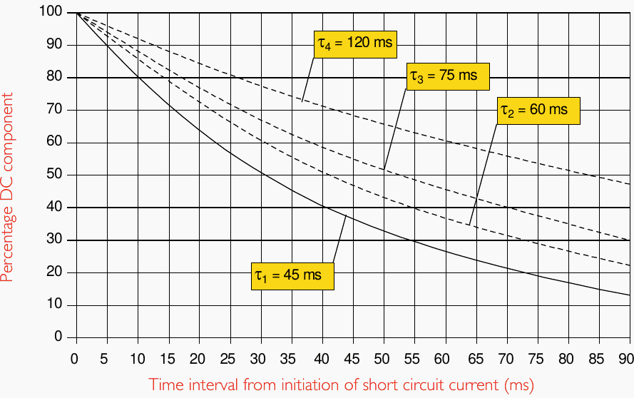

6.8 Rated short circuit breaking capacity, Isc (kA)
This is the highest level of rms current which the circuit breaker can successfully open (break) on a fault, at its rated voltage. When a short circuit occurs in a 3-phase system, the initial fault current is asymmetrical and is made up of an AC symmetrical component and a decaying DC component.
The rated short circuit breaking capacity must be greater than the expected asymmetrical fault current level when the circuit breaker poles are opened.
  • ISC ≥ Ia
  • Ia = Is + Id
Where:
  • Isc = Rated short circuit breaking capacity of circuit breaker (kA)
  • Ia = Asymmetrical fault current level when circuit breaker poles are opened (kA)
  • Is = AC symmetrical fault current component (kA)
  • Id = DC fault current component (kA)
Standard values for Isc = 6.3, 8, 10, 12.5, 16, 20, 25, 31.5, 40, 50, 63 kA (source: IEC 62271-100)
The graph below illustrates the percentage DC component of a fault, over a period of time, for systems with various time constants. Most systems use the standard time constant (τ1) of 45 ms. The total opening time of the circuit breaker is the pole opening time plus 10 ms for relay sensing, and this figure can be used to determine the percentage DC component of a fault at the instant of breaking.
Figure 8 – Percentage DC component in fault current

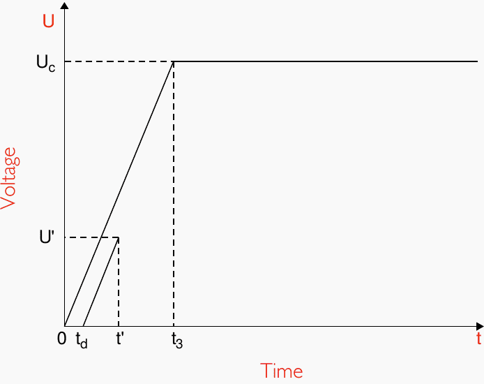

6.10 Rated TRV (Uc) for circuit breakers intended for use on cable systems (Class S1)
IEC 62271-100 defines standard TRV peak voltage ratings.
Table 3 – TRV withstand ratings for short circuit breaking current Isc
Ur (kV)3.67.21217.52436
Uc (kV)6.212.320.63041.261.7
Source: IEC 62271-100
Uc = 1.715 × Ur
Where:
  • Uc = TRV peak voltage value (kV)
  • Ur = rated voltage (kV)
Figure 10 – Voltage envelope for a two parameter TRV waveform on a cable system less than 100 kV
