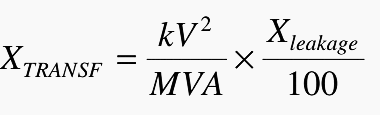

High short-circuit currents are then associated with low impedance sources, which are in turn inverse functions of transformer size. This can be illustrated by calculating the change of impedance when an “old” transformer of rating MVA1 is replaced by a “new” transformer rated MVA2.
By using the fundamental expression for transformer impedance described in Equation (1):
Fundamental expression for transformer impedance
we arrive at the following:
If we assume all other parameters the same, the impedance ratio in Equation (7.2) reduces to:
Impedance ratio
That is, the impedance ratio of a new to an old transformer varies with the inverse ratio between the old and the new transformers’ megavolt amperes. For instance, a 30-MVA transformer would present an impedance twice as small as a 15-MVA transformer of the same voltage class and a two-times increase in short-circuit current, assuming the two of them have the same leakage impedance.
In other words, the rating of a distribution transformer for a given voltage can be used as an indication of source stiffness.

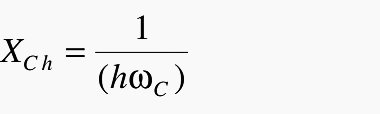

At harmonic frequencies, inductive and capacitive impedances of the system vary as a function of frequency:
Inductive impedance in function of frequency
Capacitive impedance in function of frequency
A stiffer source will primarily affect the inductive component of the system. Harmonic currents will produce voltage drops affected by the inductive reactance of the system, which is composed of feeder and substation components.
For the case of short feeders, the source impedance will be the dominant component. In these situations, harmonic currents are likely to reach the substation and the voltage drop on the source impedance, and thus the harmonic distortion will be smaller in stiffer systems.

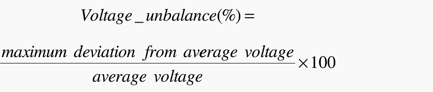

5.1 Phase voltage unbalance
The simplest method to determine voltage unbalance is by calculating the greatest deviation of the phase-to-phase voltage from the average voltage as follows:
Voltage unbalance formulae
For example, if a 480-V application shows voltages VAB, VBC, and VCA equal to 473, 478, and 486 V, respectively, with an average voltage of (473 + 478 + 486)/3 = 479 V, the voltage unbalance is as follows:
Voltage unbalance results
