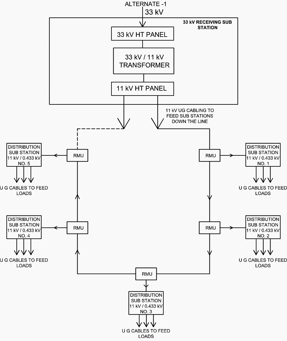

1.1 Indoor Substations and Underground Cable Power Distribution
The criteria for building substations are determined by the use of indoor substations equipped with backup equipment and underground cabling. This is done to minimize service disruptions and address the drawbacks associated with outdoor substations.
Disadvantage #1 – Outdoor substations are susceptible to dust, rain, storms, excessive heat, and theft, which can result in equipment failures and increased maintenance requirements. During periods of high winds, cyclones, and storms, the complete electrical distribution system, including poles and cables, can experience a collapse, resulting in a prolonged restoration process for the power supply.
Disadvantage #2 – The indoor substations operate at significantly lower ambient temperatures, such as 28 degrees Celsius, even while the external temperature may exceed 40 degrees Celsius. Moreover, the underground (UG) cable used for electricity distribution is significantly more advanced compared to the overhead system.

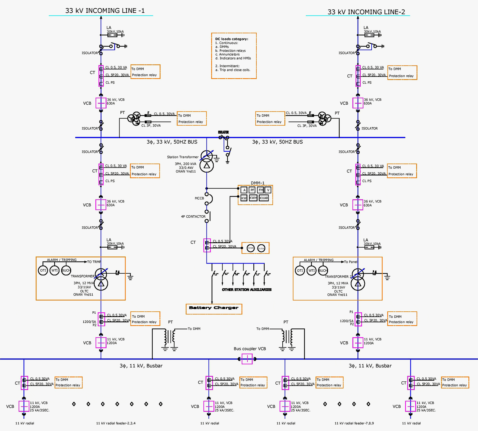

The substation equipped with DG Backup should be provided with an Uninterrupted Power Supply (UPS) to meet the power requirements of different loads, taking into account both the DG Backup and UPS backup. The choice between central and building-wise UPS provisions should be made after thorough evaluation of technical and economic factors, as well as user requirements.
In order to meet the power demands of essential UPS loads that require a high-quality input without any harmonics or surges, it is necessary to install an appropriate isolating transformer after the UPS.
Figure 1 – Schematic diagram for a substation with two transformers, one DG set, and one essential panel connecting essential loads

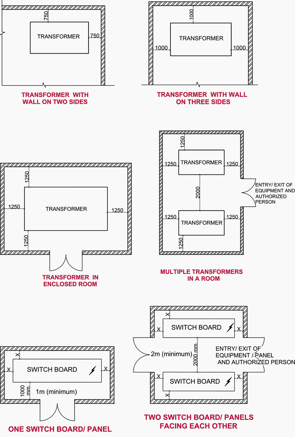

1.2 Dry or Oil-Cooled Transformer?

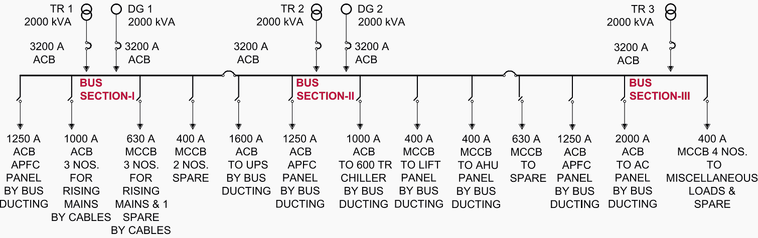

It is prohibited to place oil cooled transformers indoors. They are permitted when the substation is located at a distance from the main building. It is advisable to choose a dry transformer instead of an oil-cooled transformer for the following reasons:
  1. Highly resistant to fire and explosion.
  2. Virtually maintenance-free.
  3. There is no need for a wall enclosure for the transformer, therefore the space needed for the substation is decreased. The substation layout can consist of a single hall (Figure 2) with VCB Medium Voltage Panel and dry transformers.

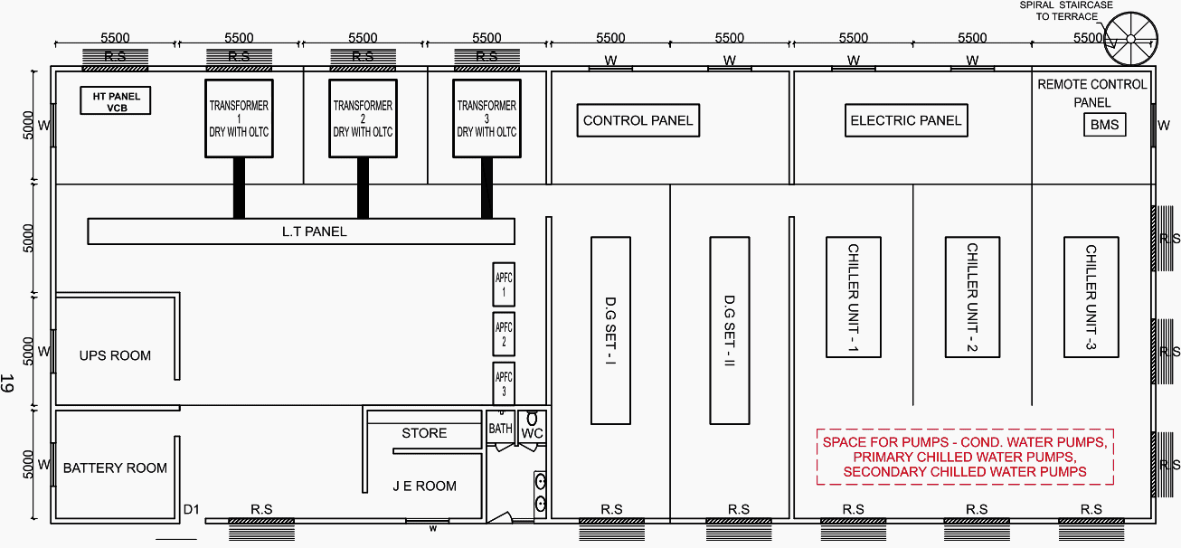

Figure 2 – Typical layout for 33/0.433 kV substation with 33kV incomer and two 2000kVA 33/0.433kV transformers

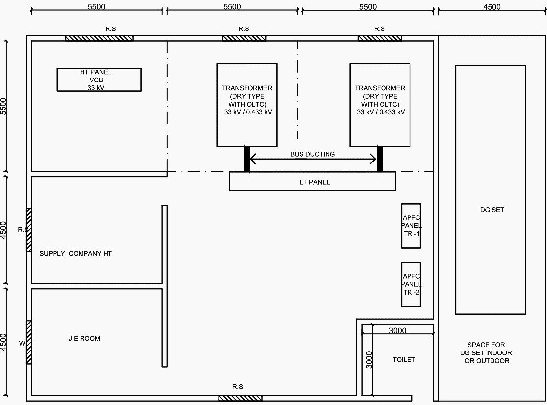

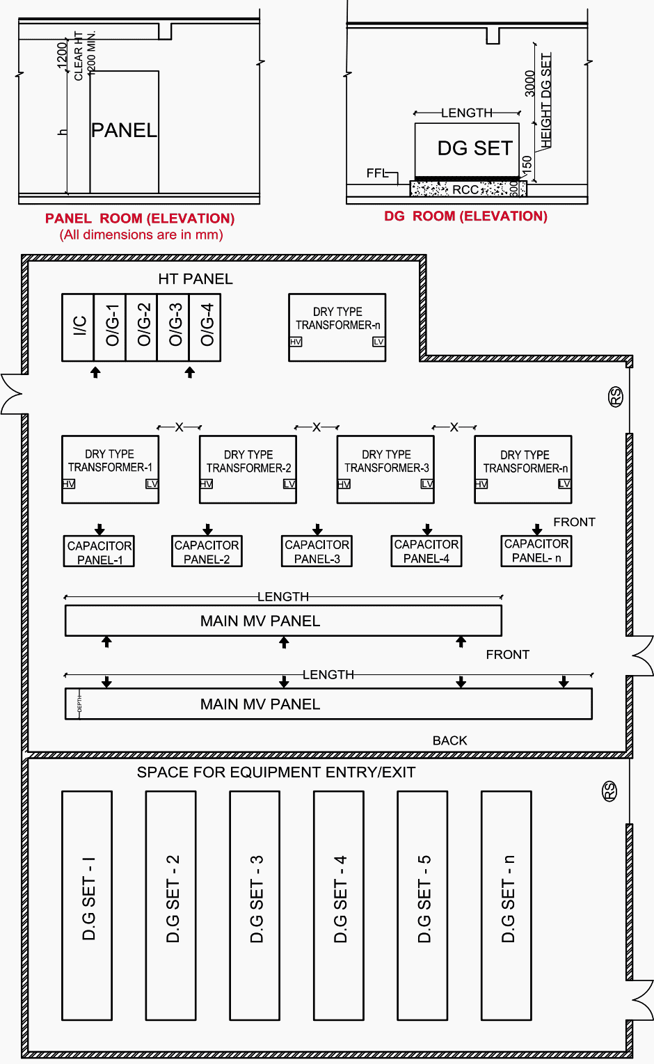

Please refer to the enclosed room type substation layout, which has dry transformers and does not have any room enclosures. This occupies a significantly smaller amount of space. See Figure 3.
Figure 3 – Typical substation layout with dry-type equipment in a single room

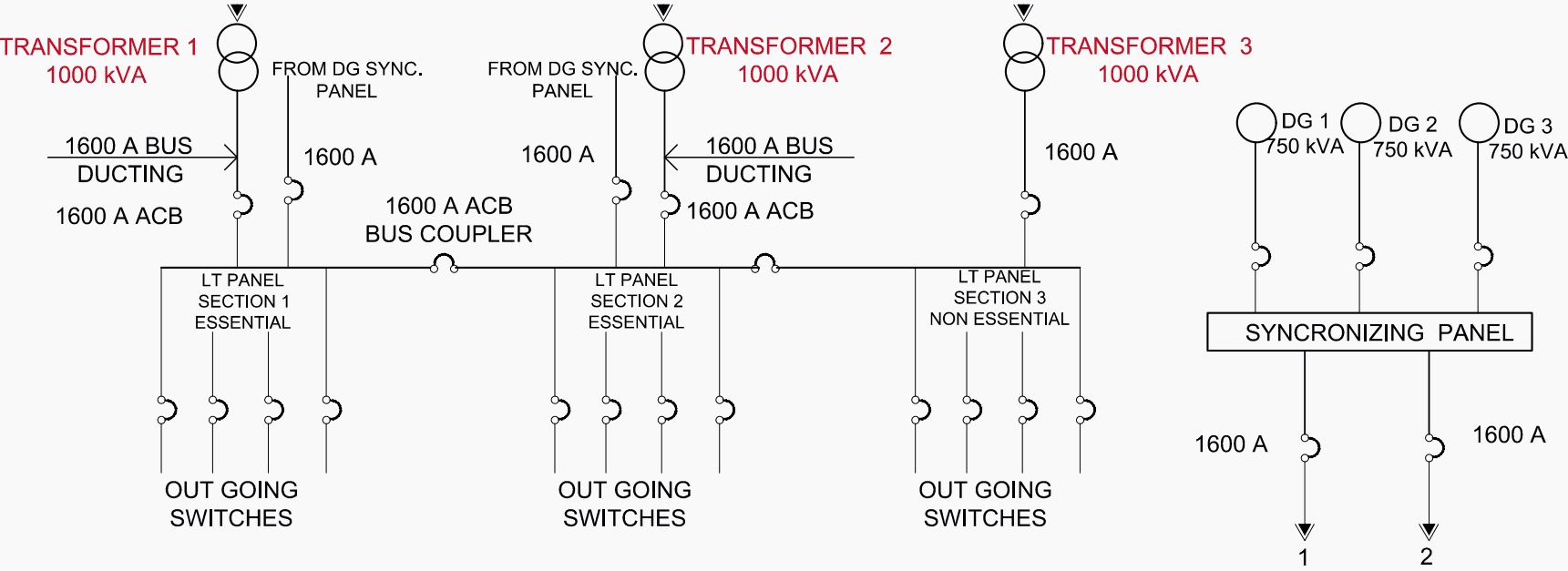

1.4 Distribution Substations With DG Backup
It is advised that each distribution substation should have its own DG Backup so that in case of mains power loss local DG sets are available as backup as per the standard procedure. Having a centralized DG Backup to provide 11 KV DG Power to the distribution substations is not advisable.
This will prevent the segregation of essential and non-essential resources. In the event of any malfunction in the 11 KV feeder cable, the entire campus will be without DG Backup.
Figure 4 – Schematic diagram of a substation with three transformers 1000kVA feeding two sections of essential LV panel and one section of non-essential LV panel with three 750kVA DG sets through synchronizing panels (click to zoom)

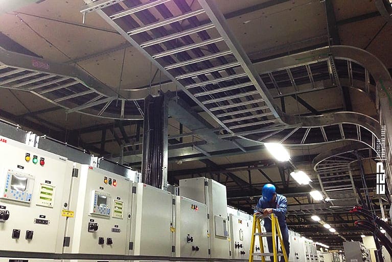

In order to digitally monitor and log the parameters of the substation, it is recommended to install a SCADA Panel, provided that the increased cost is justified by its usefulness.
Figure 6 – SCADA screens and panels behind
Three most common SCADA applications in MV/LV distribution systems you SHOULD know

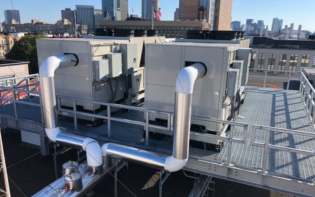

1.10 Larger-Capacity Equipment
It is recommended to use larger-capacity equipment such as transformers and chillers in order to minimize the amount of equipment needed and the overall space required in the utility building. This decision should be based on factors such as efficiency, life cycle cost analysis, and consideration of no load losses.

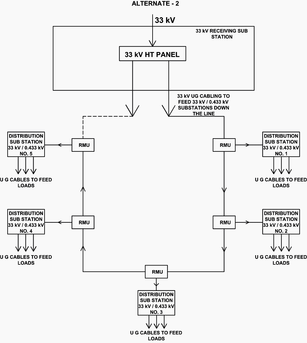

2. Uninterrupted Power Supply
The goal of ensuring continuous power supply is accomplished by the following methods: Initially, evaluate the electricity demand of the building or campus. Ensuring adequate allocation for anticipated electricity expansion, which is conservatively estimated at an annual growth rate of approximately 5%.
As an illustration, the peak power consumption of Delhi, an Indian city, has risen from 4700 MW in 2010 to 7000 MW in 2018, representing a growth of 50% over a span of 8 years.
The power will be acquired at the receiving substation, also known as the grid substation, from the local supply company. The power supply voltage can vary depending on the required power capacity and local restrictions, with options of 11KV, 33KV, or 66KV.
The campus’s full development, including the load growth, may take approximately 5 to 10 years. To accommodate this growth, it is advisable to have a flexible contract with the supply business, allowing for progressive expansion. Additionally, it is recommended to allocate space in the layout for future extension of the substation building to accommodate the increased load.

Figure 10 – Single line diagram of a 33/11 kV power distribution substation (click to expand the diagram)

A standard campus typically has a single 33KV receiving substation, equipped with one or two incoming 33 KV feeder lines. This substation is connected to a 33 KV MV panel, which supplies power to 33KV/11 KV or 33 KV/0.433 KV transformers based on special needs. It has the capacity to supply electricity to about 4 or more distribution substations located throughout the campus.
A typical layout of 33 KV substation and various alternate power distribution schematic diagrams are depicted in Figures 11 and 12.
Figure 11 – Schematic diagram for 33kV receiving substation feeding number of 11/0.433 kV distribution substations through 11kV cabling
Figure 12 – Schematic diagram for 33kV receiving substation feeding number of 33/0.433 kV distribution substations through 33kV cabling
Typical layout of an 11KV/0.433 KV or 33KV/0.433 KV distribution substation is detailed in Substation specifications.
A common diagram illustrating the components of a substation, including the MV Panel, Transformers, Bus ducting, LV Panel (Essential and non-essential), APFC Panel, DG Sets, DG Synchronizing Panel, UPS, and Battery Room, is provided for general reference (Figure 13). These may be subject to change depending on specific requirements.
Figure 13 – Typical layout of DG sets, substation equipment, AV plant room and UPS (click to zoom)
Typical layout of DG sets, substation equipment, AC plant room and UPS
Figure 13 – Typical layout of DG sets, substation equipment, AC plant room and UPS
Notes:
  1. Floor to ceiling height 6.5 m, floor level 30 cm above ground level.
  2. Motorable concrete approach road all round.
  3. Partition walls – 30 cm thick brick
  4. Spiral staircase to terrace for terrace maintenance and approach to equipment on terrace.
  5. 1 m wide sun shade protection all around.
  6. Rolling shutter – 3 m wide – 3.5 m height. With ventilation grids.
  7. All doors of steel with fire protection , d1 – 1 m wide 2 m height.
  8. W – window – normal size with grill.
  9. Cable entry pipes — ex. Engineer will give location and details.
  10. Cable trenches – ex. Engineer will give details.
  11. Protection boundary wall with gate – if substation is protected premises, suitable boundary wall with gate should be provided.
  12. Store shelves – 0.75 m deep, rcc 1m , 2m ,3m above ground level.
  13. 2000 ltrs. Water tank on the terrace with water connection.
  14. Cooling towers will be located on the terrace.
  15. Locate exhaust chimney and UG bulk storage tank

7. Power Supply to Central AC Plant
In a centrally air-conditioned building, where AC consumes 50% of the electricity, it is advisable to position the AC Main Electrical Panel near the substation to minimize connections expenses. The AC Electrical Panel will be divided into two distinct sections: Essential and Non-Essential.
Certain chillers, along with the pumps and cooling towers, will be designated as essential supply. It is necessary for all Air Handling Units (AHUs) to be connected to the DG Supply. Consequently, there will be two primary power sources connected to the main AC Panel, which will be linked to the Substation LT Panel via Bus ducting.
A primary Electrical panel will be installed to provide power to the Air Handling Units (AHUs).

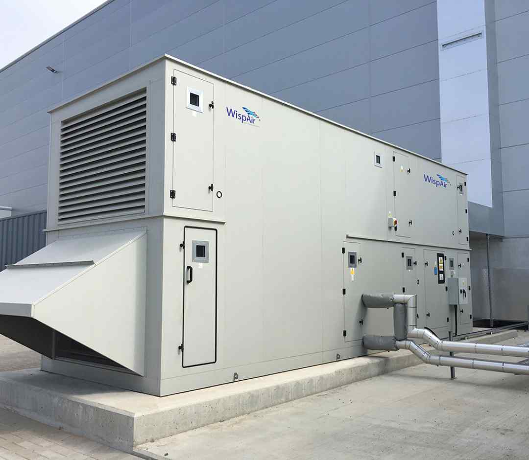

8. Power Supply to Air-Handling Units (AHUs)
The Air-Handling Units (AHUs) CAN be arranged in a vertical configuration, with each unit positioned directly over the other. Then, the rising main can be installed to supply power to the Air Handling Units (AHUs). The incoming of each ascending primary conduit should be linked to the outgoing of the Air Handling Unit (AHU) Main Panel situated in the Air Conditioning (AC) Plant Room.
This greatly simplifies the power supply to the Air Handling Units (AHUs).
Furthermore, the process of connecting the system to the Building Management System (BMS) is highly straightforward.

Figure 17 – Typical regular and emergency power supply system
Typical regular and emergency supply for large industrial plants
10.3 Distribution Panels Location and Requirements
It is necessary to install distribution panels and switchgear in easily accessible locations. The electrical control gear distribution panels and other necessary apparatus should be conveniently placed next to the rising mains on each floor. Sufficient space must be allocated on each floor to ensure proper clearances for this purpose.
Figure 18 – Substation transformer and switchboard clearances
