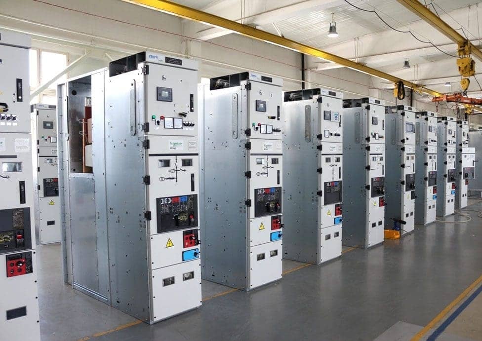

Figure 3 – MCSet 17.5 kV vacuum switchgear

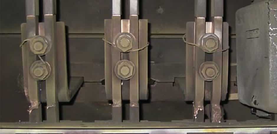

Reason #8 – Presence of Arc
The insulating gas/oil gets decomposed in the presence of arc. Although the products of decomposition re-combine after arc extinction, some remainders are there, which is why the insulating properties of dielectric get affected.
Figure 5 – Partial melting of busbars after short time stationary arcing at the insulation barriers

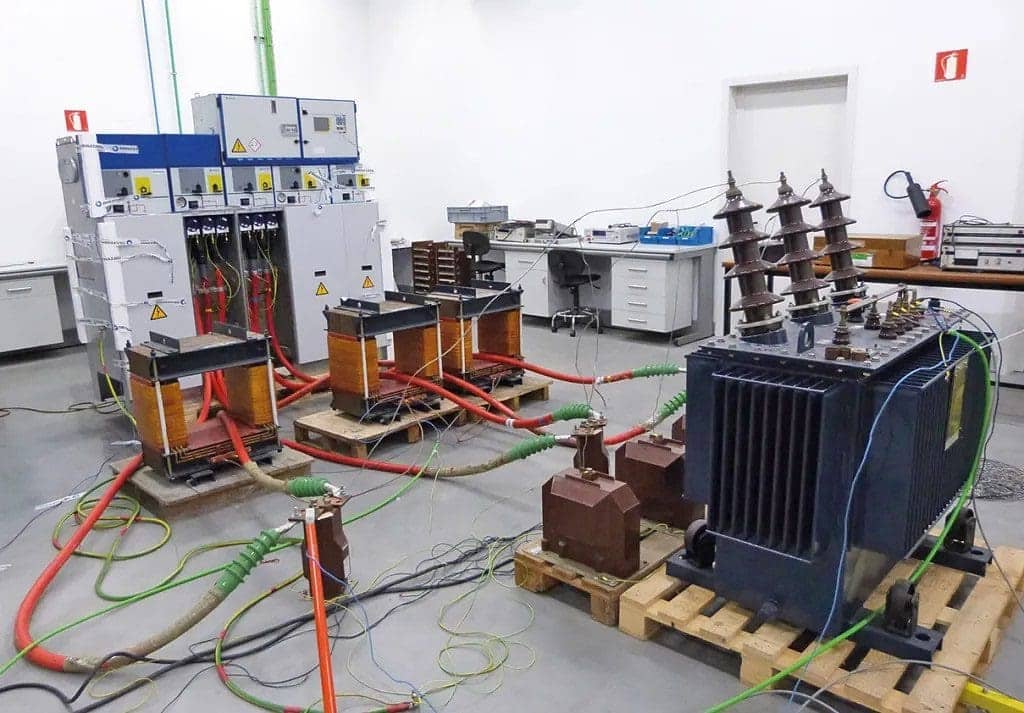

4. Temperature Rise Test
Temperature rise test determines the highest normal current that the switchgear can carry without exceeding the maximum permitted temperature at any point. Since the current carried affects the temperature rise, the current rating is dependent upon the maximum ambient temperature. Sometimes one temperature limit prevails in determining the current rating, and different countries have different limits for similar materials.
For example, the ANSI standard states that any part that can be handled by an operator in the normal course of his duties must not exceed 500°C which could become a limitation if solar heating is taken into account.
IEC standard gives 1000°C as the highest permitted temperature for metallic parts in contact with oil, whereas the ANSI document limits this to 90°C.
This test is to verify the normal rated current-carrying capacity of equipment. The rated AC current at rated frequency is passed through the CB in closed condition continuously and temperature at different locations is measured by using thermocouples till steady temperature is achieved. At steady temperature, the temperature measured at different points should be within the limits as specified in the standards.
When AC current is passed through a breaker, heat is generated due to I2R loss. The generated heat is dissipated by conduction, convection and radiation. In conduction, heat travels through the solid body, convection uses liquid media and radiation implies transmission through goes.
In order to maintain the temperature rise within specified limits, l2Rt loss should be reduced by increasing the conductor cross-section using suitable low resistivity material and by improving heat transfer through conduction, convection and radiation of heat.
Figure 6 – Temperature rise test performed on medium voltage switchgear
Figure 6 – Temperature rise test performed on medium voltage switchgear (photo credit: bela-labs.com)
