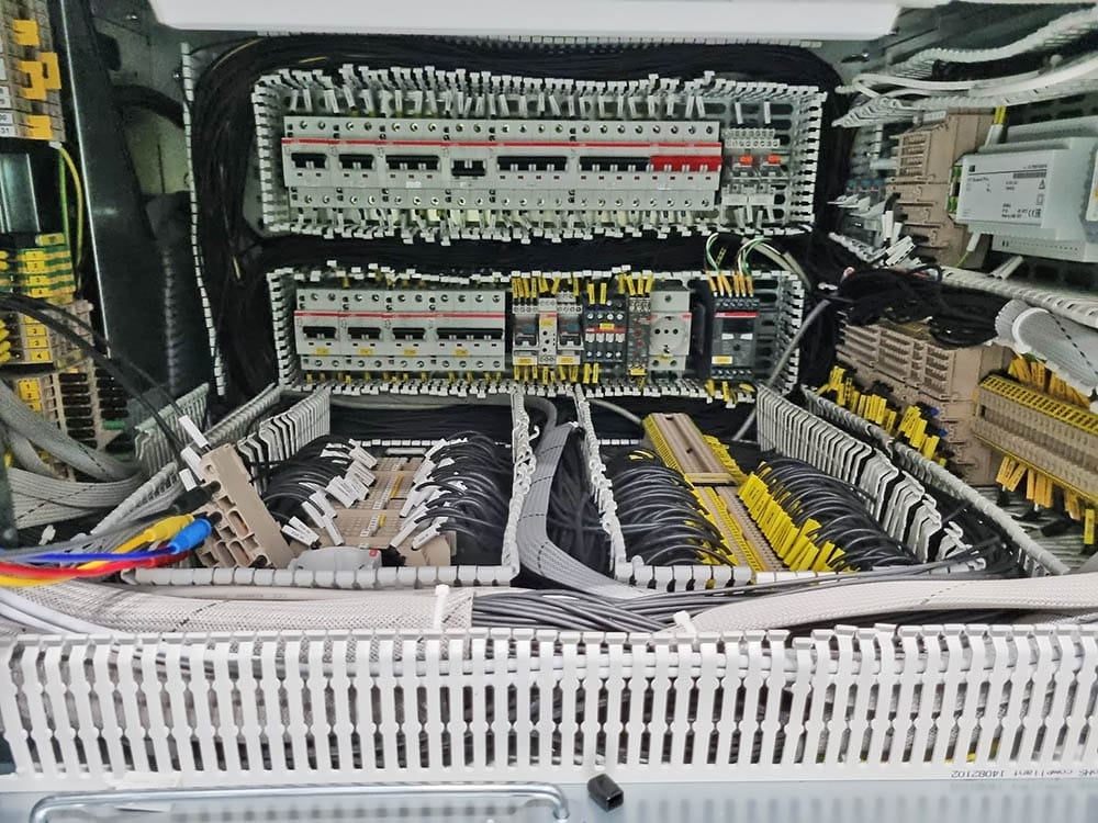

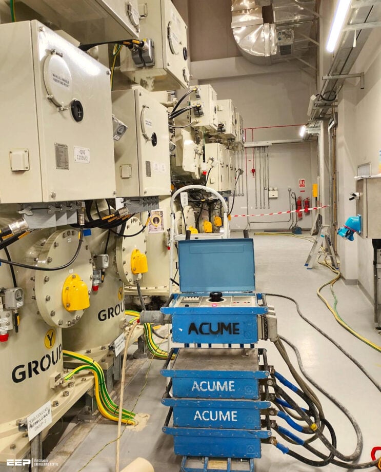

2. Checking Control Cables and Wirings
Typically control cable tests are in two categories. First, the insulation integrity is tested using a 1000 volt source (Megger), which may be manual or motorized. The owner or manufacturer should be consulted for a site-specific procedure; however, the objective is to confirm that individual conductors are insulated from each other and the cable shield, if one is present.
The cable jacket integrity is also tested. The objective is to detect missing or damaged insulation. Successful tests should show high resistive readings.
The second category is a point-to-point continuity test to verify that the conductors are landed on the correct terminals. Installation personnel isolate the connections using slide links and then verify, using sound powered phones, buzzers, or similar equipment, that the connection is correct.
The installation crew should maintain records of the insulation tests and the point-to-point wiring checks. It is also a generally accepted procedure to trace the various protection, control, interlocking circuits, etc. during the point to point checks, and “yellow line” the associated electrical wiring or schematic drawings as the checks are made to verify the secondary circuit integrity.
Figure 2 – Here we see the control cabinet of a GIS substation bay protection cabinet. This particular cabinet is equipped with an IEC61850 protection network.
Here we see the control cabinet of a marine substation bay protection cabinet

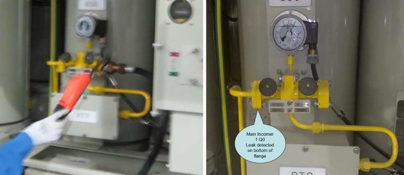

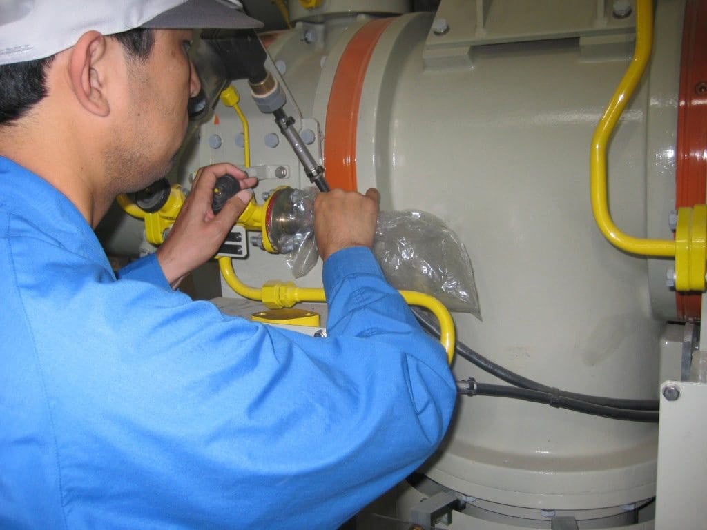

3. Bus Gas Leak Checks
Once the various GIS compartments have been processed and gas-filled, a second leak check may be recommended by the manufacturers, particularly for long bus runs. Each flange is covered by plastic and sealed with duct tape. A small stone is placed in the bottom of the plastic “bag.” This plastic “enclosure” remains for 12 to 24 hours.
An SF6 detection device is then inserted into the bag. If there are gas leaks, as SF6 is heavier than air, it will settle to the bottom of the plastic bag (see Figure 3) and activate the detector.
Figure 4 shows example of using SF6 gas detector.
Figure 3 – Flange gas leakage test

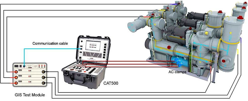

Generally this test requires a 100 A DC μΩ meter with independent voltage and current sources. Tests are conducted on an assembled GIS section as specified by the manufacturer, isolating the circuit using a ground switch and removing its grounding strap.
The various GIS switches in the test circuit are configured to meet the measurement requirements, and with the current lead connected to the “floating” ground strap and the μΩ meter voltage lead connected to the ground switch enclosure, 100 A are injected into the circuit. The readings obtained are compared to engineering calculations, which may include a tolerance specification.
An acceptable field measurement agrees with the engineered calculation.

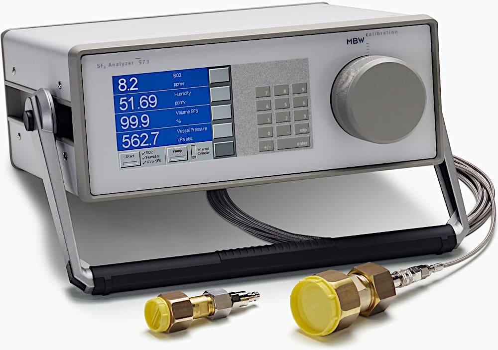

6. SF6 Gas Quality Tests
Once the gas compartments are processed and filled to the correct pressure/density, gas purity tests are conducted (see Figures 5 and 6). These tests require a small amount of gas and identify the level of moisture present and the purity of the SF6. For new GIS equipment installations acceptable values are moisture levels in the 150 ppm to 300 ppm range and gas purity in the 99.5% range.
Some manufacturers decrease the acceptable parameters in older or reprocessed gas to 500 ppm moisture with a gas purity of 98%. These values should be recorded for maintenance baseline use when gas quality measurements are made in the future.

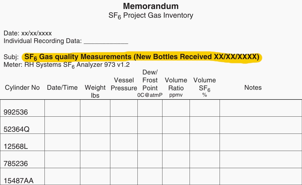

A table similar to Figure 5 should be prepared to record the individual gas zone SF6 moisture content and purity for future maintenance baseline comparison purposes.
Figure 5 – SF6 project gas inventory
Pure SF6 serves as the typical filling in GIS; nevertheless, gas compartments can get contaminated with water vapor (H2O) over time due to absorption and desorption from interior materials. Although water vapor and SF6 typically do not interact, under high-energy discharge conditions, hydrogen and oxygen dissociated from water vapor will react with sulfur and fluorine from SF6, resulting in the formation of breakdown by-products.
These comprise sulfur dioxide (SO2) and hydrofluoric acid (HF), which are corrosive to the inside components of gas compartments.
SF6 with minimal water vapor content substantially diminishes the likelihood of generating these corrosive chemicals, therefore rendering precise and consistent measurement data an essential component of any GIS preventative maintenance program.
Figure 6 – SF6 Gas Analyzer
SF6 Gas Analyzer

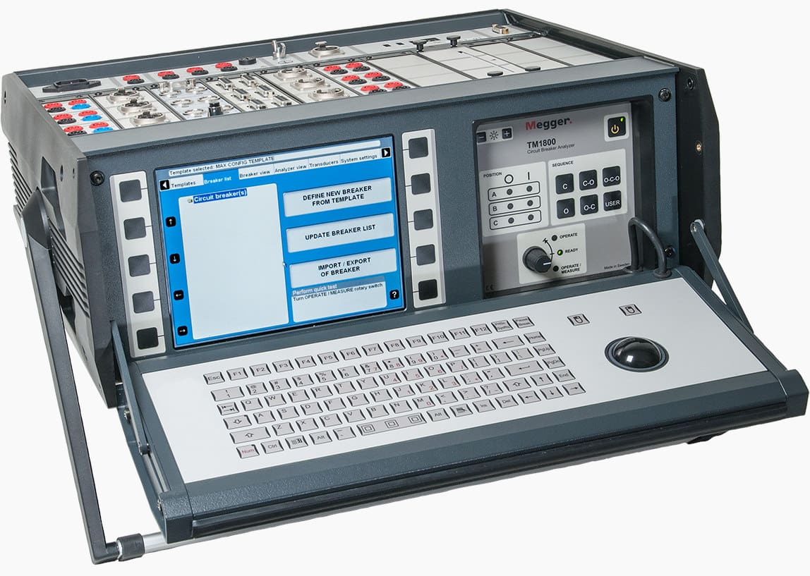

7.3 Breaker Travel and Timing Test
These tests are to confirm the dynamic operating performance of the breaker by measuring the operating times on a per pole basis and identifying any discrepancies or deviations with the phases. Manufacturers will typically provide the timing range and the maximum phase discrepancy limit. Any readings outside the manufacturer’s stated values should be investigated and adjustments made as necessary.
Figure 8 is typical instrumentation used to check circuit breaker contact timing.
Figure 8 – Circuit breaker time and travel analyser with DualGround™ testing by Megger

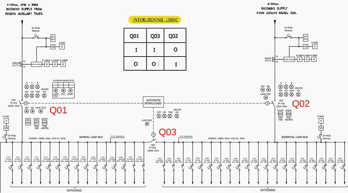

8. Ground and Disconnect Switch and Circuit Breaker Interlock Tests
GIS equipment is generally provided with interlocks to prevent incorrect operations; for example, most disconnects are not designed for load break operation and similarly ground switches cannot be closed without interconnected circuit breakers and disconnects open.
The manufacturer’s interlock logic diagram should be reviewed to verify the various open and close combinations and confirm that incorrect operations are blocked. These interlock schemes should also be checked for correct integration into the owner’s protection and switching logic.
Figure 9 – Logic Table for Interlocking Circuit Breakers in the AC Supply Panel

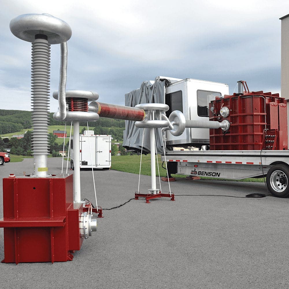

9. High Voltage Bus and Equipment Conditioning Tests
Before the GIS installations are placed in service, a high voltage conditioning test is performed with momentary voltages in excess of the equipment rated line-to-ground voltages. The objectives of the test are: to identify any abnormalities in the bus (loose hardware, tools, cleaning material inadvertently left in the bus) that could compromise the internal electrical clearances, identify excessive moisture levels and move conductive and semi-conductive materials to low stress areas or particle traps to prevent insulation flashovers.
The test voltage levels and time durations vary between manufacturers and are based upon the equipment voltage class, but for illustration purposes on a 362 kV class, 1050 BIL installation the test levels may be as shown in Table 12.

The high voltage test on site is usually done by a resonance test procedure. The inductance of the test transformer and the capacitance of the GIS are chosen in such a way that they form a resonance circuit in the range of 50–100 Hz.
This allows much smaller test equipment, which is shown in Figure 10.
Figure 10 – Variable Frequency high-voltage AC Resonant Test System
The benefits of using a series resonant test is the inherently limited fault current available, compared to a fault energy present when the GIS equipment is connected to the transmission system. A typical test on 362 kV equipment will take approximately an hour. A three person team is recommended including a safety observer, a timer, and the test set operator.

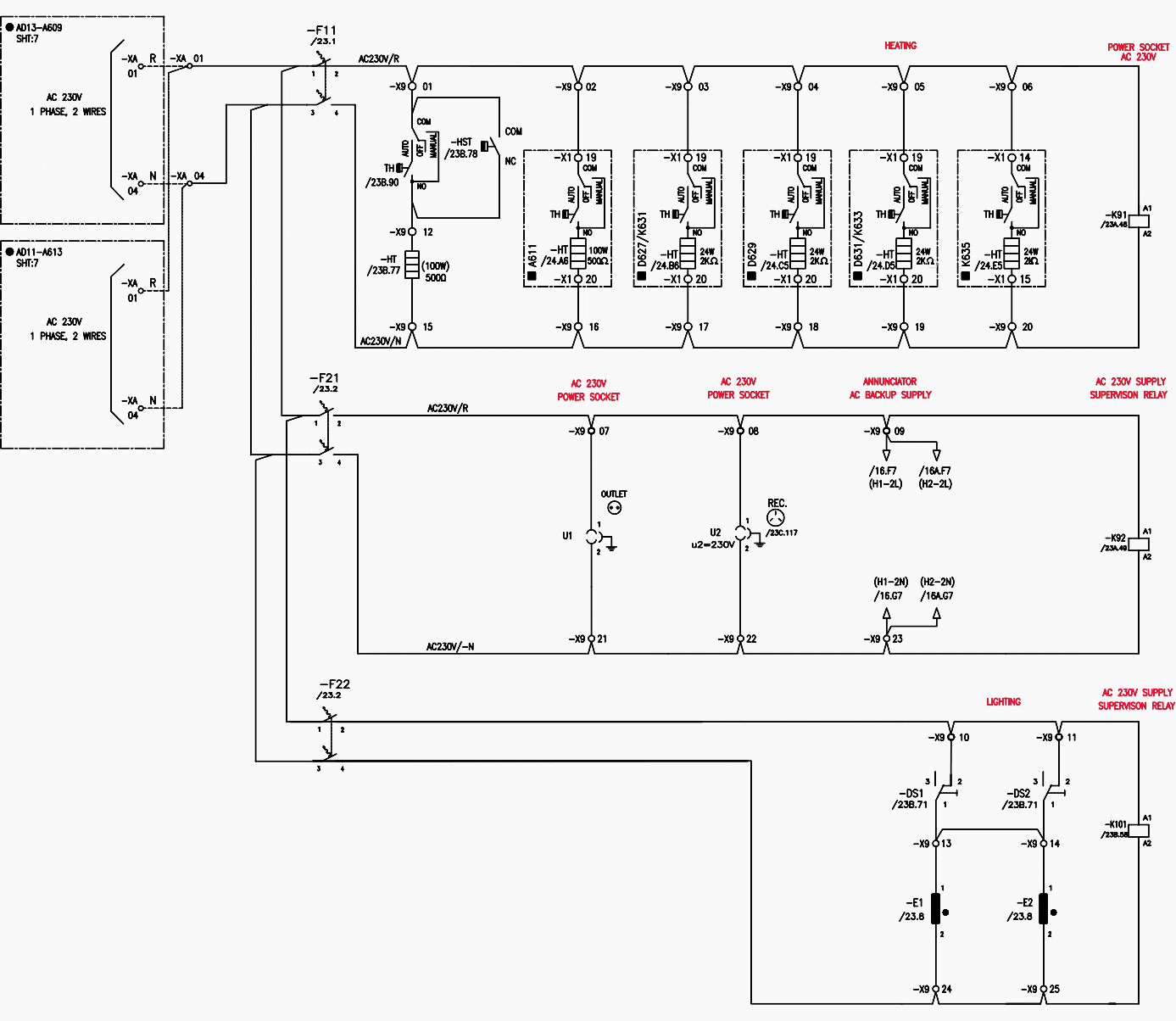

11.1 AC Station Service Measurements, Heater & Control Cabinet Light Operations
This work involves checking the heater circuits for current with a clamp-on ammeter, observing correct light operations using a door or manual switch, confirming all power receptacles are operational, and checking for tight connections.
Ground fault protection should be provided for receptacles particularly if the local control or marshalling cabinet is located outdoors. Three phase 60 or 100 A disconnects with independent power sources located on the exterior of the local control or marshalling cabinets may also be convenient to connect welders or gas cart/processing equipment.
The equipment and control cabinet heater test results MUST be recorded. The circuit breaker and other heaters in the GIS primary circuit are critical, particularly in cold climates to prevent SF6 liquefying and loss of gas density. Heaters may also be required at transition points between heated indoor locations and outdoors.
Thermostatic control settings (if used) should also be verified and the levels recorded.
Figure 11 – AC control circuits: heater circuit, AC load circuit, and lighting circuit (click to zoom)

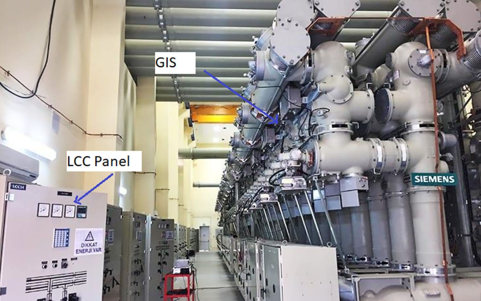

Figure 12 – GIS local control cabinet

In a similar manner, all gas zone pressures are recorded including circuit breakers on a compartment, per phase if an iso-phase bus is installed. The bus temperature is also recorded and the pressure reading temperature-compensated.
The value obtained is compared to the engineered nominal value with acceptable readings are within the engineered value.
Please note that some owners/operators may prefer gas density gages with numerical readings. In other designs a color coded gage may be acceptable with the gage needle in the green area on the gage face indicating satisfactory, the yellow area indicating caution or investigation of a potential leakage situation and the red area requiring immediate action and potentially a significant problem.
The gas density gauge design should be discussed during the initial engineering discussions.
