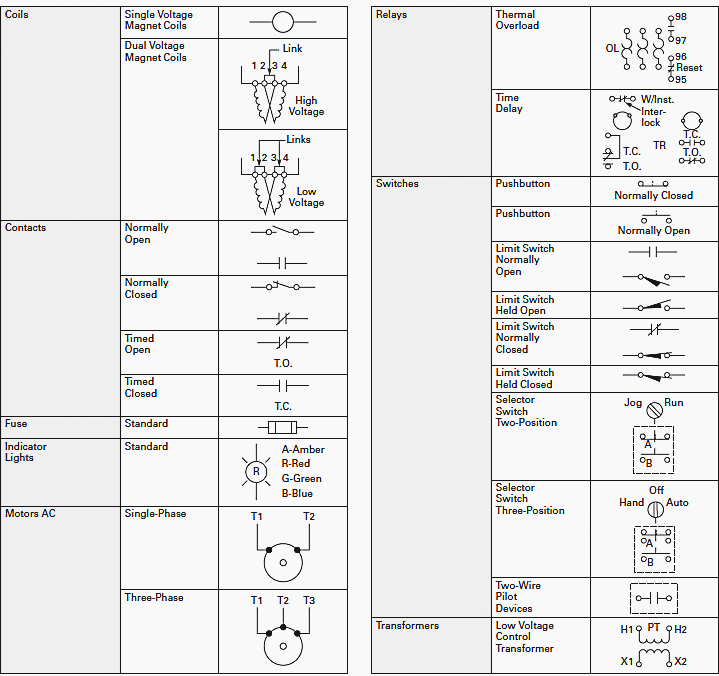

The American Standard Association (ASA) and NEMA are responsible for maintaining the standard symbols. A sample of the NEMA common symbols is depicted in Figure 2.

Different drawing types are used with motors and their control circuits. This includes a ladder diagram, a block diagram, a single-line diagram, and a wiring diagram. Each of these drawing types has its applications, but our focus in this article is confined to the single-line diagram and the wiring diagram.
Standard Diagram Symbols
Figure 2 – Standard Diagram Symbols

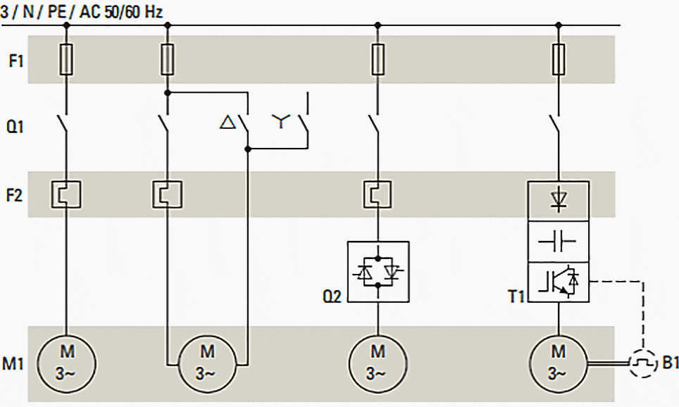

A single-line diagram (one-line diagram) offers an abstract view of the electrical system, yet it still conveys essential information. Manufacturers make use of the single-line diagram for motor control installation to help their analyses.
An example is given in Figure 3 that illustrates the main components normally used in the single-line diagram for motor installation applications. Another example is in Figure 4 gives the most common motor starters: direct-on-line (DOL), stardelta, and soft starter.
Also, the variable frequency drive controller is shown.
Motor Single-Line Diagram
Figure 3 – Motor Single-Line Diagram
Additionally, the primary protective means, motor size, and voltage rating are all given in the single-line diagram. Note that the figure is only a sample that combines almost all components that can be seen in a single-line diagram. It is not necessary to have them all in one application.
Also, it shows disconnecting means, protective elements, a communication port, a motor starter, and a motor thermal protection element.

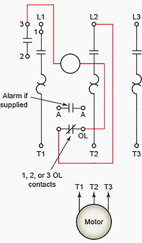

A typical wiring motor starter is in Figure 5, where open terminals (marked by circles) and arrows represent the connections that need to be done by users. Two main circuits govern the start and operation of MCCS: the power circuit and the control circuit.

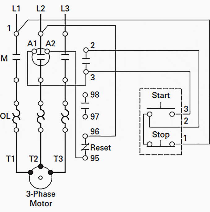

Electricity passes through starter contacts, overload relays, and to the motor in a typical starter wiring, which is a DOL starter, portrayed in Figure 6. Note that thick lines represent the power circuit, while the thin lines represent the control circuits.
Also, note the number of markings of the start and stop pushbuttons and their corresponding same numbering system in the circuit. Sometimes there is no line drawn from the control devices to the circuit due to complexity, so the numbering system is important.
The starter coil that is connected across terminals A1 and A2 energizes the main contacts (M) once the start pushbutton is pressed and de-energizes the contacts (M) upon pressing the stop pushbutton. The power circuit is the one that passes current to the motor making it start running, so it is called the motor circuit.
The control circuit, on the other hand, is the one that energizes the main contacts through the developed electromagnetic field across the magnet coil of the starter that pulls the power contacts closed.
Typical Starter Wiring Diagram
Figure 6 – Typical Starter Wiring Diagram
Keep in mind that the contacts, switches, and pushbuttons status follows the so-called “off-the-shelf” concept, which means the status of the contact reflects their conditions when power is not applied.
Hence, normally-open (NO) or normally closed (NC) in drawings refers to the “off-the-shelf” state.

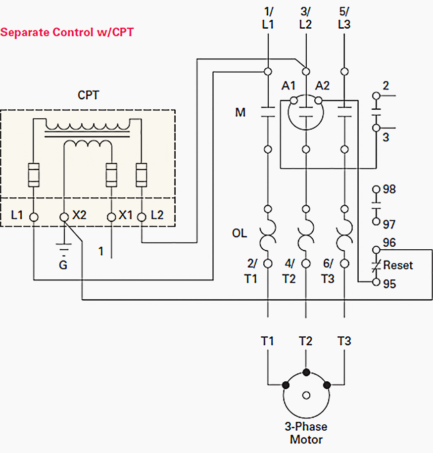

1.2.1 Common/Separate Control Circuit Voltage Supply
The control circuit is separated from the motor circuit. These two circuits might not be at the same voltage level, so the circuit is referred to as a common control; otherwise, it is referred to as a separate control. The separate control scheme is implemented using two approaches, one of which is to run different wires from different voltage sources.
For example, one can run a wire from a 480 V source to the motor through the starter line, and another wire supplying the magnet coil with 120 V. Of course, the motor starter must match the motor horsepower and the voltage, and so do the control components for the control voltage supply.
Alternatively, a control power transformer (CPT), also called a “control circuit transformer”, is used to supply the control circuit from the power circuit voltage source.
The common control scheme is shown in Figure 6, while the separate control scheme is depicted in Figure 7.
Separate Control Circuit with control power transformer (CPT)
Figure 7 – Separate control circuit with control power transformer (CPT)
