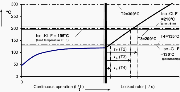

With respect to the temperature rise characteristics of an electrical machine, two operating statuses should be taken into account: continuous duty and stalled rotor motor.
At continuous duty under full load the machine slowly heats up and after several hours, depending on its size, reaches its steady-state temperature. At the highest permissible ambient temperature, this steady-state temperature may not exceed the limit temperature of the insulation material class nor of the temperature class.
In the schematically presented example of the heating characteristics of a machine of insulation material class F in Figure 1, neither the permitted limit of temperature class T4 nor that of insulation material class F are exceeded once the steady-state temperature has been reached. The second operating case should be considered as more critical. It occurs if the rotor of the 3-phase asynchronous motor becomes stalled after running at service temperature.
The current that then flows is several times higher than the rated current and causes the temperature of the rotor and stator windings to rise rapidly.
A monitoring device must disconnect the machine from the supply within the heating time tE, i.e. the time for the limit temperature of the windings to be reached. The heating time tE is the time after which the permissible temperature is reached with a stalled rotor condition starting from service temperature. It is a characteristic quantity of the motor.
Motors for Hazardous Areas - Nameplate
Motors for Hazardous Areas – Nameplate
As the selected example of a motor with stalled rotor in Figure 1 shows, the limit temperatures of the temperature class for applications T4 and T3 determine the tE-time.
Schematic presentation of the heating characteristic ofa motor
Figure 1 – Schematic presentation of the heating characteristic ofa motor. When locked at service temperature, the motor must be disconnected from the supply within the tE time.
If however the machine is intended for hazardous areas of temperature class T2 (or T 1), the thermal limit is determined by the short-term permissible limit temperature of isolation material class F of 210 °C.
