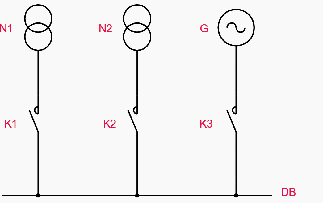

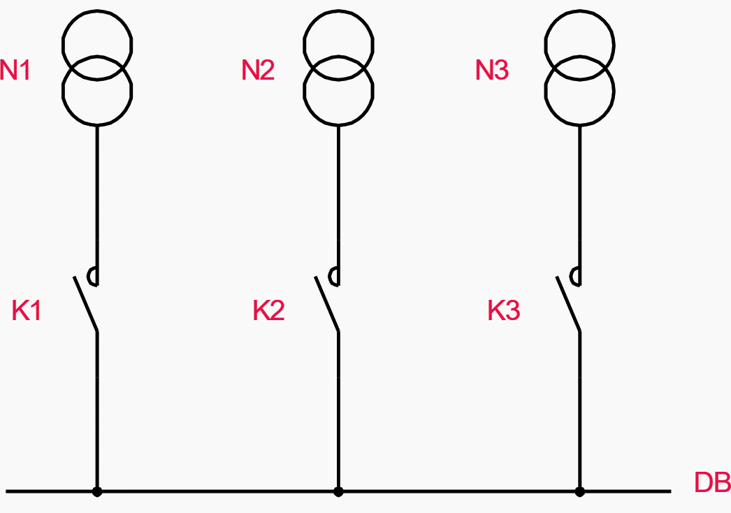

The most commonly used methods are a dual transformer fed supply and/or a standby generator sized to keep critical plant online. Automatic changeover systems are designed to monitor and maintain continuous supply.
Today’s technology allows the supervision and control of an entire distribution system from a single controller, referred to as an automatic transfer switch (ATS) or automatic changeover unit (ACU). Although there are a wide range of products available, they all have the same primary function.
The equipment monitors 3-phase voltages on all power sources. Power supply sources are often prioritized and if any phase voltage on the primary power source falls outside a predetermined range for a specific amount of time, the power source is switched over to a back-up supply. Once the primary power source is re-established, the power source is switched back to the primary power source.
