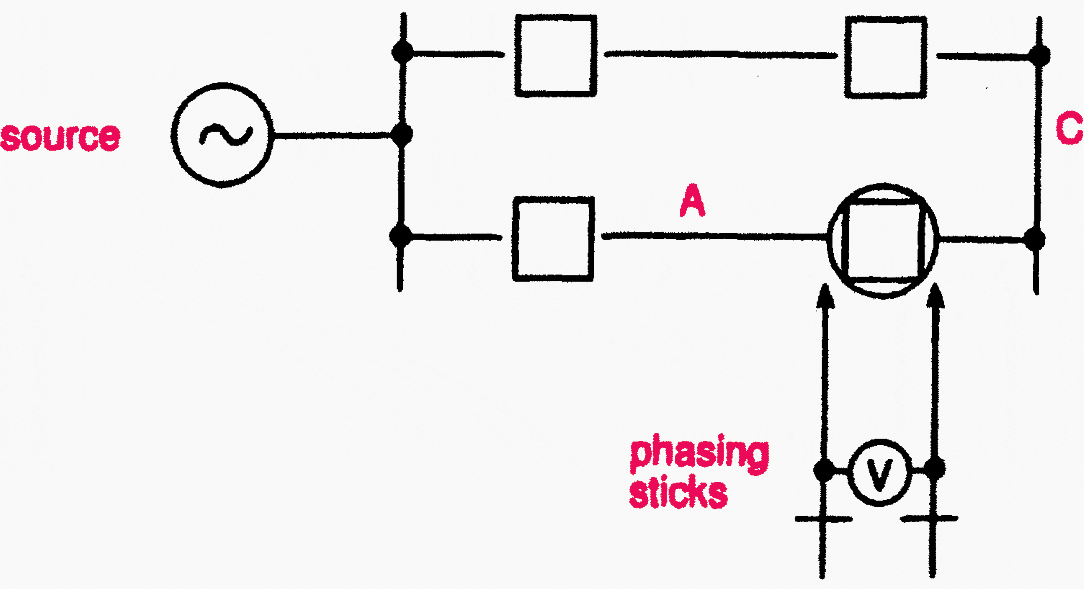

5. Phasing via phasing sticks
Figure 2 illustrates the case of a new 11 kV distribution circuit A which is to be commissioned onto the busbars at C. Before the remote-end circuit breaker associated with A can be closed, a phasing-check test is required. This can be accomplished with the use of phasing sticks.
These consist of two long insulated probes connected at the base by a conducting bond and fitted with an indicating voltmeter.
Figure 2 – Phasing out using phasing sticks
An operator wearing insulated gloves holds the two sticks, and inserts one up each of the busbar and feeder spouts, respectively, of metal-clad circuit breakers, or across the feeder and busbar connections of open-terminal circuit breakers. Each phase is tested against the other phase. In-phase connections should result in zero volts on the voltmeter, while across-phase connections should indicate 11 kV.
Phasing sticks are generally available for voltages up to 36 kV. Note that they should be proved before and after use using a proving device.

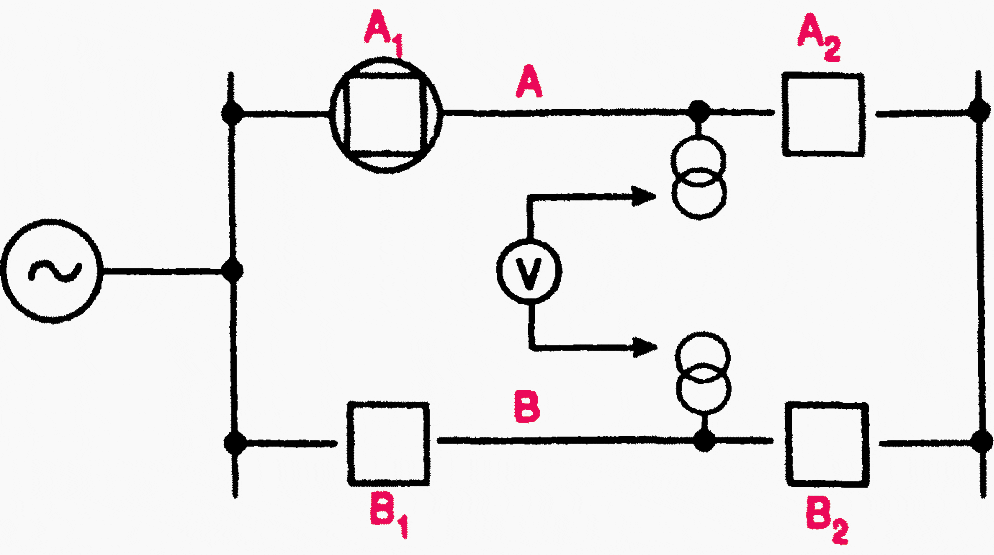

6. Phasing via voltage transformers (VTs)
With higher-voltage systems, it is necessary to carry out the phasing test with the use of voltage transformers. This consists of a two-stage process: first to prove the voltage transformer connected to the circuit whose phasing is to be proved, by phasing out against a supply whose phasing is already verified; and secondly to phase out to prove the phasing of the circuit under consideration.
Figure 3 – Phasing test via voltage transformers (VTs)
Figure 3 gives an example for the instance of circuit A requiring to be commissioned:
Step #1 – Starting conditions are with circuit breakers A1 and A2 both open, and an existing circuit B energized and in service.
Step #2 – Circuit breaker A2 should be closed, thus energizing feeder A from feeder B.
Step #3 – Phasing tests should be carried out between the VTs on feeders A and B:
  1. Voltage magnitudes should be verified by measuring the voltage to earth (63.5 V) and between phases (110 V) at each VT box in turn.
  2. Voltage phase rotation should be verified by applying a phase-rotation meter to each VT box in turn.
  3. An insulated wire should then be run between the two VT boxes,
  4. At one end, a voltmeter should be connected between the wire and VT terminals in turn (preferably the VT connected to the in-service circuit to minimise the risk of causing a short circuit on that VT), and at the other end, the wire should be touched onto each VT terminal in turn. For correct phasing, the results matrix shown in Table 1 should then be obtained.
Table 1 – Phasing-test results
VT A
RYBN
VT BR011011063.5
Y110011063.5
B110110063.5
N63.563.563.50
The purpose of this test is to verify the voltage transformer connected to feeder A, by phasing against a known and proven source of supply (feeder B and the VT connected to B), prior to proving the phasing of the conductors connected to feeder A.
Step #4 – Circuit breaker A2 should now be opened and circuit breaker A1 closed. Phasing tests between the VTs on feeders A and B should then be carried out again, as described in Step #3 above. This test proves the phasing of feeder A’s conductors.
Circuit breaker A2 is now in a position to be closed.
