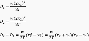

4. Transmission line based on different levels
Consider “O” the imaginary lowest point of the transmission line.
x1 =  is the horizontal distance between the lowest support point and the “O”.
x2 = is the horizontal distance between the highest support point and the “O”.
D1 = is the imaginary arrow from the lowest support point.
D2 = is the imaginary arrow from the highest support point.
With these data, we have:
We observe that:
Horizontal distance between the support points; Height difference between the support points
From the above, we have:
With the values of x1, x2, the arrows D1, D2 can be calculated, as well as the height of any point on the transmission line from the ground.

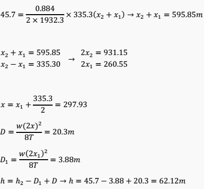

Example //
An overhead transmission line crosses a river and it is based on the two banks by two towers at height h1=91.4m and h2=45.7m above the water surface. The horizontal distance between the towers is 335.3 m. The maximum tensile force is T = 1932.3 Kp and the weight of the conductor is w = 0.884Kp/m.
Determine the height “h” of the line over the water, midway between the two towers.
Consider “O” the imaginary lowest point of the transmission line and D1, D2 the arrows from the lower and the tallest tower respectively.
D1, D2 - the arrows
However:
D1, D2 arrows
Therefore:
h (height) formulae
