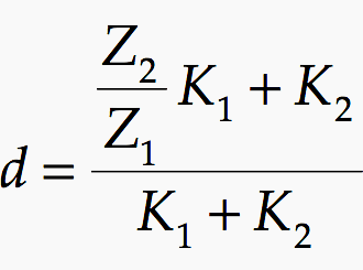

If the percent impedances of the transformers are unequal, the load will not split in the same proportion between the two units. Note that this is the percent impedance, not the impedance in ohms. The unit with the lower percent impedance takes more of the current relative to its rating.
For unequal impedances, the total bank must be derated (as stated by ABB, 1995) as:
where:
  • K1 = Capacity of the unit or bank with the larger percent impedance
  • K2 = Capacity of the unit or bank with the smaller percent impedance
  • Z1 = Percent impedance of unit or bank 1
  • Z2 = Percent impedance of unit or bank 2
