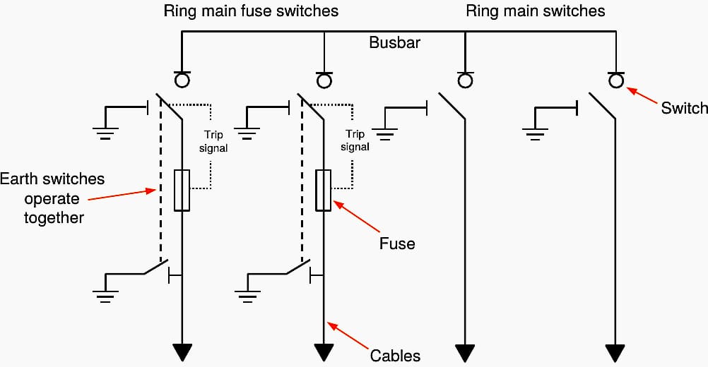

The ring main units consist of the required number of switches and fuse switches to match their application in the network. Figure 3 shows a ring main unit with two switches and two fuse switches. This arrangement is commonly referred to as a 2+2 unit.
Figure 3 – Schneider RM6 two ring main switch and two switch fuse

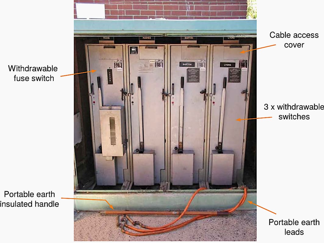

Withdrawable and non-withdrawable switches and fuse switches can also be provided. In non-withdrawable units, the switch and fuse switch cannot be withdrawn, disconnecting them from the busbar and cable circuits. Non-withdrawable units are most commonly used.
Figure 7 depicts the principle of withdrawable ring main units with a withdrawable truck unit for both a ring main switch and a switch fuse. The figure shows the truck C may be moved in or out of the housing D. When the ring main switch is inserted into its correct position, it plugs into the HV cable spouts A and the busbar spouts B.
When physically withdrawn the switch separates from the busbar and cable connections as shown for the ring main switch in the right image of Figure 7.
In its correctly plugged-in position, the interlock of the ring main switch may be set to the ‘service’ position. The switch can then be operated to ‘on’ or ‘off’, as required, usually by means of a spring charged device. The interlock prevents the switch from being withdrawn while it is in the ‘on’ position. It also prevents the switch being racked in if the truck is in the ‘on’ position.
The withdrawable switch fuse is constructed and operated in the same way as a ring main switch but contains three fuses (see Figure 5-9 left). It must be switched ‘off’ and racked out into the withdrawn position out before the fuses can be replaced.
Note the ring main fuse switch on the left is also a withdrawable unit.
Figure 7 – Ring main switch in the service and withdrawn positions

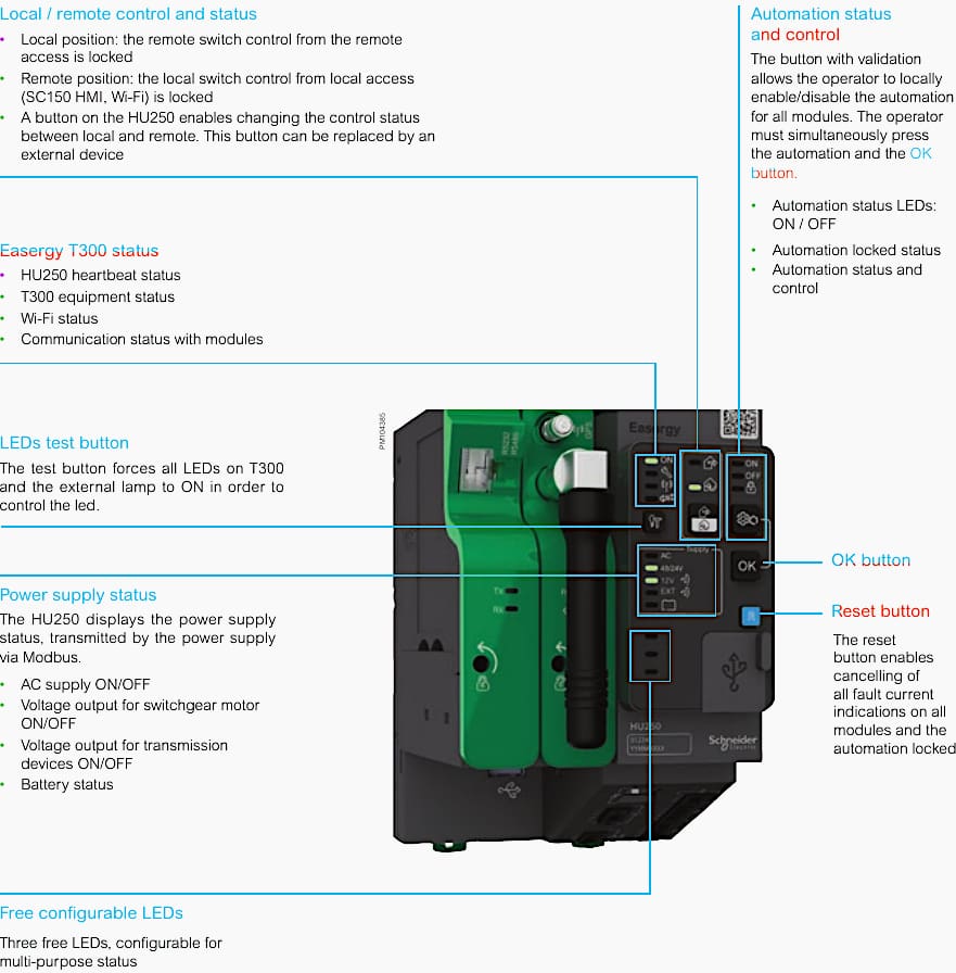

A single T300 Remote Control Unit is designed to allow remote operation (close, open) of the switches it controls at a particular location. To inhibit remote operation of the RTU and the associated switches it controls, a selection to “local control” must be made on the unit.
Figure 10 T300 Remote Terminal Unit
Figure 10 – T300 Remote Terminal Unit
When the unit is selected to “local control”, a LED is illuminated to indicate this.

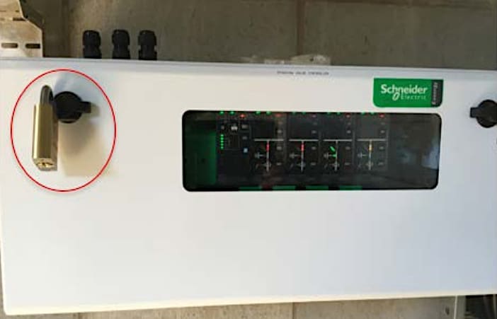

The T300 remote terminal unit is housed in a weather proof lockable enclosure. To prevent the T300 unit from being accessed and inadvertently selected to “remote control” after being selected to “local control”, it must be locked.
Figure 11 – T300 Locked Enclosure
Remote terminal unit T300 in locked enclosure
Figure 11 – Remote terminal unit T300 in locked enclosure

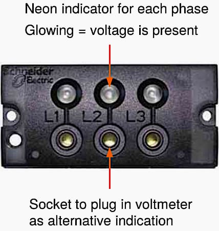

6. Voltage Indicators (Neon Indicators)
Voltage indicators are provided on the ring main unit front panel to show the electrical status of the associated cable. Earth switches must not be closed unless the indicators on each phase show the cable is de-energised. An example of voltage indicators is shown in Figure 12 below.
The markings L1, L2 and L3 represent the R, W and B phases respectively. The neon indicators glow to show the presence of voltage on each phase of the cable.
It is good switching practice to observe the three voltage indicators are operational prior to de-energising a circuit. As an alternative method of proving de-energised, three sockets are often provided near the indicators to allow the use of a voltmeter.
Some ring main units have removable voltage indicators. This facilitates proving the indicators are working on live circuits before and after switching to de-energise a cable.
Warning Note! Before applying an earth, the switching operator must use an approved testing method to positively prove the circuit is de-energised.
Figure 12 – Voltage presence indicating neon lights as fitted to a RM6 ring main unit

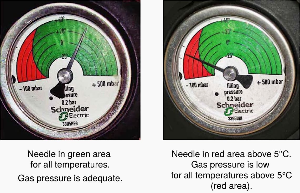

7. SF6 Gas Pressure Indicator
SF6 ring main units require adequate gas pressure at the operating temperature to achieve the rated switching current. An energised switch MUST NOT be operated with low gas pressure. The switching operator must check the gas gauge to ensure adequate pressure before operating a switch.
An example of a gas pressure gauge is shown in Figure 13. The gas pressure is indicated by the black needle. As pressure varies with temperature, the gauge has a number of concentric circles indicating temperature between the range of –25°C to +40°C. The green and red areas are used to show adequate or low gas pressure respectively.
One method of reading the gauge is to look if the needle crosses anywhere into the red area. If so, the temperature of where the needle crosses from the green into the red area is estimated using the concentric temperature circles. If the actual switchgear temperature (usually ambient temperature) is above this temperature read from the gauge then the gas pressure is low and switching is not to proceed.
For example, in Figure 13 the left-hand image shows the needle in the green area over the entire temperature range; therefore the gas pressure is adequate.
The right-hand image shows the needle crossing into the red area at an estimate 5°C from the concentric circles. This is interpreted as the gas pressure is low if the actual temperature of the switchgear (usually ambient temperature) is above 5°C (that is, a temperature in the red area).
Therefore if the actual temperature of the switchgear at the time of switching is above 5°C this switchgear must not be operated.
Figure 13 – Gas level gauge on RM6 ring main unit
Warning Note! Where RMUs are fitted with a gas pressure indicator, this indicator must be checked to ensure the gas pressure is adequate for the switch to be operated. Switching must not proceed if the gas pressure is outside acceptable limits.
8. Earthing of Circuits Connected to Withdrawable Ring Main Units’ Switchgear
Withdrawable ring main units are not fitted with an integral earthing switch. Earthing of the cable circuits must be done manually. Earths must be applied as soon as possible after testing. If a circuit is proved to be de-energised, but earths cannot be applied at the time, the switching operator must prove the circuit is de-energised again, just before applying the earths.
An example of an old withdrawable ring main unit is the ABB unit (shown in Figure 14). Proving de-energised and earthing is performed through the cable access cover. The portable earths are applied with the insulated earthing handle.
Because of interlocking arrangements this earthing access cover can only be opened when the switch/fuse switch is in the withdrawn position.
Warning Note! Before applying an earth, the switching operator must use an approved HV testing device to positively prove the circuit is de-energised.
Figure 14 – An old ABB’s withdrawable ring main unit
An old ABB's withdrawable ring main unit
Figure 5-16 – An old ABB’s withdrawable ring main unit
