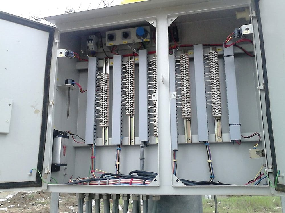

1.2 Instrument Transformer Circuits
In most cases, instrument transformers are not duplicated, but rather equipped with different cores to accommodate the two sub-systems. Various cores are interconnected with redundant protective methods. It is advisable to refrain from using a single current transformer core to supply power to both sub-systems. It is necessary to supply each Busbar protection with power from a separate CT core.
To mitigate the potential for open circuits at the terminating point or within the terminal itself, it is advisable to refrain from utilizing any current loop that supplies many panels. This precaution is particularly crucial when the loop is equipped with a disconnectable connection. Typically, both subsystems are linked to the identical CT junction box.
Therefore, it is typically not feasible to achieve physical isolation within distinct CT junction boxes. Nevertheless, it is necessary to transmit distinct cores of the CT using separate wires.
It is customary to have distinct secondary windings for the two sub-systems in voltage transformer circuits. In certain instances where two windings are unavailable, such as at lower voltage levels, it is advisable to employ distinct fuse groups within the marshalling box to divide the circuits. The high availability of voltage transformers renders this option generally acceptable.
Figure 3 – Dedicated current transformer wiring panel in air insulated substation

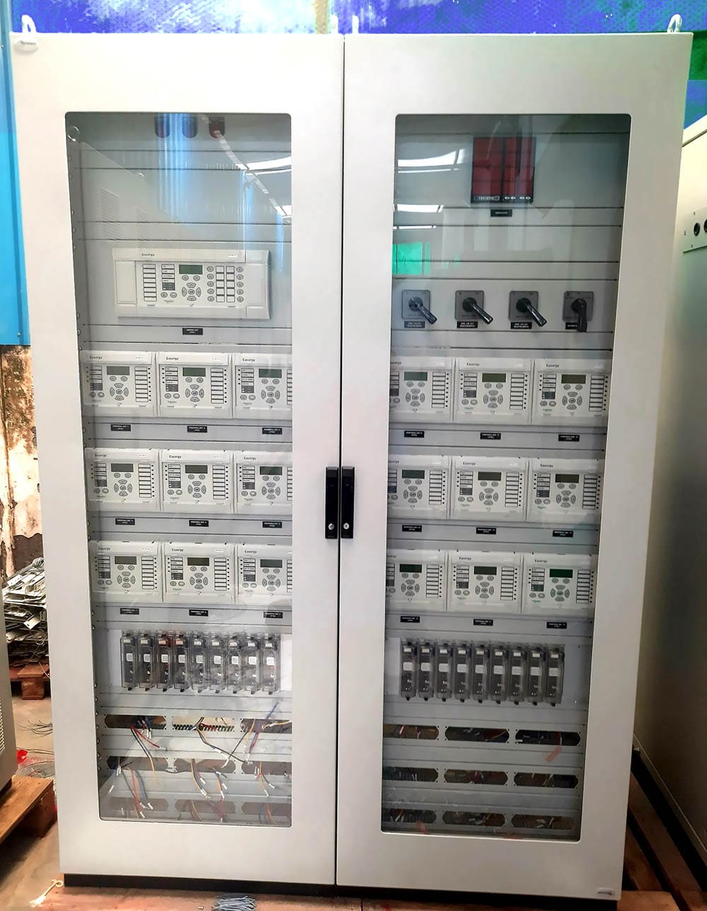

1.3 Physical Location of Panels
The physical placement of the protection relays and auxiliary relays in the panels is crucial when utilizing sub-divided systems. It is recommended to employ distinct panels for the protection equipment of group A and group B. The rationale behind implementing physical split-up is to mitigate any issues that may arise from a singular incident, such as a cable fire or mechanical damage in a panel, affecting both sets of protective measures.
Additionally, it facilitates the ability to work on one group while the other group is engaged in service.
Nevertheless, in certain instances where the sub-systems occupy little space, it is deemed permissible to house the equipment for both sub-systems within a single panel. There is a little likelihood of cable fire or any other mechanical damage that may impact the two systems within the same panel. The issue of circuit mix-up resulting from errors during the processes of erection, commissioning, or maintenance necessitates careful consideration and the implementation of preventive measures.
Based on what has already been said, it may be concluded that a crucial aspect of panel design involves the explicit indication of the object to which it pertains. When employing sub-divided systems, it is imperative to explicitly specify the sub-system to which it belongs. This encompasses the implementation of distinct equipment segregation and explicit labeling of various portions, as well as the segregation of components between sub-systems or objects. The process of separation within the panel involves the physical segregation of terminal groups to accommodate the various protected devices within the panel.
Any equipment employed in the protective system, as well as additional supplementary relays linked to the identical battery system or fuse groups, must be consolidated and unambiguously designated. The equipment responsible for closing, interlocking, and other related functions is situated within the protection panel.
Figure 4 – Relay protection panel

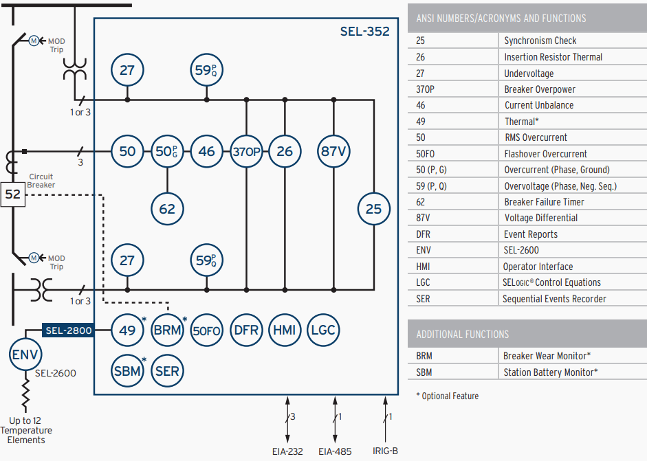

1.4.2 Start of Breaker Failure Protection
The Breaker failure relay/function (BFR) isn’t duplicated in redundant systems, just like the Auto-recloser function. However, the rationale behind this is entirely different. The Breaker failure function necessitates stringent security measures to prevent unnecessary trippings and duplication, resulting in enhanced dependability but a deterioration in security.
Given the statistically low risk of breaker failure, prioritizing security is of greater significance.
The provision of the BFR function is limited to a single system, often within the Group A protection system. It is now usual practice to provide DC changeover to the BFR relay when using a single BFR, as this enhances reliability and availability. When the breaker failure function is repeated, such as when duplicate busbar protection is employed, it is important to acknowledge the associated security issues.
The transmission of data between the systems must be managed with meticulous attention to avoid issues, such as when maintenance is performed on one of the systems. Interface relays should be positioned either internally or externally, ideally in a distinct and clearly marked section within one of the panels only.
In order to facilitate the identification and disconnection of the appropriate terminals during the separation of sub-systems, it is imperative that the terminals are prominently displayed within the panel.
Figure 5 – Functional diagram of a Breaker Failure Relay
