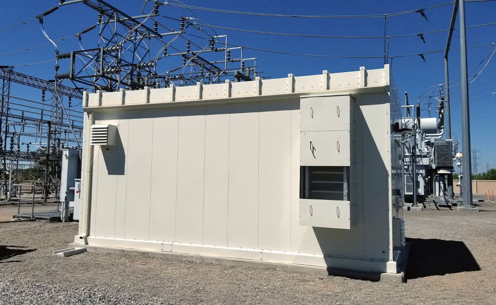

In a substation, the secondary equipment provides the functional interface for the control, supervision, and protection of the network. The equipment is organized into substation level or bay level depending on whether it operates on an overall substation basis or only for a single bay.
The secondary equipment can be located in different buildings or in separate rooms within a central building or in some cases, mounted directly adjacent to the switchgear.
The normal practice is to use a central area for metal-enclosed substations and open-air sub-transmission substations.
For high-voltage open-air substations and for high-security, metal-clad substations, the usual practice is to provide dispersed relay kiosks/rooms for bay-level equipment and a centralized control building for substation-level equipment.
Figure 1 – Relay kiosks for bay-level equipment
Figure 1 – Relay kiosks for bay-level equipment (photo credit: Crown Technical Systems)
